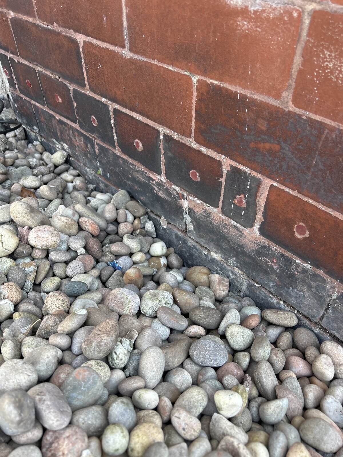

Hi,

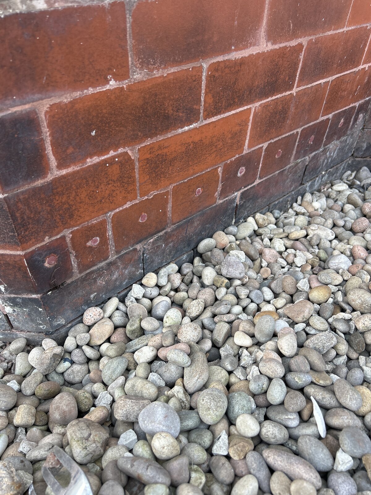

Having issues with condensation and damp in my terraced bay window - not uncommon I know.
The previous owner had decorative stones out the front which were very close up to the DPC. Pictures attached.
I’ve stated to remove these - they had the original air brick covered too - and I was wondering if anyone could advice if this was a likely contributing factor?
We’re also getting a dehumidifier for the colder months which is when I’ve noticed serious levels of condensation on the wall inside.
The stones were right up to the top of the brick below the DPC.
I’m looking to get it down to a minimum of 150mm but should I go lower?
Yes, because the relative humidity inside the house would be higher.
You could do an initial removal, then see what happens, then remove more if necessary.
In a house with a suspended ground floor, ALL air bricks must be allowed a free flow of air at all times. Lowering the surround ground to 6" below DPC will be sufficient.

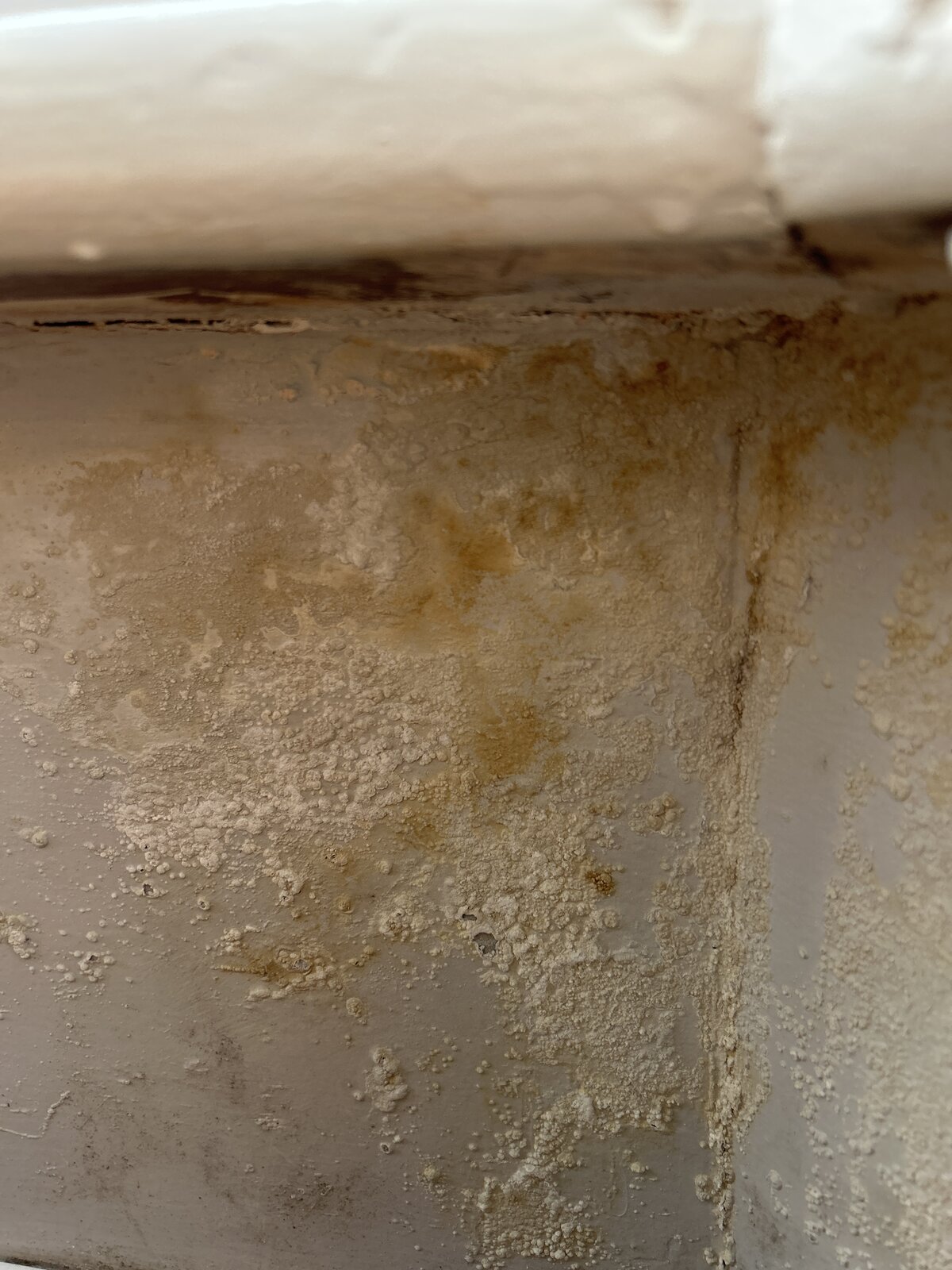

Some images of under the bay internal. Just in case there is anything else you might think I need to do.

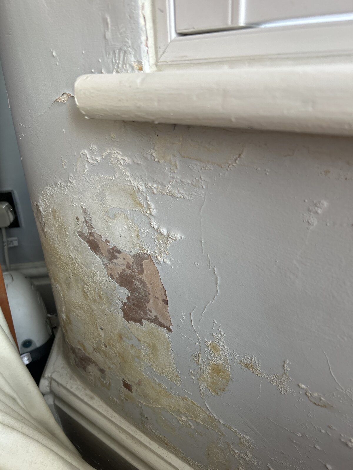

Is that inside wall damp to the touch where all the damage is?
Nope! Not at all.
However, I’ve noticed sometimes in the winter it can be soaking wet. We do try to have the windows open/on the security latch we often as possible but when it’s get really cold it’s difficult

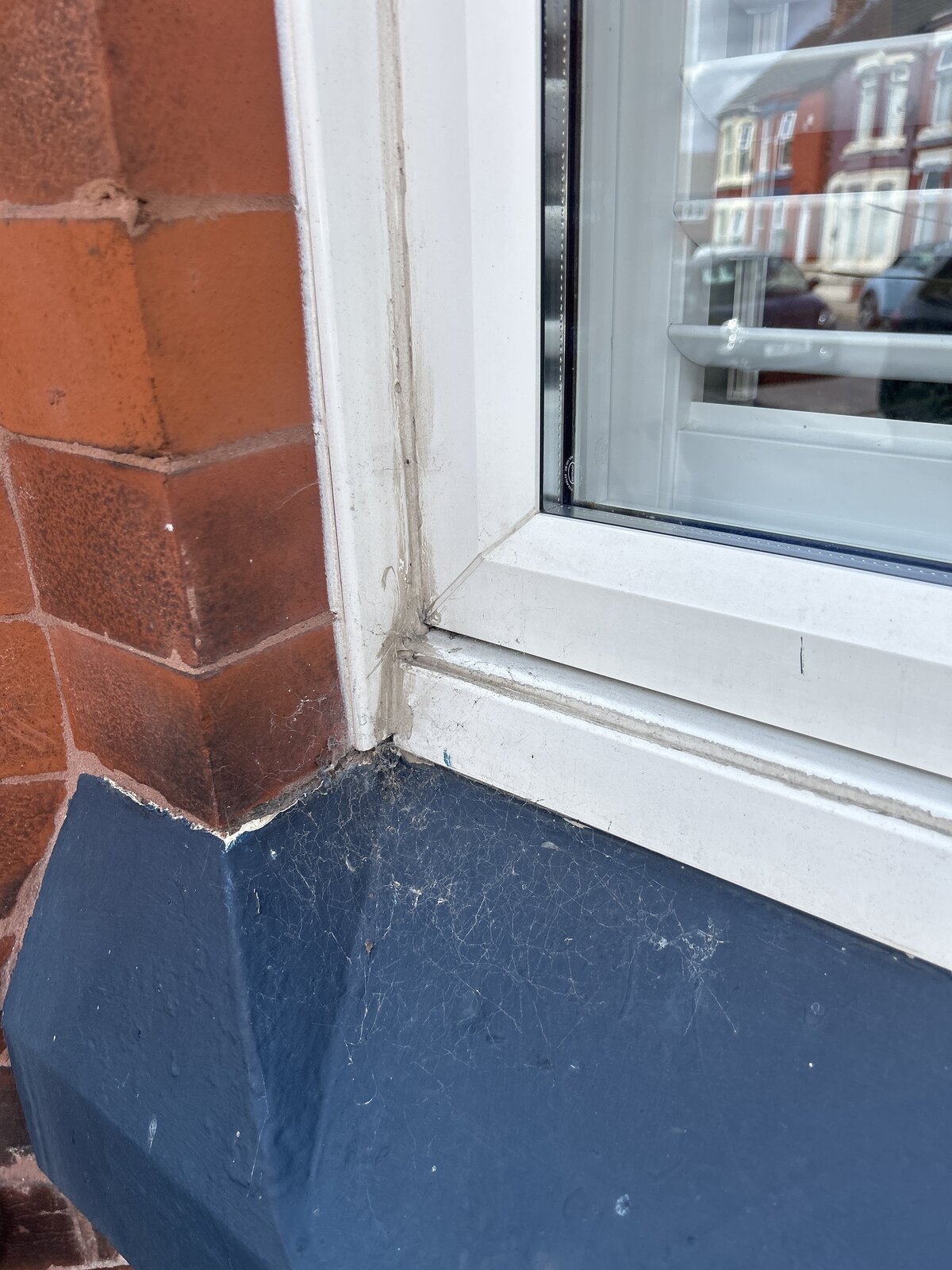

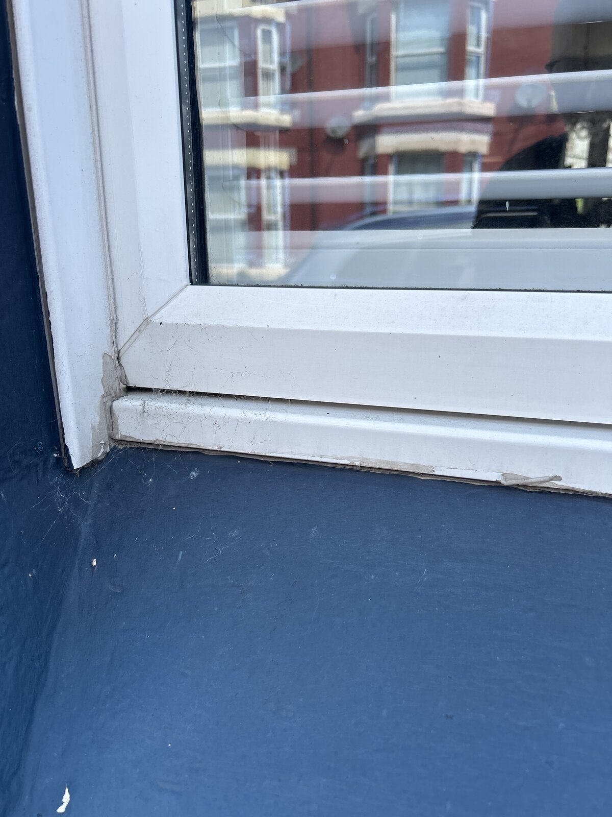

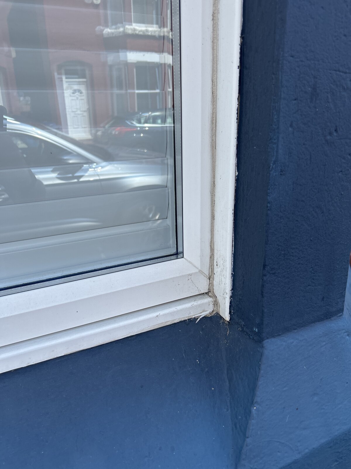

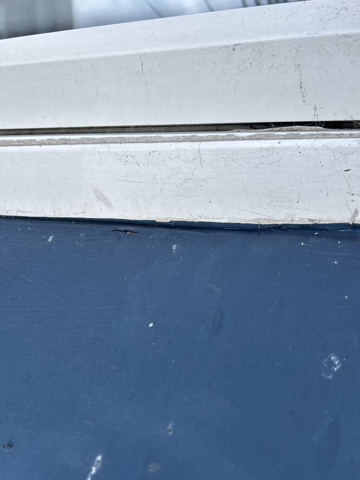

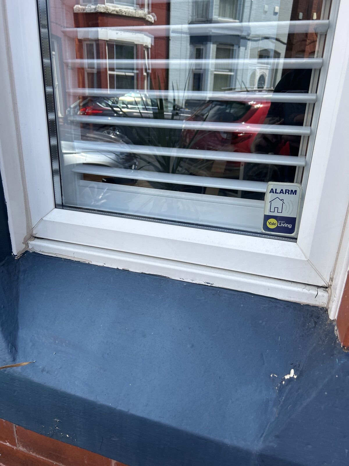

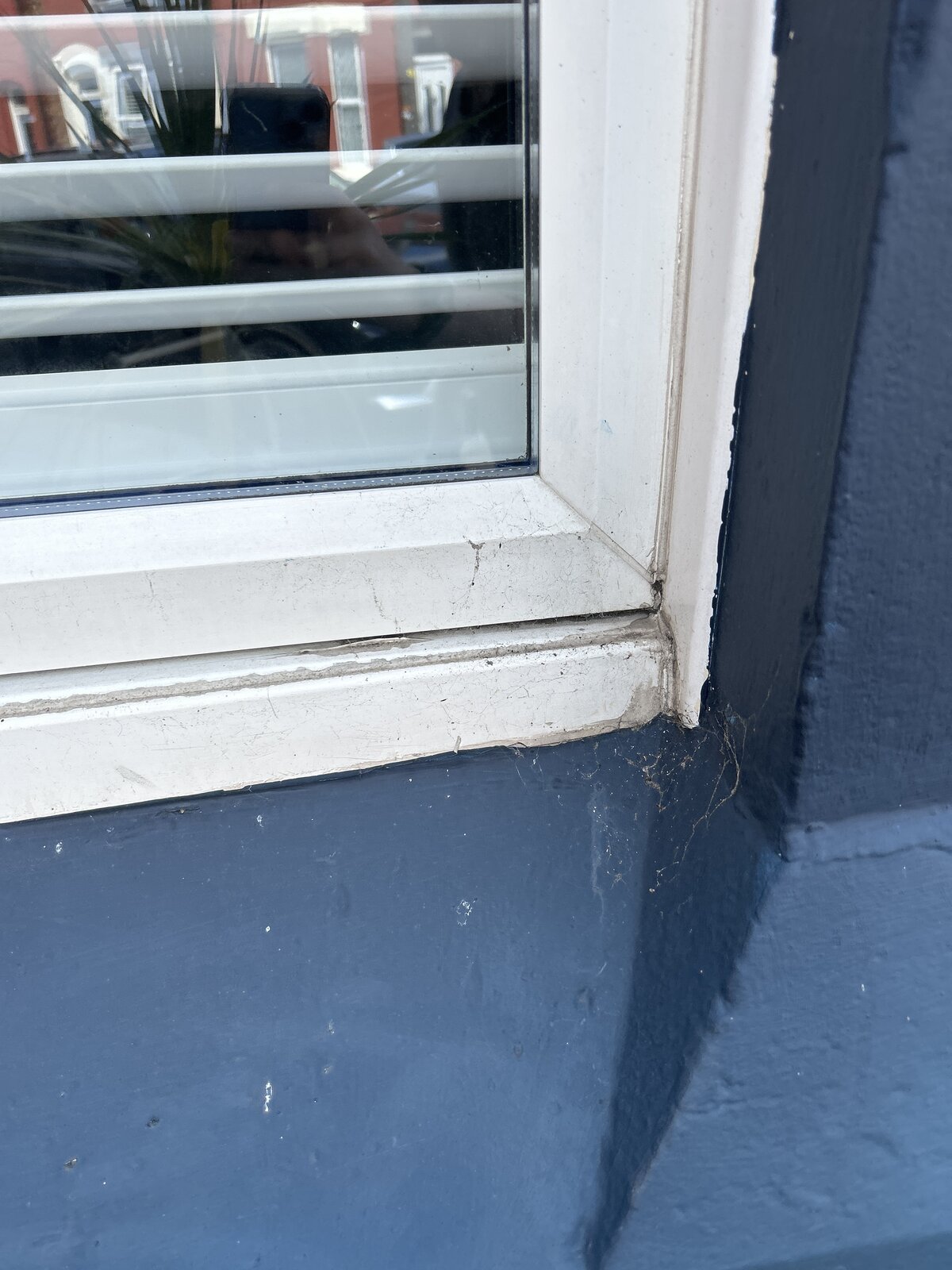

That looks like it might be water ingress from the outside of the windows.
Can you take a series of photos of the windows (from the outside).

An easy test is to tape some bacofoil to the wall at those points. Leave it for a few days. If it is condensation the moisture will be on the side facing into the room, if it is water ingress, the other side will be damp.
Those round dots in the exterior faces of the brick suggest that someone has drilled and injected a liquid DPM.
Thanks, from those images I cannot see any obvious flaws.
I would still recommend the bacofoil test though.
Best of luck.

Having zoomed in on my laptop... it looks like the silicone may have failed on the underside of the uPVC. Try to see if you can push in a thin filling knife at any point.
That said, I don't know if that is the root cause.
