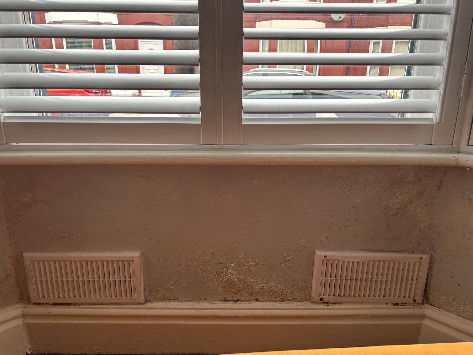

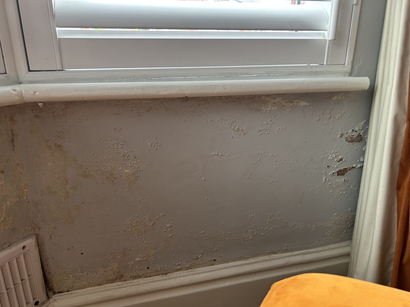

The condensation tends to appear in the winter months during the evening. Especially when we have a busy house - for example Christmas Day. I originally thought it was the rain but tbh, I’ve noticed it when it hasn’t rained. I’ll keep a diary this winter to be sure.
You probably have rising damp in the bay window wall, and this makes the inside surface of the wall cold. Then you also are likely to have inadequate ventilation in your front room. So, moisture laden air is condensing against the cold surface.
Your damp proof course in the bay window is probably inadequate.
Thanks. Will take look. Appreciate your advice.

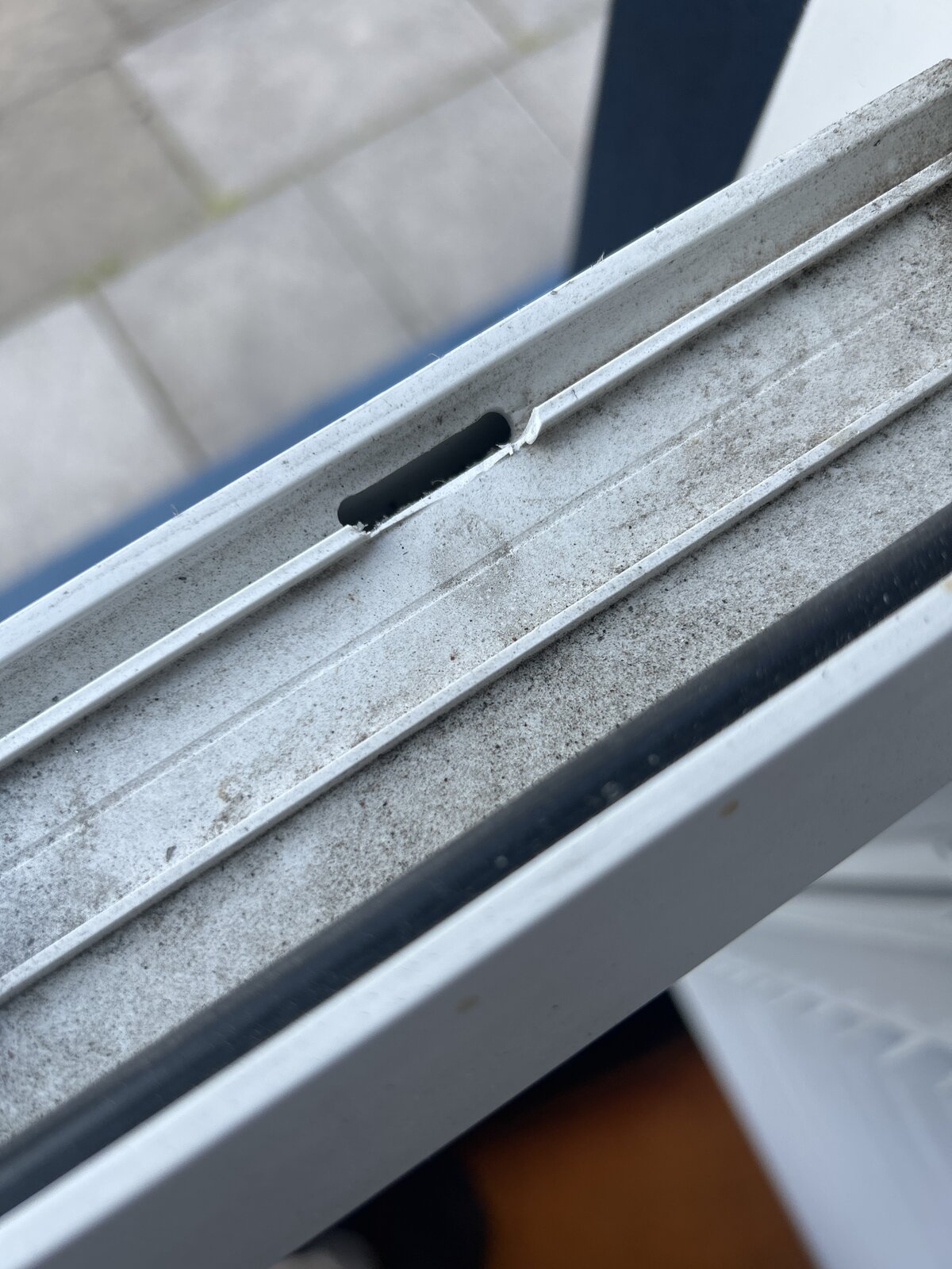

Also open the windows and make sure that the weep holes in the bottom channels are not blocked.
I have personal experience of blocked drainage vents leading to hefty stains on ceilings.
Are these the weep holes? Should they also be on the outside? There doesn’t appear to be anything on the outside of the window

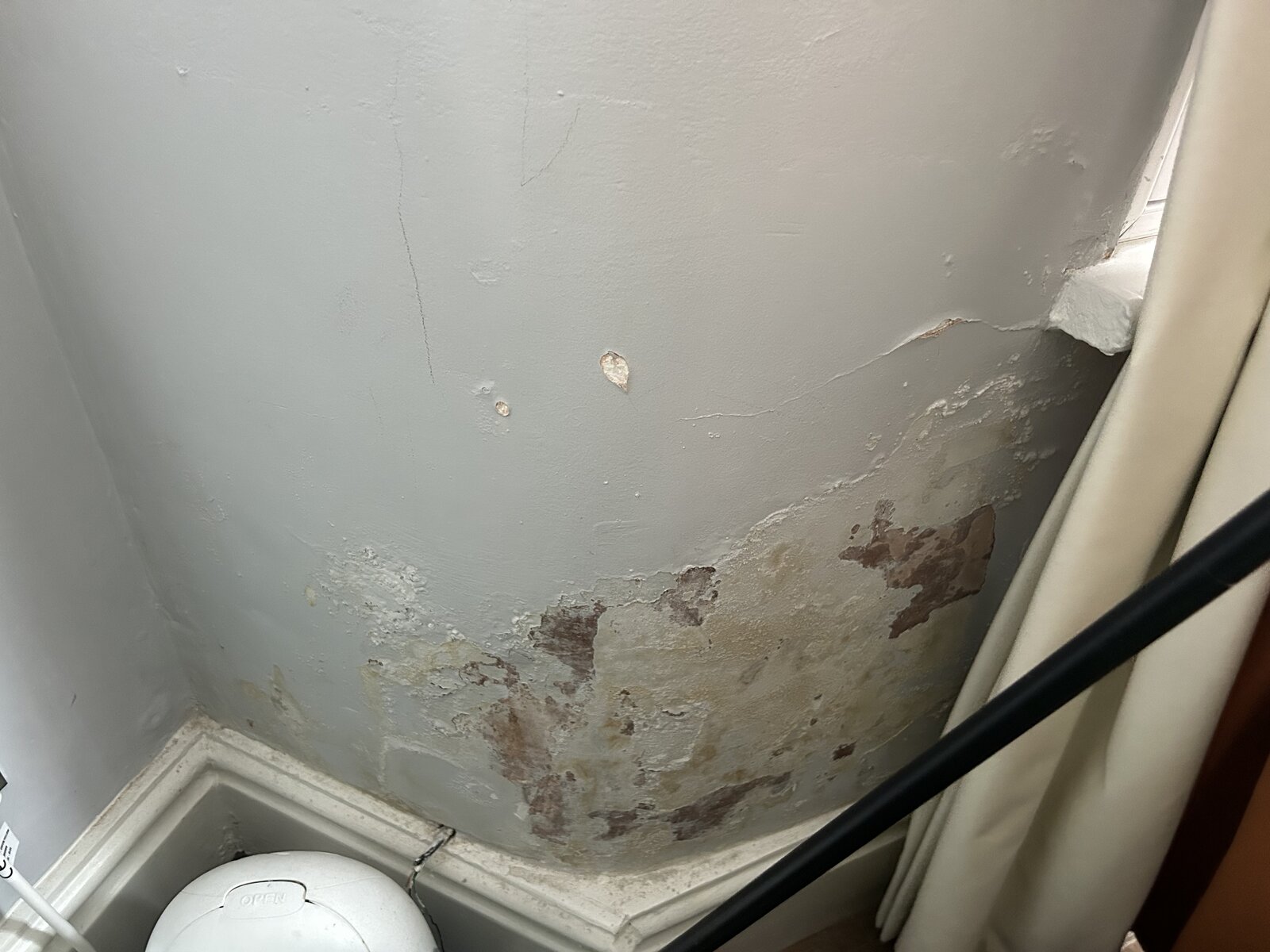

OP,
1. The drilled & plugged DPC line seems to be working - however, headers only have been drilled, suggesting that the wall might be solid? Is it a solid wall? Why not measure the wall?
2. No airbricks can be seen - why not stand back & photo the whole of the bay and the walls on either side of the bay. ie the front elevation at low level.
3. Lower the pebbles below any air bricks.
4. Do you have a suspended floor? Ventilation from front to rear of the house is necessary under suspended floors.
5. The interior pics of damp defects show what appears to be mostly penetrating damp.
6. However, there are indications that previous work was done at low level which could imply rising damp?
7. A metal corner bead is rusting, & there could be rot under the window board. The skirting is a badly done re-fix - what condition is the floor in?
8. Why not pic the interior of the bay, and the rest of the wall?
9. The pics in post #9 show very poor attempts at using silicone. All the silicone needs re-doing, maybe the stuck-on trim also needs re-doing or replacing?
10. Opening & locking testing the frame - & cleaning out the tracks & weep holes is needed.
11. Close up inspection by a window guy, and sprinkled water testing would help.

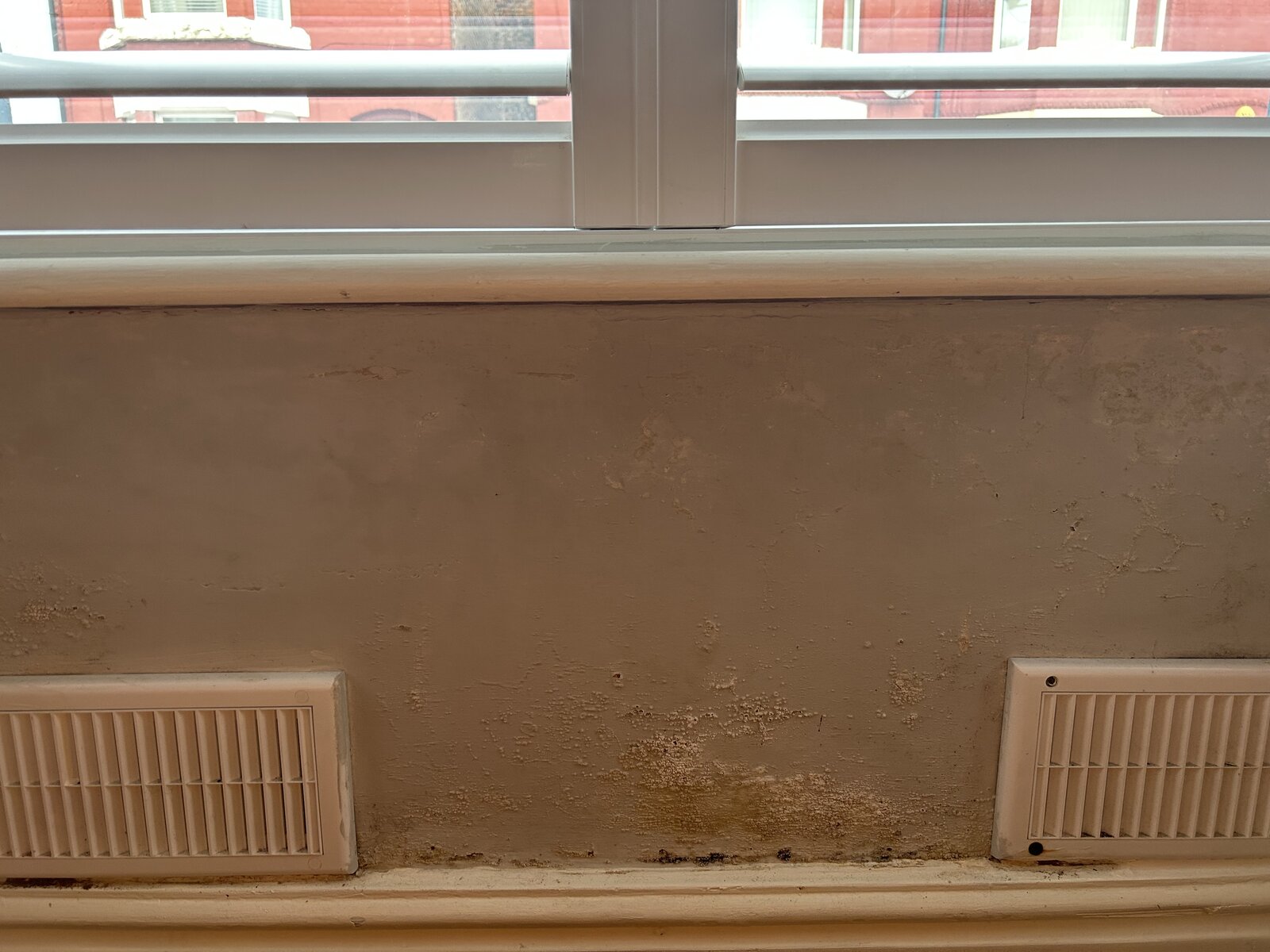

Poster #25,
Why do you think the DPC line was installed in the first place?
Those images are indicative of penetrating damp, not condensation damp (although that might be resultant) and it's concentration is too high for rising damp.
The stone cills would imply that the cause is penetration from around the frame, not the wall itself.
Check the frame perimeter and sealant - even at the top and the wall above, and drainage holes at the bottom.
Lack of a cill makes the bottom seal or detail suspect too.
Good grief! Whoever gunned that sealant in must have suffered with the shakes. Most of that needs removing, thoroughly cleaning up, and then re-gunning with a decent sealant. I don't like the way they have finished the outside off without a sill fitted. I'd like to know what was behind that piece of trim that has been used instead of a sill.
Thanks for this. I’m going to try and get some pics during the week when I’ve got an empty house.
You’re taking to a complete novice here. So when you talk about checking the frame and also the trim being used instead of a sill is that exterior?
Is resealing the windows a job I could practically take on myself? I’ve used sealant before internally.
