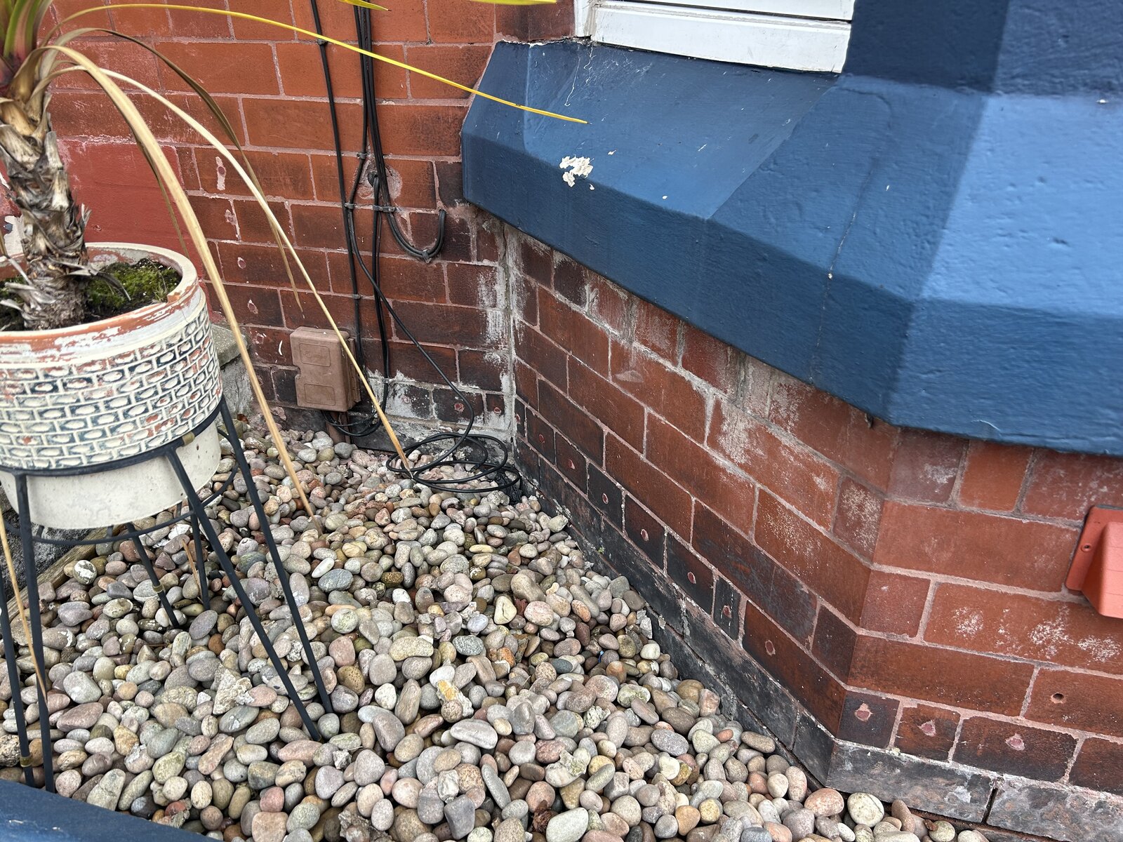

1. The drilled & plugged DPC line seems to be working - however, headers only have been drilled, suggesting that the wall might be solid? Is it a solid wall? Why not measure the wall? - it’s a sold brick wall right through to the inside where it’s then plastered? Is that what you mean? Think it’s single brick.

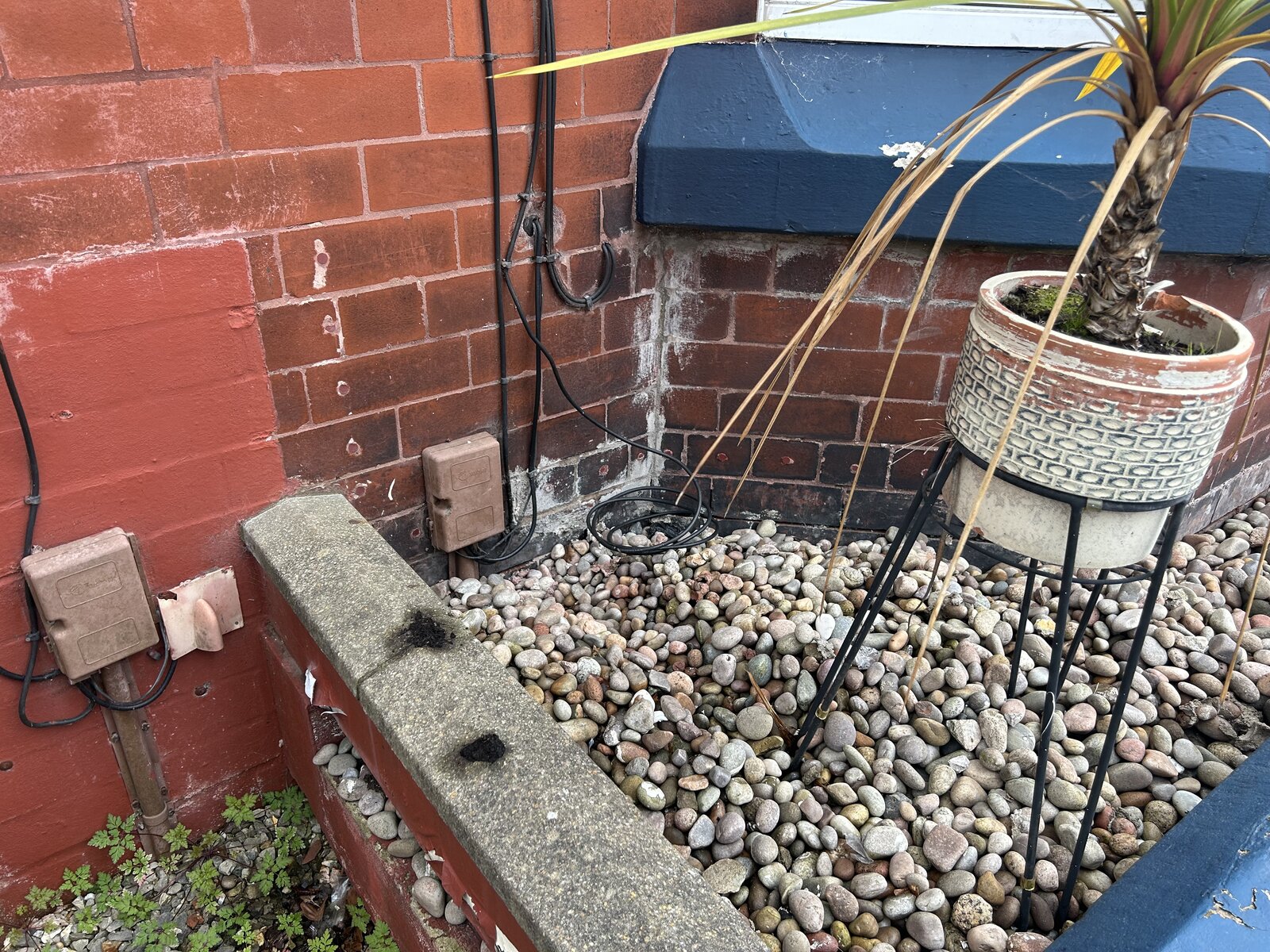

2. No airbricks can be seen - why not stand back & photo the whole of the bay and the walls on either side of the bay. ie the front elevation at low level. - will get another pic but there is a single air brick under the bay window below floor level. There are also two air bricks that have been installed above the floor level - although not sure they’re any good as I can’t feel any draft from them internally.
3. Lower the pebbles below any air bricks. - will do

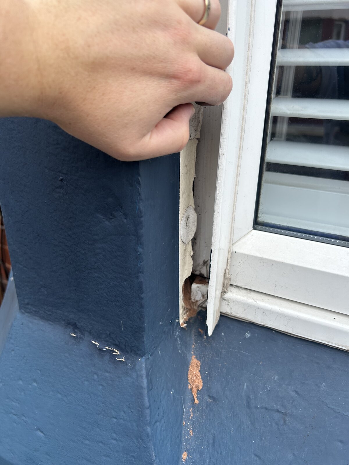

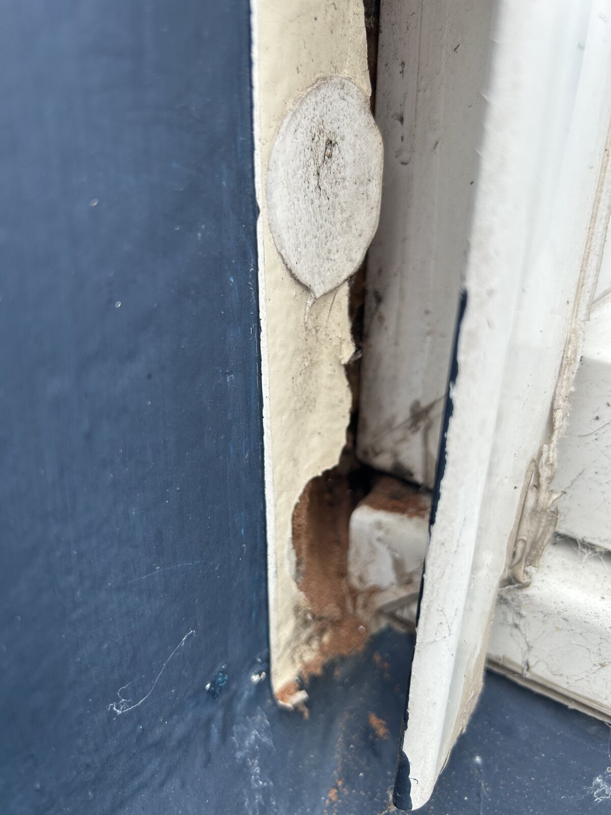

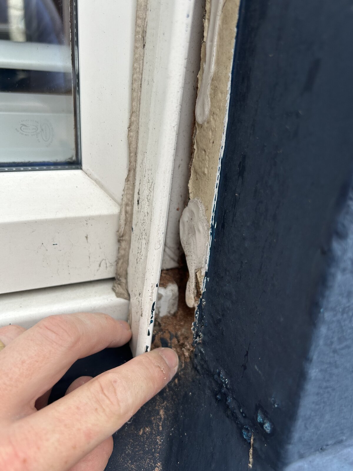

I’ve just had another look at the widows while taking these additional pics. Under the concrete bay, it is really damp and it rained this morning.
I also noticed these window trims where loose and when move it was just like sand coming out.

Well done. I think you may have found the source of the water ingress.
It looks like the water may be running off the lowest uPVC sill and into the brickwork at the edges.
Personally, I would remove all of the siliconed on trims, vacuum/brush out the cavities and then seal with expanding foam. Then, if possible, run a bead of silicone where the sill meets the wall. The refit the trims.
Just a note, that sandy material that came out didn’t feel damp. Could that indicate it’s not not the source?
Possibly, but I don't see anything wrong with treating it as a potential source. From the images, you only seem to have removed the trims from one side of the window. It may, or not be the case that water is running in via the opposite edge and then under the sill.
Oh and rather than silicone, if you use a MS polymer such as CT1, it will enable you to paint the blue parts again in the future. Silicone repels waterbased paints.

I've yet to see the full width's pics of the inside & outside of the bay elevation at low level?
I've yet to see an air brick below FFL?
The two air bricks at the front of the bay are useless & need removing.
Lacking through ventilation from front elevation to rear elevation then dry rot will eventually take hold.
The previous repair attempts in the bay floor area, the ongoing damp, & the lack of ventilation would suggest that the joist tails in the bay are at risk of rot.

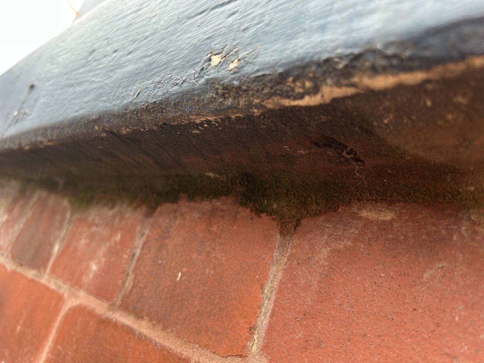

The concrete window sill lacks a drip channel - its necessary to grind one in.
The mortar bed below the sill needs hacking out as deep as possible & then renewing.
