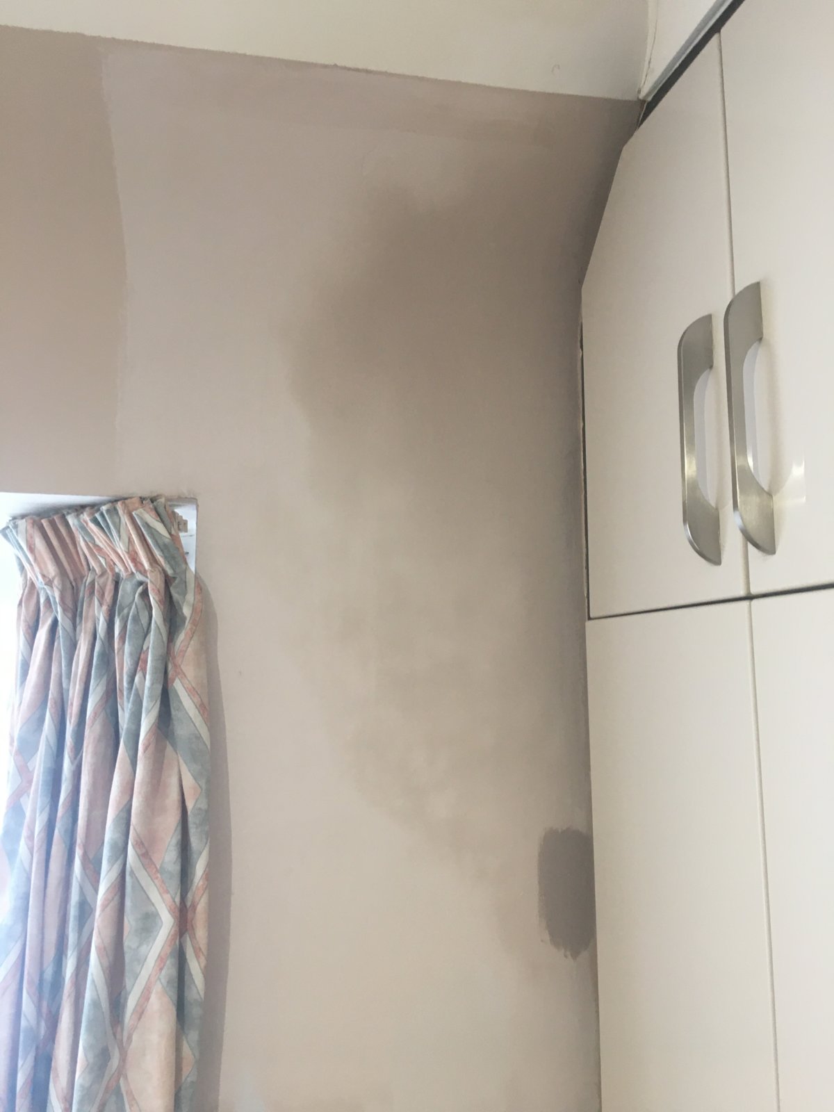

Hi everyone I recently had my flat roof fixed and got the roofer to look at my upstairs bedroom bay window flat felt roof, he looked and seemed to think this was defective and is causing damp in the bedroom wall and he said he couldn’t see any damaged tiles on roof, does this seem true I can understand what he means the house roof has no backing felt behind tiles any help advice would be great thank you

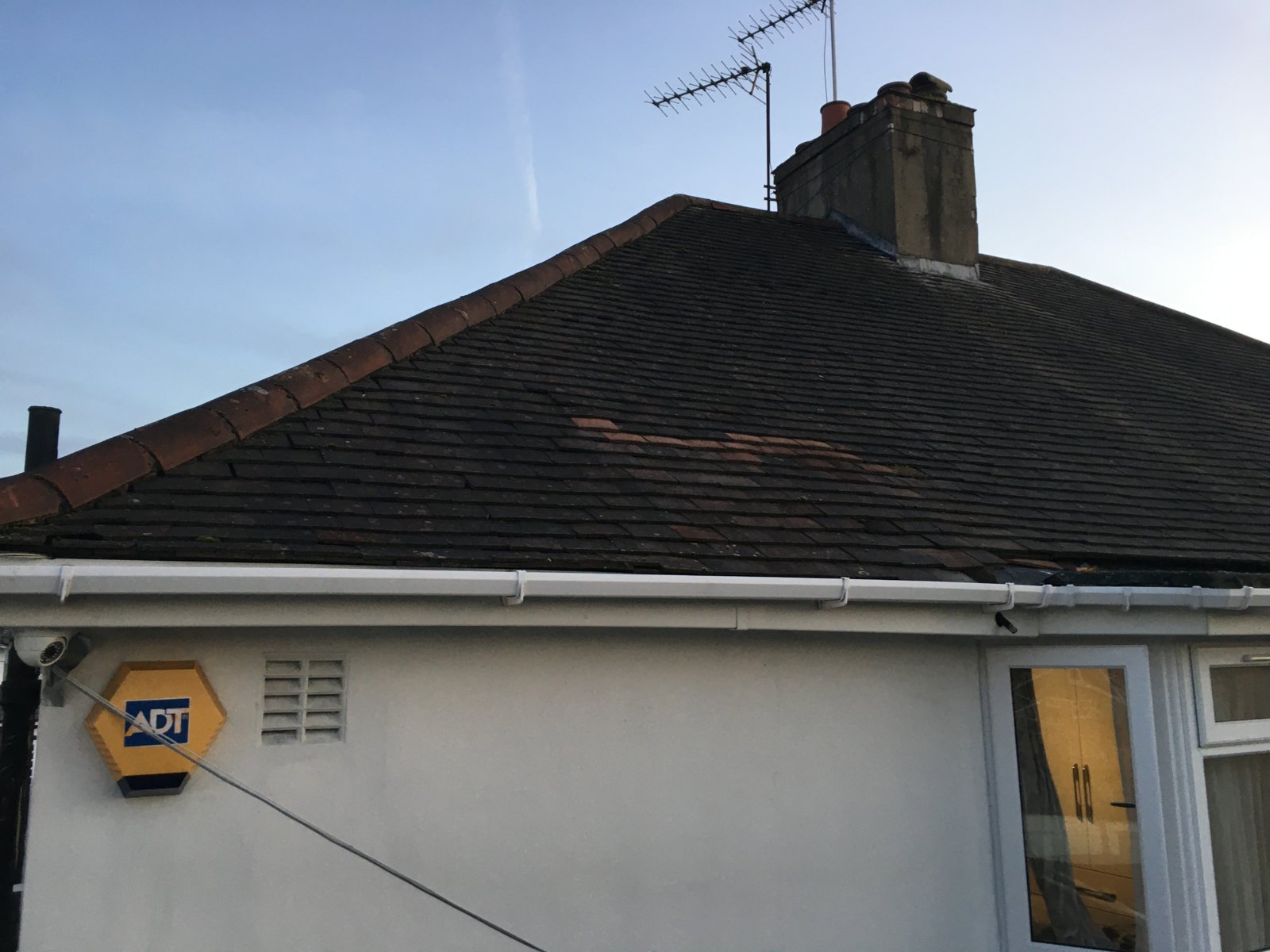

check the roof tiles have enough oversail into the gutter as you have new upvc fascias.
no underlay is not the end of the world...the bay roofs are well past it
poor eave tile bond above the bay .. your guy should have seen that

Do you think this roof is causing the damp problems in the bedroom as shown in the picture? Thanks
Going by the pics, yes! Tiles need sorted out at the eaves as well.

as above - both bay roofs are shot.
and both sets of guttering need stripping and re-fixing to adequate falls.
maybe the neighbour changes guttering or transitions to yours at a central running outlet?
the damp on the lower bay panel - when the bay roof is off (i presume the boards will also need replacing) check for moisture entering at that corner and running down to show below.
or, maybe thats plasterboard or plaster laths showing damp that you could open up, and then look for a cause in the lower bay?
