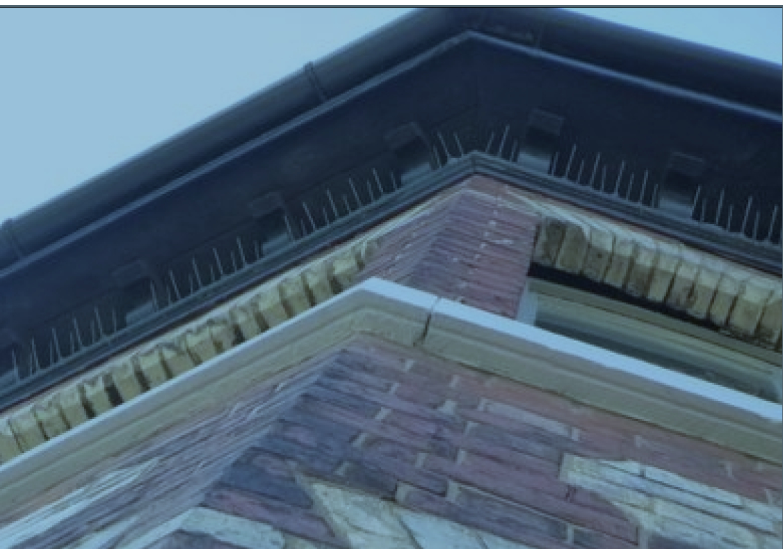

Hi all,
I'm after an approx cost of some work that was brought up in the survey on house I'm in the process of buying. One of the things picked up was that the bay window has fallen forward slightly (75mm top), which has also resulted in some gaps around the windows.
He's suggested fitting metal straps to the top of the columns and helical ties are used on the bricks.
It's a 2 story bay in a old Victorian house, built 1870.
Any ideas on how much this would cost?

No problem. The issue was caused by a slight roof spread pushing the top of the bay columns out slightly and it was suggested that action to be taken to prevent this getting any worse.
Taken from the quote:-
- install a Helifix crack stitching system.
- Rake out the every 3rd horizontal mortar bed to 30mm at the areas of the cracks and a minimum of
500mm each side of the cracks.
- Clean out debris from the raked beds with compressed air and treat with HeliPrimer.
- Install Helibond grout to the rear of the raked beds to requirements.
- Install 6mm stainless steel helical bars to be a minimum of 500mm each side of the cracks.
- Install second Helibond grout to finish 10~15mm below the brick face.
- Re-point the mortar beds and make good.
LATERAL RESTRAINT:
- To install "L" BAT straps type M305 at approximately 500mm centres fixed to the roof frame.
The only pic i have that shows it is from the survey, hopefully its uploaded ok.
The £625 is for this and some other more minor repointing.
This is just one of many jobs that need to be done on the house, this was an additional issue that was picked up on the survey and I had no idea on how much it would be.

Thing is, if the hipped roof of your substantial bay is spreading then its possible that the roof framing movement is down to movement or decay in the original timber Bressummer Beam.
You dont show pics of the brick movements/"cracks" or the 75mm gap thats opened up - so its difficult for me to comment further.
If there's no mortgage retention then perhaps, in your time, you can bring a building contractor on site to do remedial repairs after a thorough investigation?
Its curious that no mention is made of interior cracks or signs of damp?
