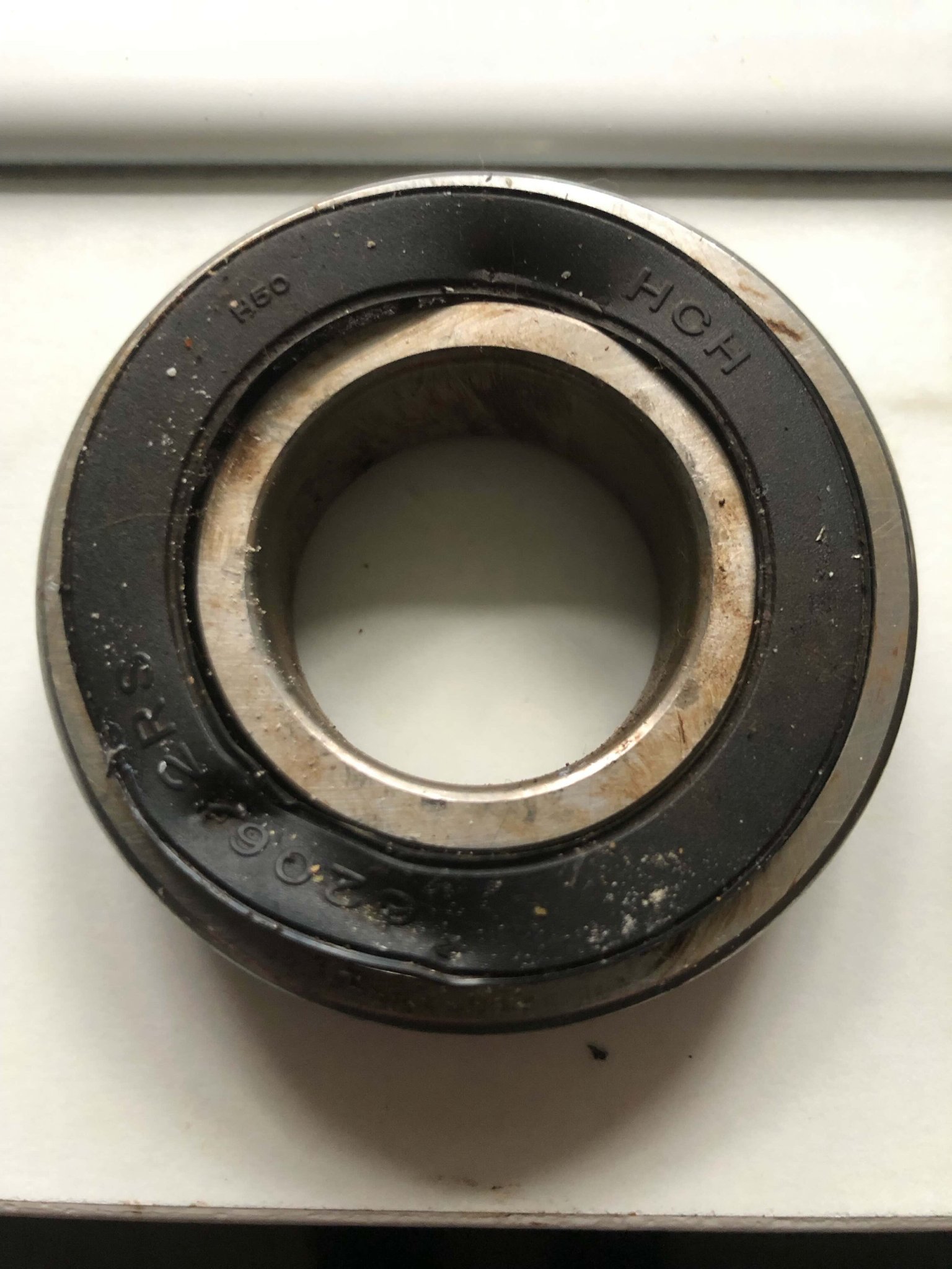

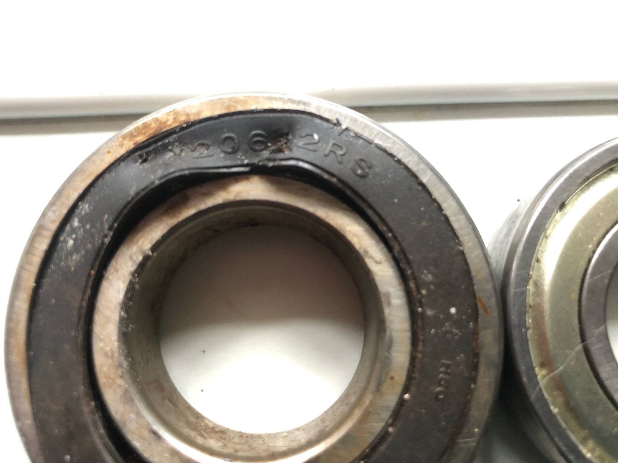

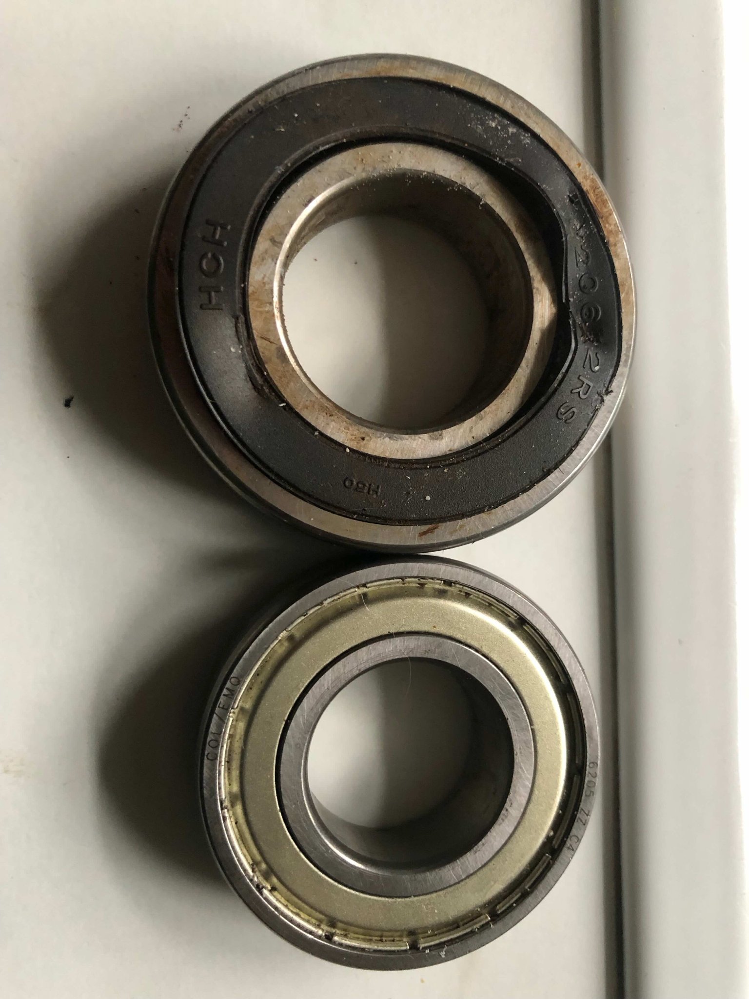

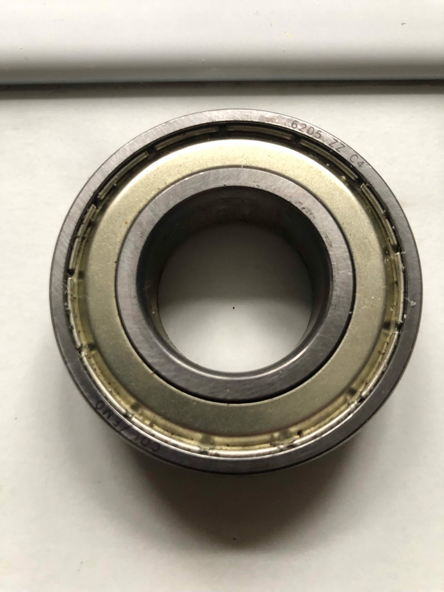

Apologies, I thought I already posted images of the bearings.
The larger bearing does have black 'walls' but the smaller doesn't.
The larger bearing has 6206 2RS on it and the smaller non black bearing has 6205ZZ C4.

Thank you Harry.
So, back to my whole concern is the bearing seal. When I got open the outer casing there wasn't any lip on the bearing seal.
So I am wondering if the bearing seal is the standard bearing replacement kit with a 12.5 bearing seal.
why would it wear away. Surely that would be a pointless design?
What kit is there that has a 6206 2RS, a 6205ZZ C4 with the 12.5 seal please?
Struggling to find it, yet I found one not so long ago please?
As I've already said - You have a sealed drum, so no one supplies a kit to replace the bearings, because they are really not designed to be replaced.
Why, when the original seal is clearly identified on the original seal, as a 17.5 are you even looking for a 12.5? I don't understand. The OEM seal, must be the correct item, unless that drum has been opened before, which is obviously not the case.
When you fit the new bearings and seal, don't knock them in, by hitting the centre of the bearing, you will damage them - use a socket, bit of tube, or what ever, so you hammer blows land on just the outer edge of both bearing and the seal.
Aplogies, the reason being when trying to find a seller of the 17.5, Hoover came up with a bearingset that was compatible with my machine and other Hoover similar to it, it stated the 12.5. And like I said when opening it, there was no protruding lip and you stated the lip would be showing.
Just conflicting answers when trying to track down the almost impossible 17.5 bearing seal. The only place is the Ukraine! And just wondering if that extra lip (.05) was needed. Just seems a little weird that all the models similar have the 12.5.

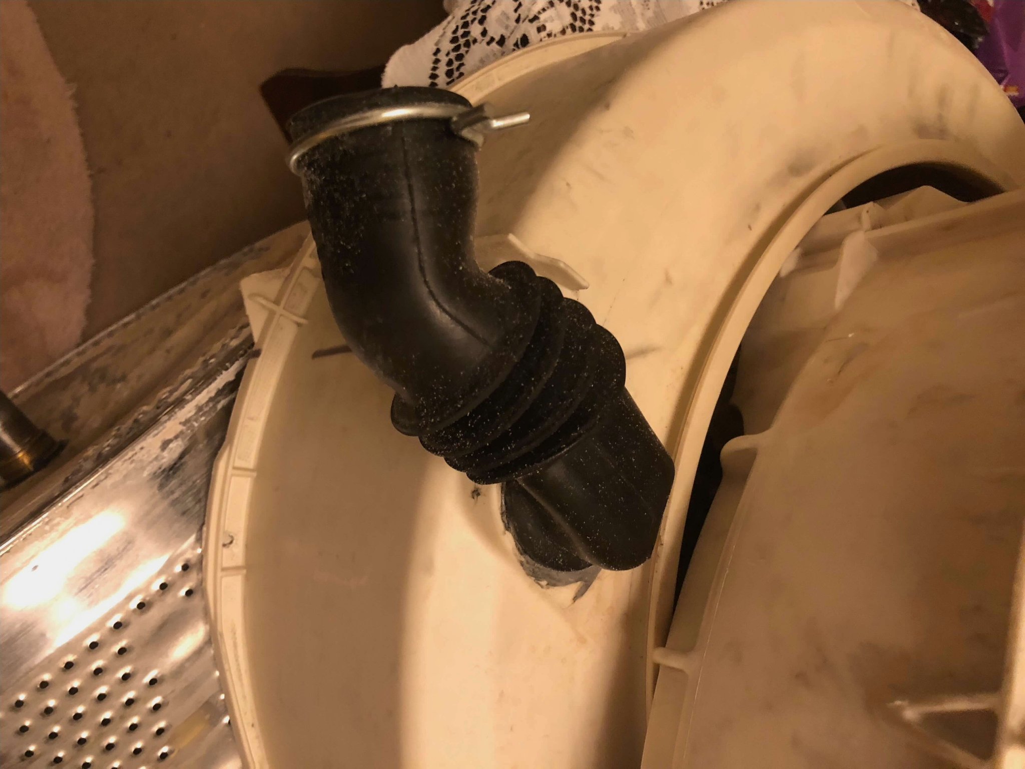

Just a side issue. When taking the machine apart, I noticed rust down the inside of the frame (now fully treated).
The fill inlet rubber hose connecting to the outer drum was leaking. Will the Silicone 825, I am using for the outer drum reseal, do the job of sealing the fill inlet rubber hose to the outer drum please?

Hello and apologies. Been ill.
The machine is up and running now. I siliconed the two halfs and added 20 nuts and bolts including Harry's idea of crown washers around the drum.
There was a small leak in the drum resealing but I think now the silicone has properly cured the drip has appeared to have stopped.
The bearings seem a little tight, but that is my fault.
All seems to going well so far!
