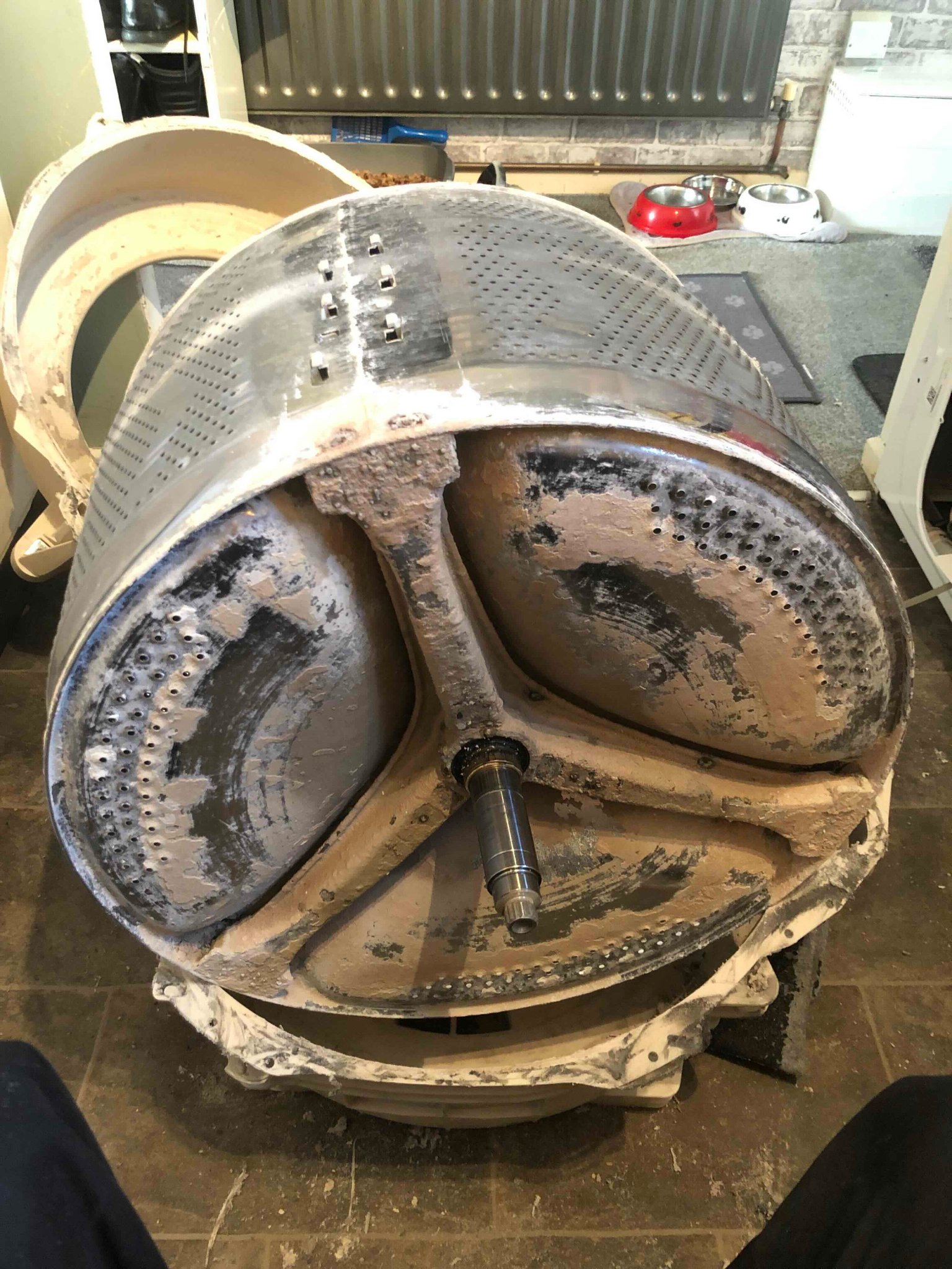

Started late in the day today to remove the drum. What an absolute painfully frustrating job it is these days. Back in the day was bad enough!
Just struggling to get the actual drum out of the casing. The battle continues.
The drum is finally out! That's enough for me today as I have been off work with flu all week. Absolutely drained but hopefully tomorrow I can use my brand new hacksaw, bought for the occasion, to seperate the drums 'halfs'.
Any guesses to what the bearings are going to be? Hopefully I can tell you tomorrow.

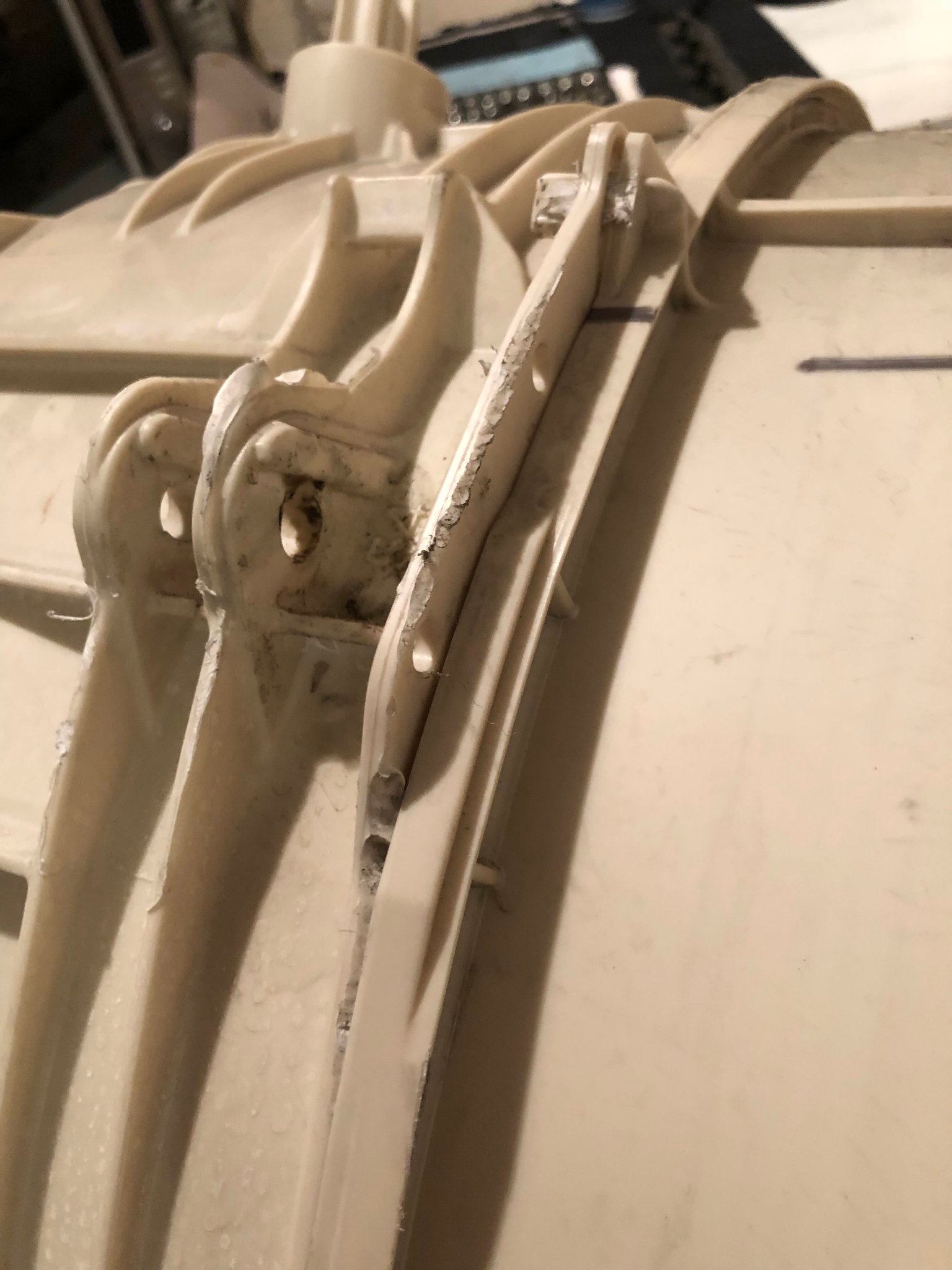

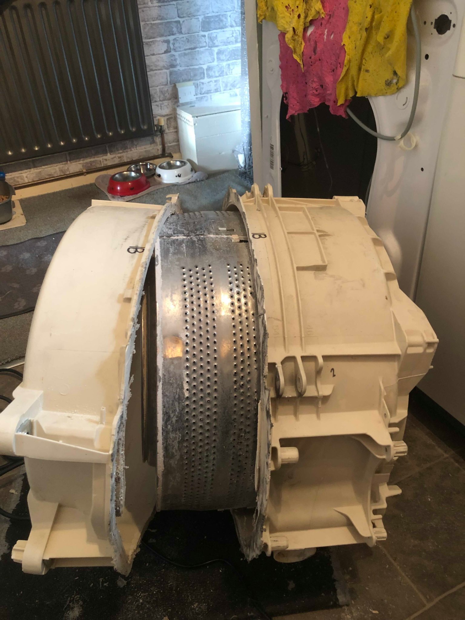

Because of chest infection I attempted to hacksaw apart the out casing but no energy.
So it was a brilliant excuse to get a tool I have always wanted, an angle grinder, £18 from Argos.
Instead of taking hours to hack through, it took about 10 minutes with the AG, and a smoother finish for when sealing.
I will get the bearings out and order them ASAP.
Clean up everything else whilst waiting for the bearings to be delivered.
For the life of me, I simply can't get the seal out to get to the larger bearing. The small one is out.
Any ideas please? :mad:

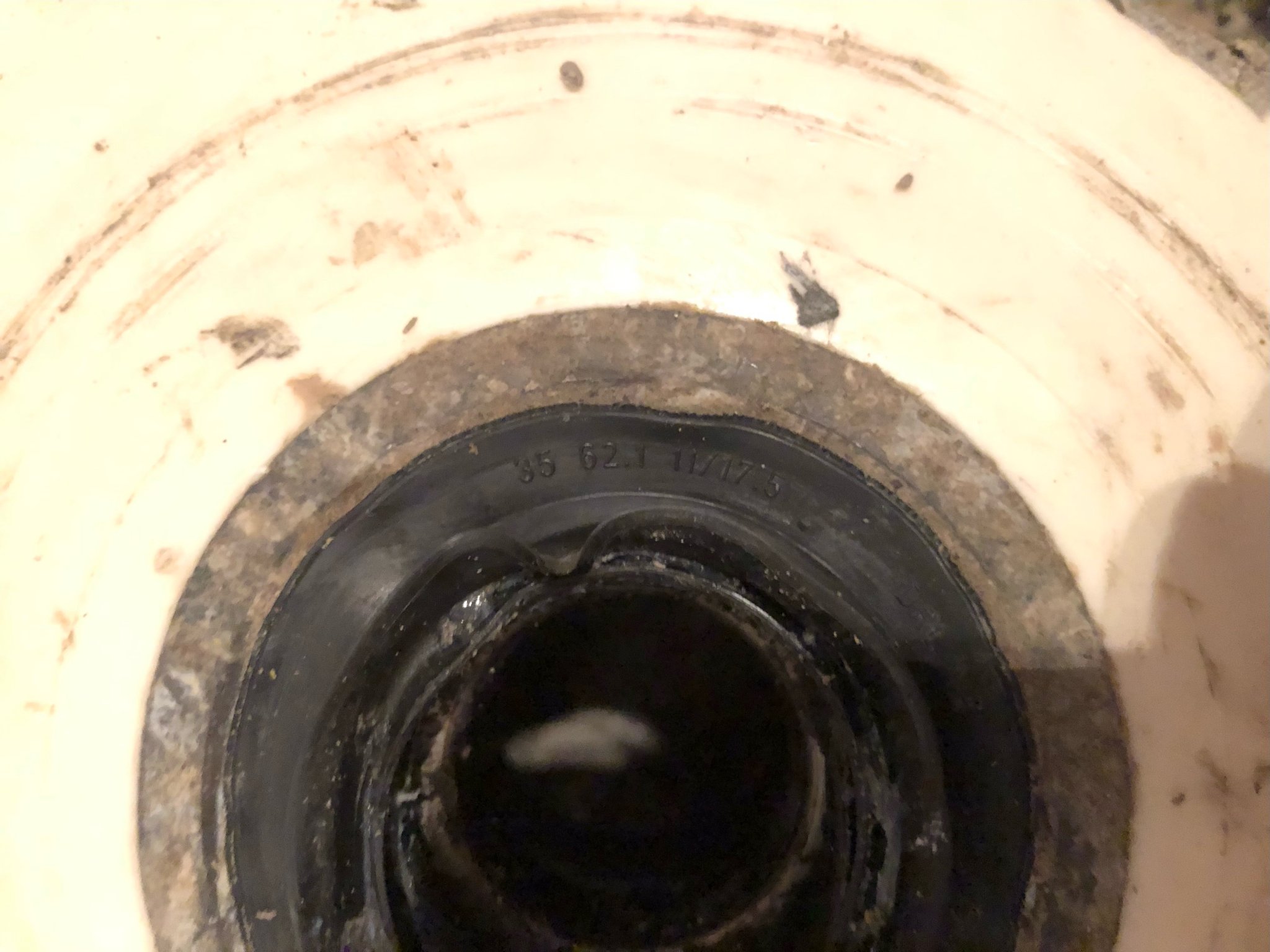

Absolutely niothing is shifting the bearing seal. Banging from all angles and both sides!
All very restrictive.
I don't want to deface the area the seal sits in. Just no movement at all.
I took a photo before trying to strip the seal apart to hopefully reduce the friction that is keeping it in place, especially as the small bearing has absolutely no paret number on it.
