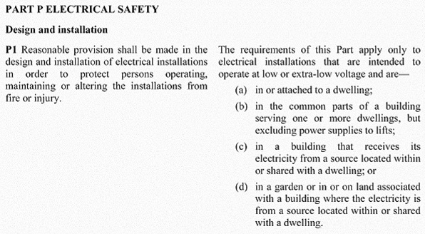

I was lucky, when I moved there was no Part P.
I did do the odd house bashing but the Part P law stopped that,
Part P has nothing to do with what you are talking about.
Once again:
upload_2021-3-11_19-31-48-png.226154
That's it; there is no more.
I am assuming you did not, before 2005, design and install electrical installations in order to endanger persons...
