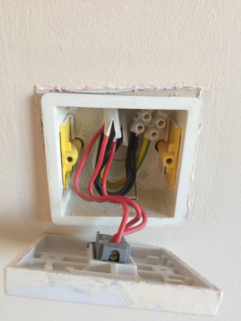

I can't get to the switch in bedroom 1 yet but behind the switch in bedroom 2 is as in photo.
So do I continue to look at switch in bedroom 1 now seeing all these wires in bedroom 2 switch.
Does this help you.
In the switch in bedroom 1, the Reds will have been connected wrongly.
Open it up and - before you do anything else - label the cables and write down how it is currently connected.
You may find that the switch has 3 terminals. It should be wired with two wires in one terminal, one wire in another terminal, and nothing in the third terminal. But it may have been wired up with one wire in each terminal; I think that would explain your symptoms.

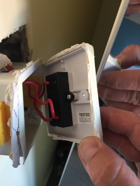

I just got the switch off the wall, some silicone around it, why I don't know ??
But
All black wires are in connector.
All earth are in a connector.
3 red wires go to the switch "one was not connected" I've also noticed is upside down in respect to the others so I think he was in bedroom 1 switch ?
Anyway.
3 red wires as below.
Top red L1
Bottom left red L3
Bottom right red L4 is where I've connected the lose red wire.
Now what happens is,
Bedroom 1 light works as it should.
Bedroom 2 & 3 lights are both on but when I switch in bedroom 1 this makes 2 & 3 go out.
Switch off bedroom 1 and 2 & 3 come back on again.
