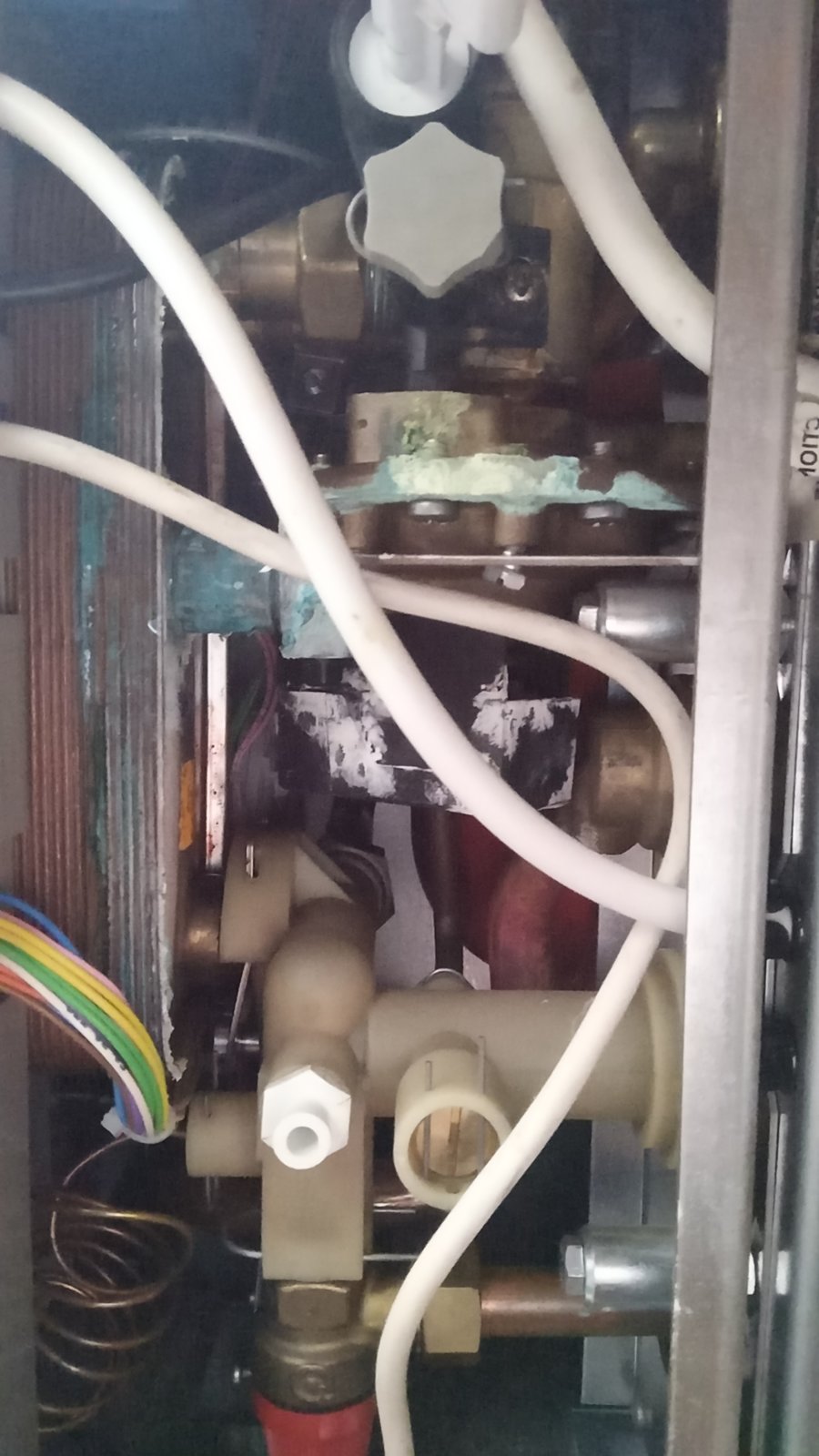

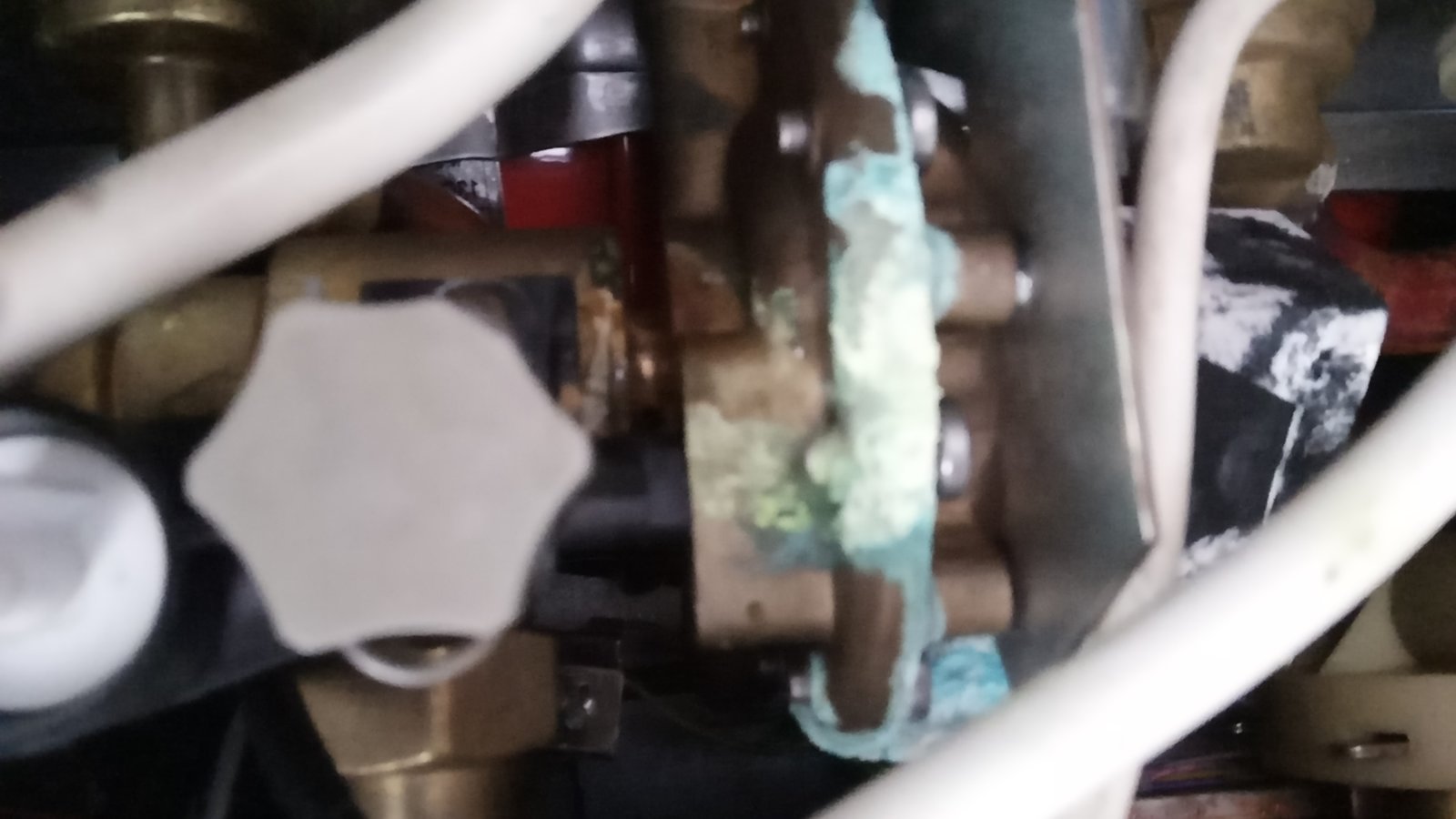

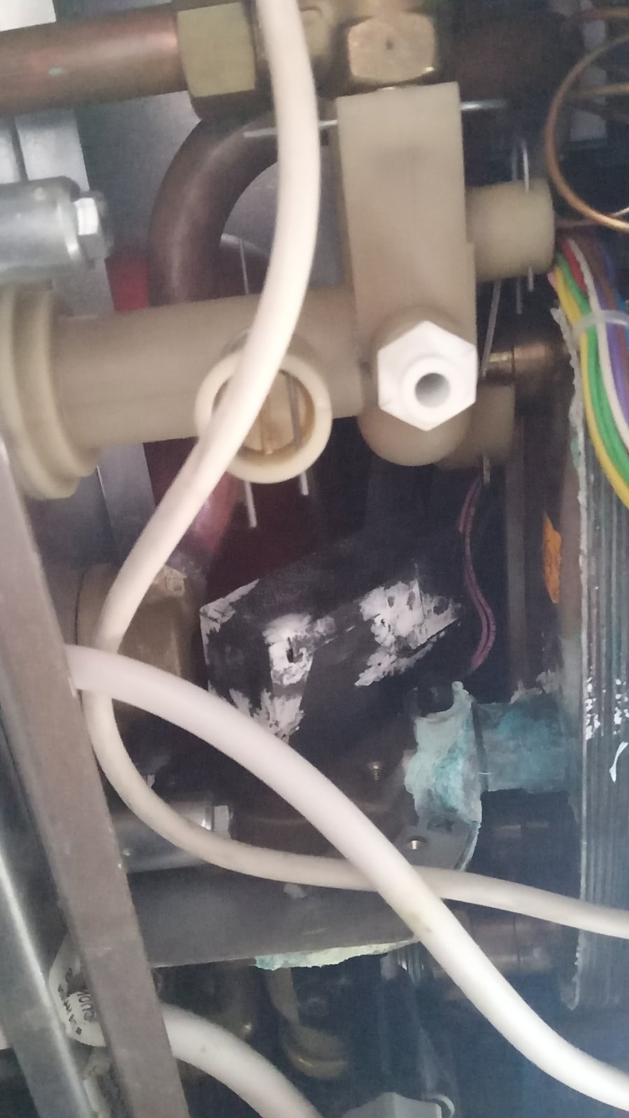

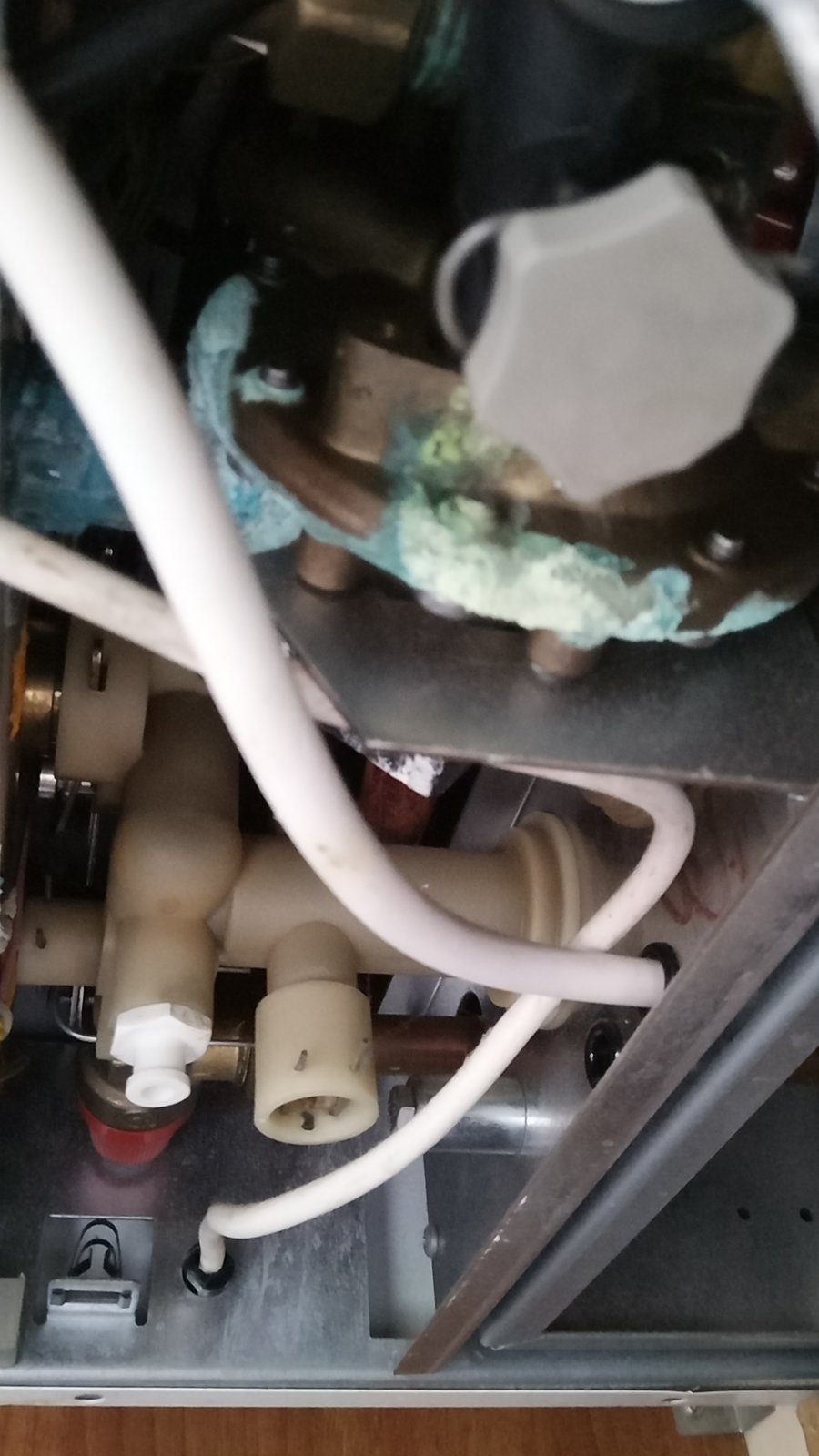

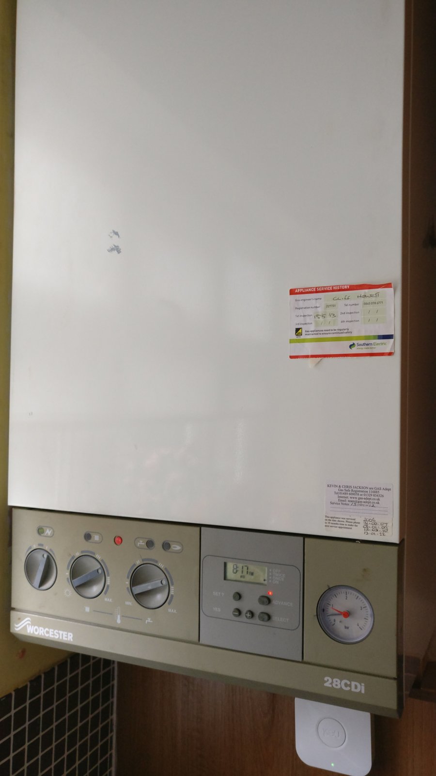

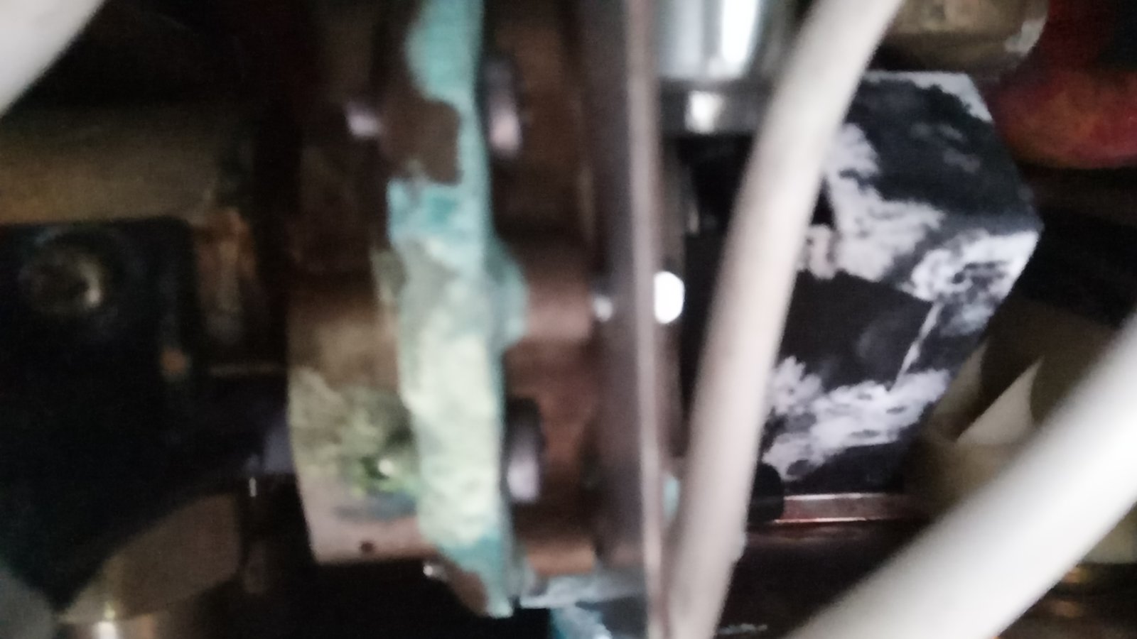

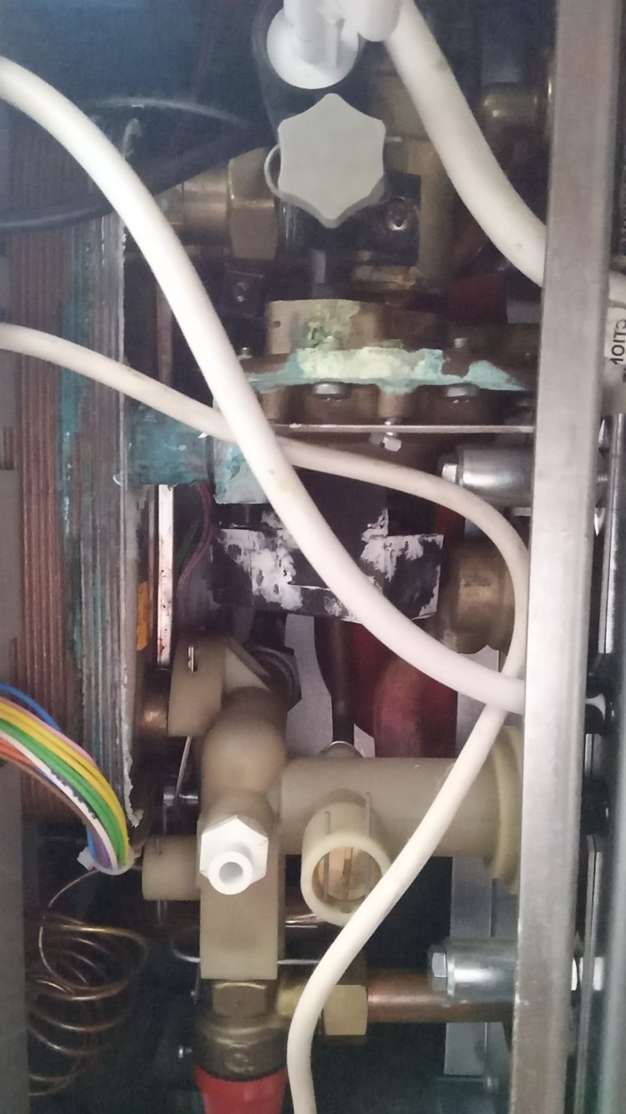

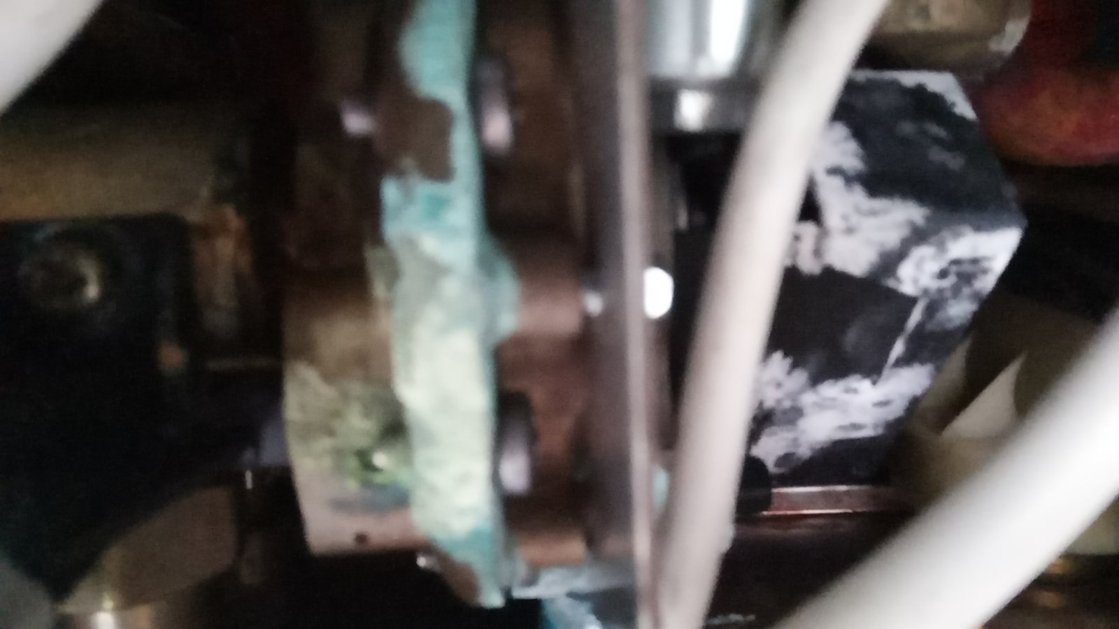

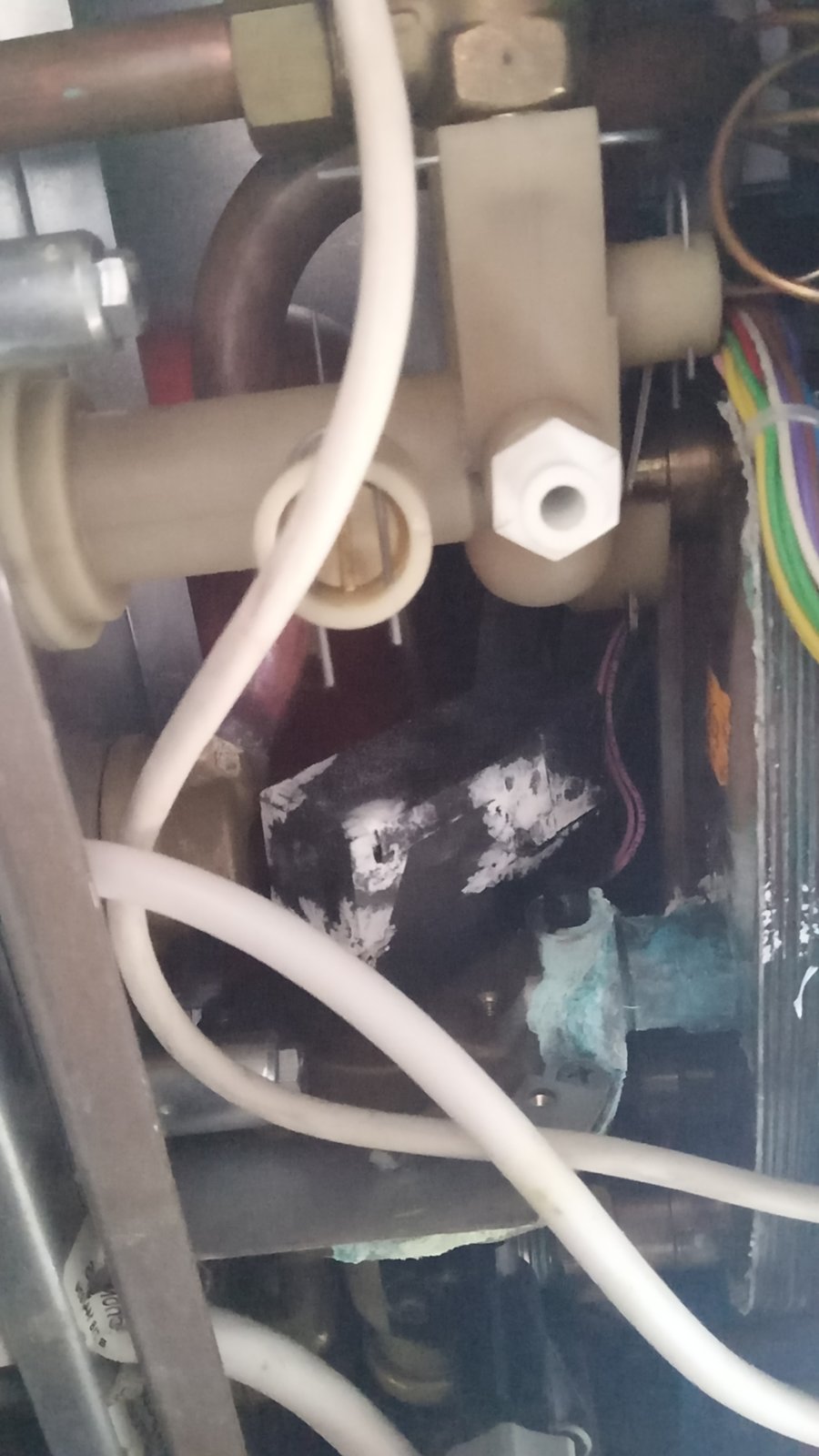

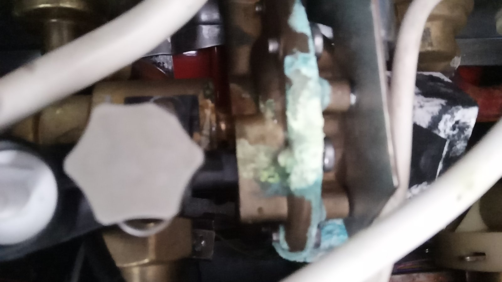

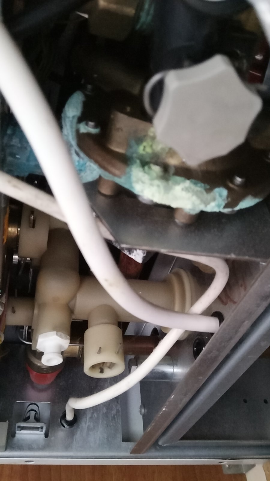

    We inherited a Worcester 28CDI when we moved, which had been installed in 2004, but serviced annually. Its been leaking for the past few weeks, about half a pint a week. We had it serviced at the weekend and was told we needed to replace it as the parts are no longer available.
    Im not exactly sure where it is leaking, possibly the heat exchange.. but theres also some white/green colouring to some of the parts (rust/corrosion?).
    I dont have a clue about this sort of thing as was hoping someone could advise, or identify the parts from the photos... Bit tricky getting decent pics, but all from the underside...
    IMG_20180328_082246.jpg IMG_20180328_082304.jpg IMG_20180328_082346.jpg IMG_20180328_082403.jpg IMG_20180328_082414.jpg IMG_20180328_082426.jpg

    Keep the boiler and sack the engineer. Looks like leak on diverter. Parts are available

    These are an absolute barsteward to change, but they are available. Be prepared for a hefty bill, or get Worcester out on a fixed price repair

    as already advised get a fixed price repair from Worcester think its about £270 but includes all materials and labour

    Diverter as said.
    I changed all the internal parts on mine as its water side with my old halstead.
    Bit of a fiddle but £30 of parts a nd isolated boiler and an hours work on mine.
