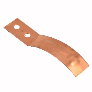

Here is what the earthing strap looks like on a Indesit or hotpoint model :
