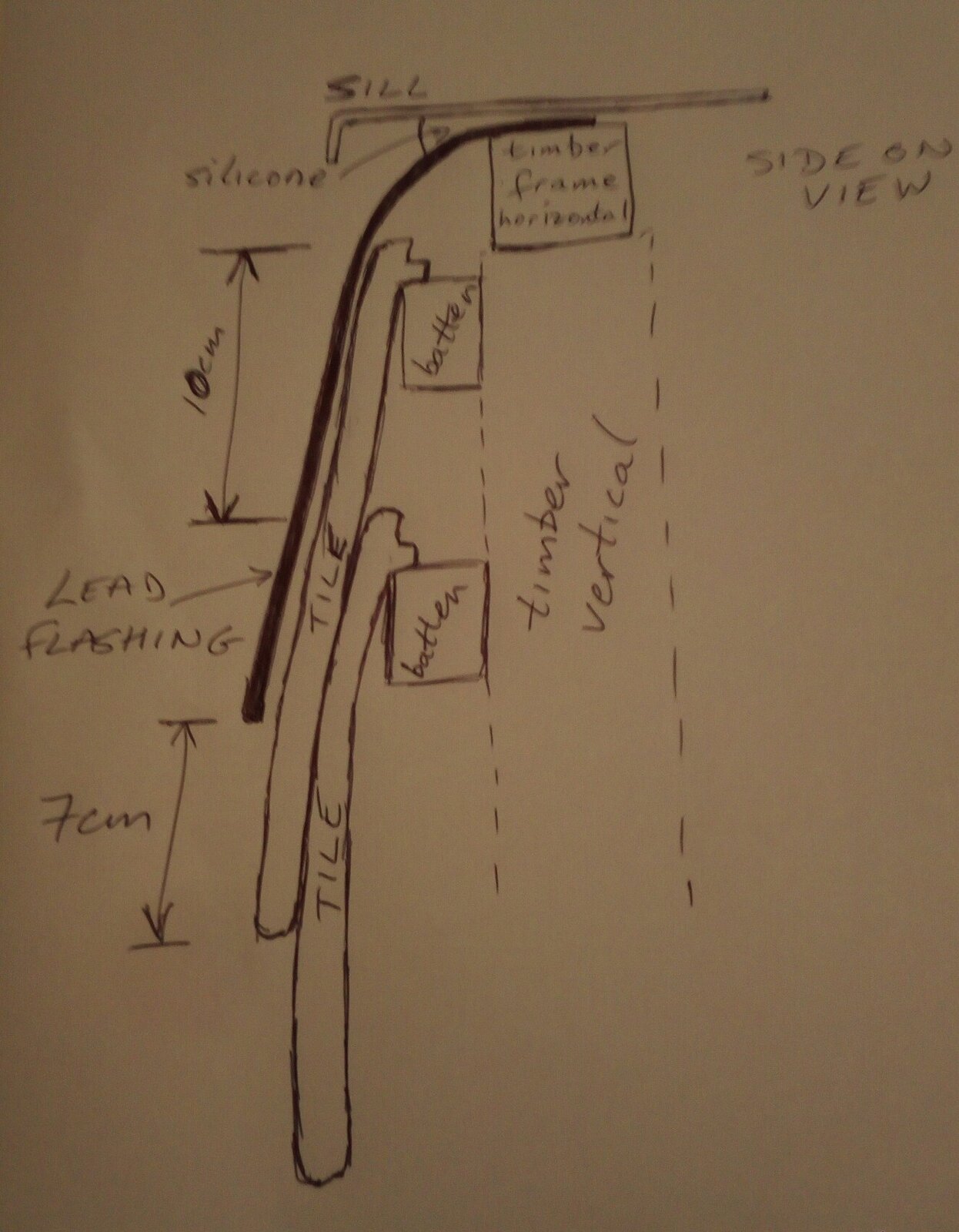

Thanks, the lead flashing overlaps more than it did previously. I've done the battens the same as the original 1930's except the old ones were thinner and wider. Having looked at many in my neighbourhood, it's seems that's the way they have all been done
Here's a quick sketch
It is poor detailing and incorrect .
Looking at neighbours means little tbh.
Your windows are not original and that's probably when the bodge occurred.
Agreed, short of taking the window out, the only way I think I can improve on it is to fix a batten onto the horizontal timber, but stepped down. Then profile the flashing to the shape of the step, thereby creating a sort of tray.

I found the lead flashing to be a bit cumbersome handling it at over 1m lengths, harder to curve and harder to wrestle it into place. Two people would be much easier for that job.
Yes it should have been there .
The window was replaced, chances are the original was split .
I expect rather than fitting a proper replacement ,a fake was fudged to look right.
