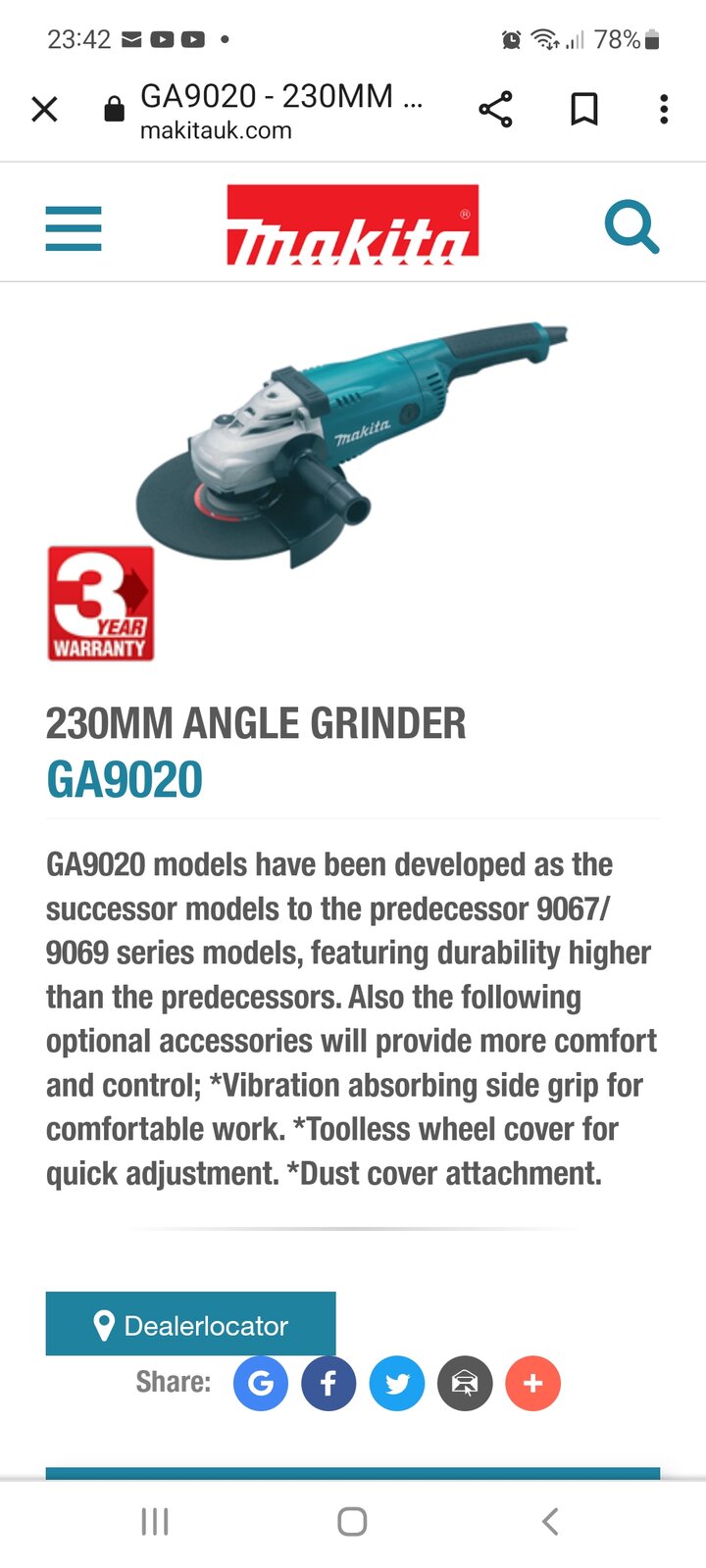

A standard wood or metal toothed blade cannot do this job. Instead you need a something like a segmented diamond cutting disc (sometimes called a diamond saw), more akin to an angle grinder cutting wheel than a saw blade. Because granite is very hard, you need a cutting wheel with a softer bond so that fresh cutting surfaces are constantly exposed (meaning the wheel stays sharp and doesn't clog). I have dry cut granite worktops with a 9in angle grinder, so I can confirm this works
The main difficulty I can see is that most of these discs in 230mm diameter are made with a 22.2mm bore to suit angle grinders, not the more normal 30mm you'll find on a modern portable saw. Another potential problem is that a circular saw is just a bit slow (rpm) for the task

God shows my ignorance!! It's not even a circular saw I have, it actually IS an angle grinder! ‍♀️ (for some reason I thought an angle grinder was just the one that takes smaller discs!) ‍♀️ ....Anyway! Sorry and thank you for your reply. Sorry if I've wasted your time not even knowing what I'm talking about in the first place! This is what I have.... (see pic) and I will have a look for what you advised. Thanks very much
