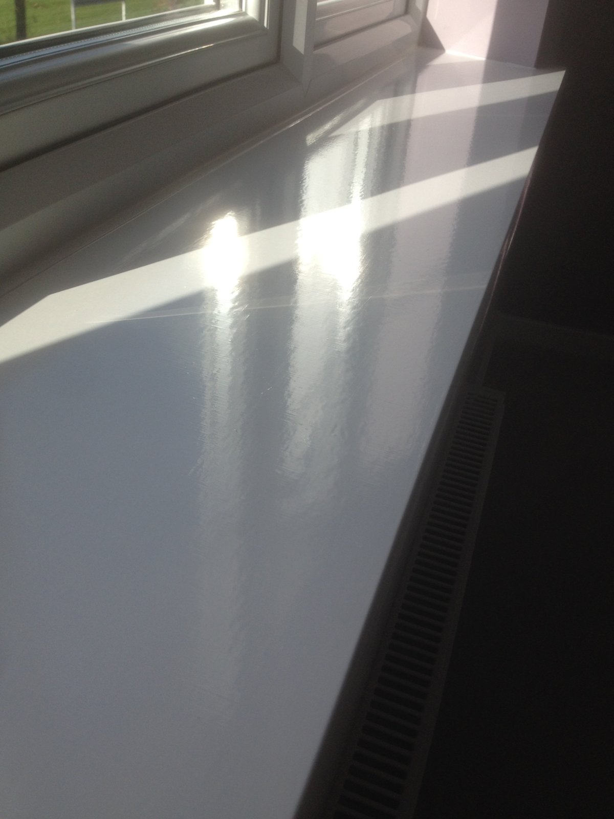

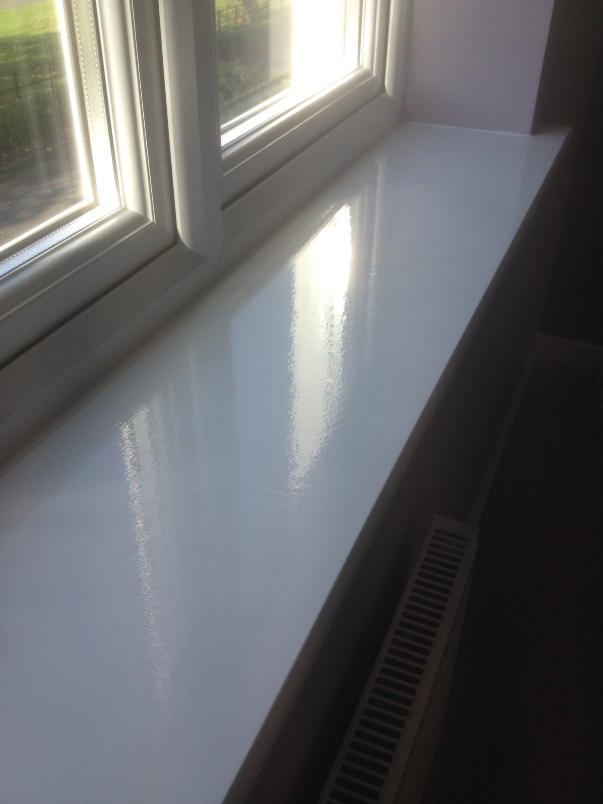

This is a window cill I did last week in Armstead water based Gloss. Doesn't look too bad. I use Fossa Viper Trim Brushes or Proform Blaze, and also Purdy.

Robbie, I don't doubt your ability to paint to a high standard but a window sill in WB is quite different to a 2.4m x 5m bookcase made out of MDF (and not pre coated in two pack primer).
Okay, I accept that we weren't talking about painting large areas but I often need to. At the risk of sounding like a hypocrite, I do use Leyland acrylic primer when hand painting MDF. It is cheap and not particularly good at obliterating the dark MDF colour but it is a dream to sand back. Infact, I sand it back until I see the manufacturer's sanding grooves in the MDF. The level of suction is still pretty high, which helps the OB eggshell soak in and allows me to get away with the one coat of primer and only two coats of OB eggshell.
