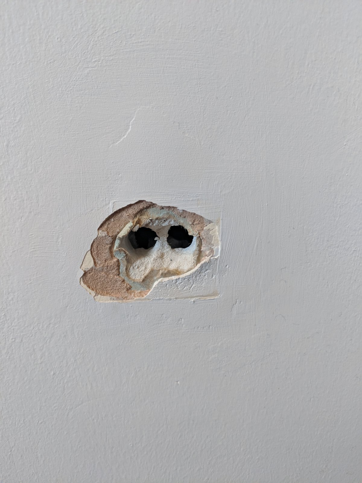

Hi all this bloody towel rail :mad::mad: lol.
Towel rail keeps coming loose atm its in the plasterboard just with rawl plugs and screws.Its now just been pulled out 1st pic

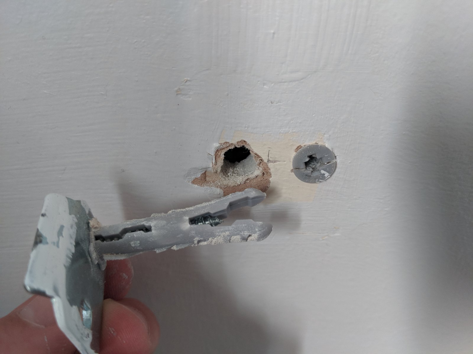

The right hand side came loose last year so i decided to use a spring toggle thinking that would hold it better but its again slowly coming loose (2nd pic) :mad::mad:
Any ideas apart from taking the bloody thing down :D

Yeah there decent spring toggles like you said they should hold the weight no problem,but you can see the plasterboard is starting to come loose where the spring toggle is behind it in the 2nd pic,it's also a night mare creating a big enough hole to get the toggle through.

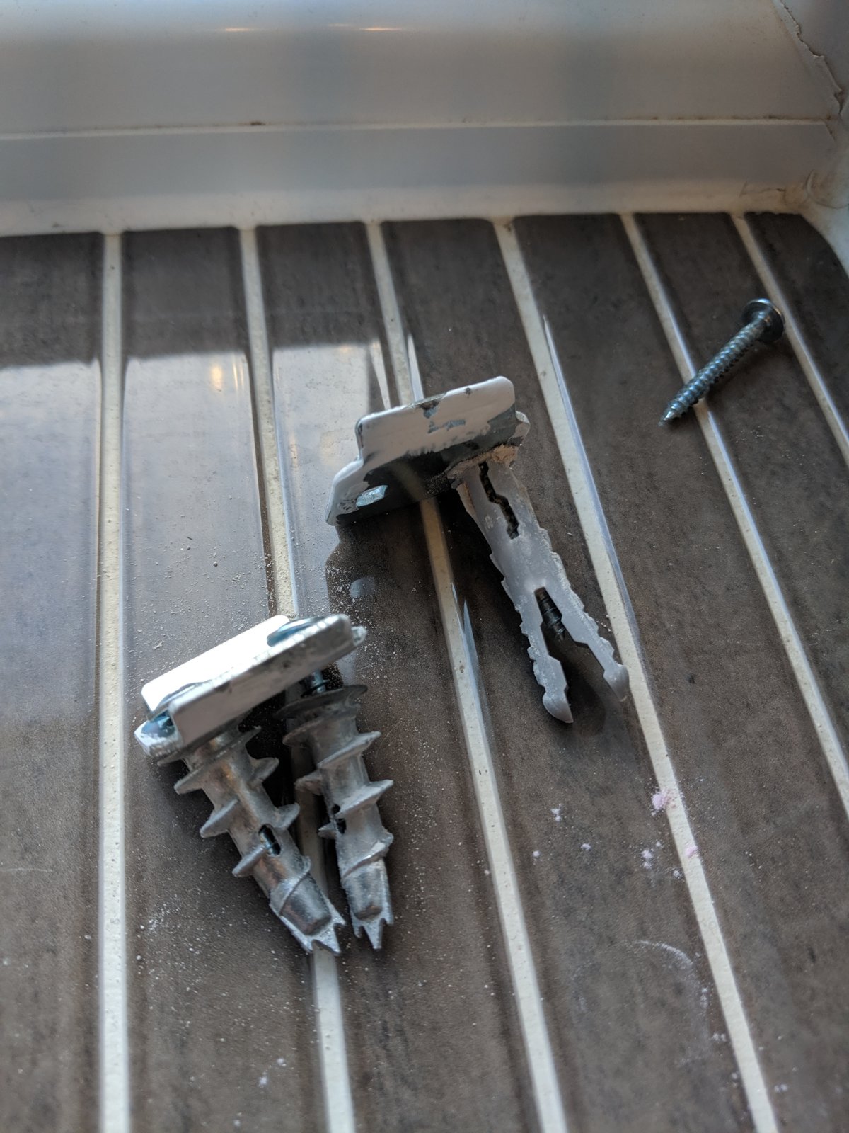

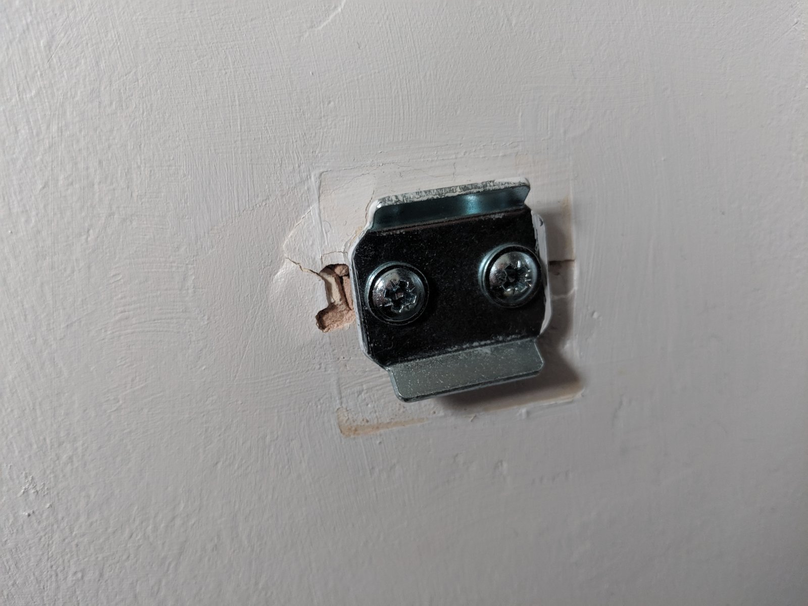

Right i've finally pulled the left bracket out due to the plasterboard coming loose and i've discovered that i didn't use a spring toggle :whistle::oops: but some metal rawl plugs. I think i tried to use spring toggles but the holes were too big and i couldn't get 2 screws in the gap.
Any ideas?? ill have a poke around and see if i can find the stud wall but the trouble is the towel rail is currently in the middle where the mrs wants it.
I've got spring toggles & wall anchors that i could possibly use once i've patched up the wall unless i find the stud

Holes are too close together for plasterboard fixing , you could fit a shallow wood plinth then secure to that , spreads the load and will hide current damage .
A single fixing in each bracket should be strong enough to hold the towel rail the ends of which should cover the complete bracket.
