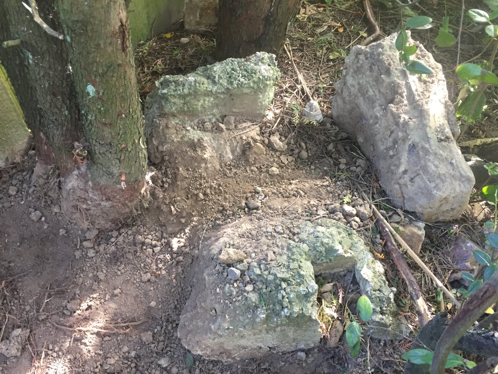

Hi
The end of our garden is a bit of a no go area. This includes some large lumps of concrete relating to previous fence repairs. (Where posts had been removed and panels replaced)
I've tried to break them up with a pick, but obviously not strong enough. Short of hiring a pneumatic drill, is there a simple way to break them up into small pieces to remove?

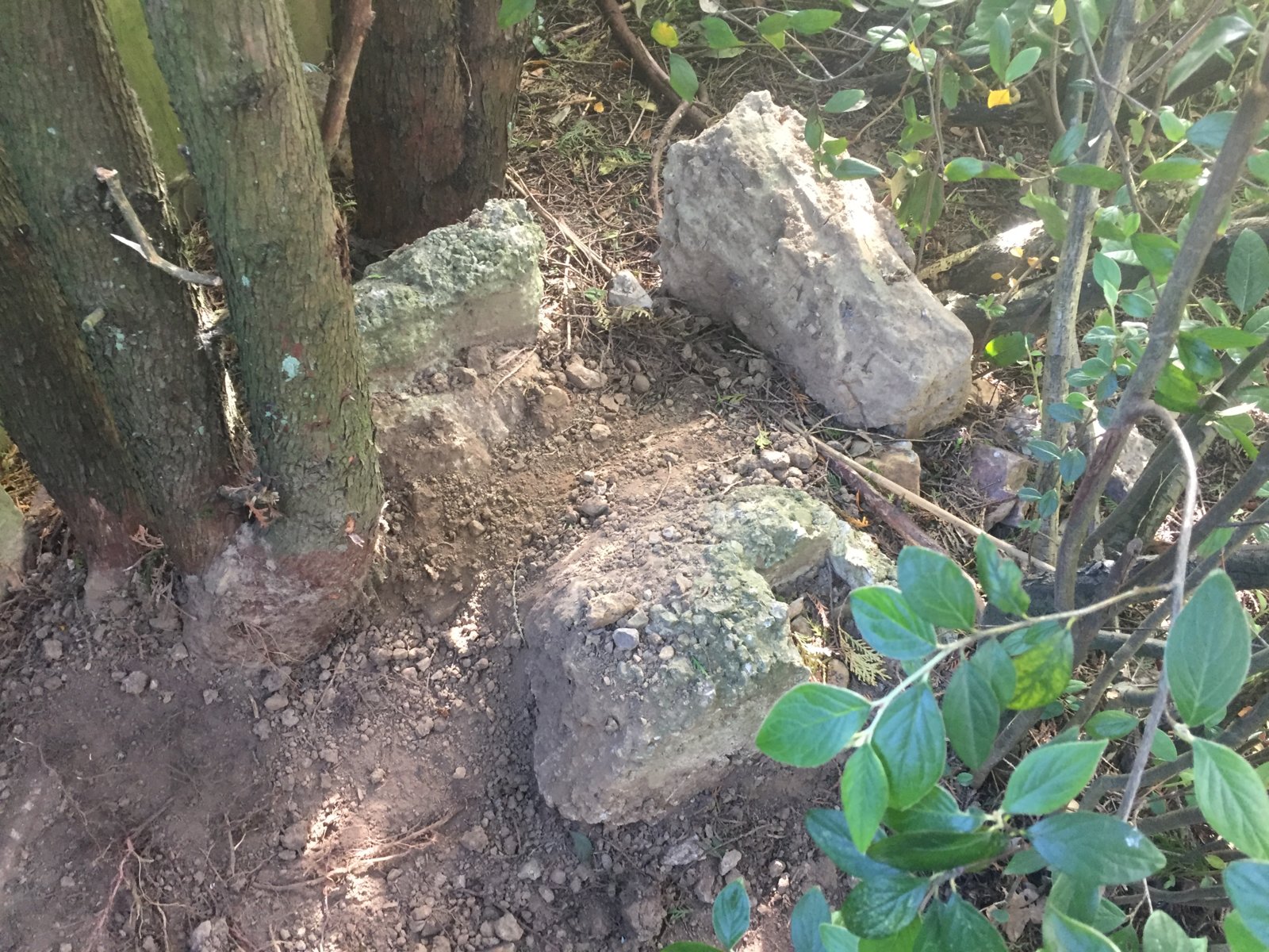

Hi All
Thanks for swift and helpful replies. Please find photos of said concrete. The problem is two fold. Firstly, the size and weight. Also rocks have embedded themselves in soil at back of garden. Don’t know what drill and sds combo is. Can someone explain that please. (Link doesn’t work due to COVID crisis)
I was going to naively still as many holes as I could, then whack with hammer and chisel.

No scale in your photo.

Thank you again. Just waiting for it to get a bit cooler before I start with my drill, hammer and chisel.
You might find just wacking them hard with a sledge hammer or lump hammer will cause them to break into manageable lumps.
