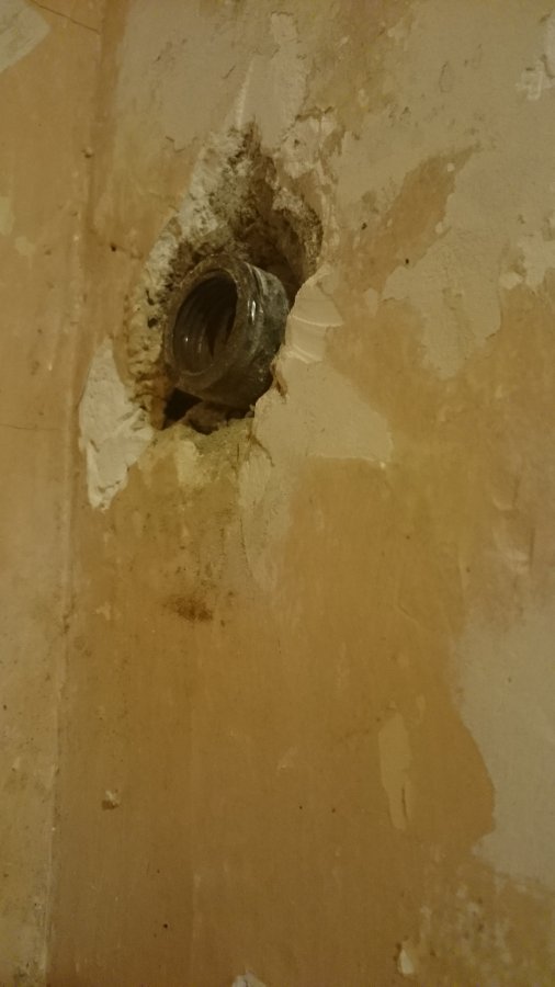

I'm looking for some advice on removing some old pipe that was left in place in our cloak room. It's as tough as old boots so guessing its galvanised steel/iron (think it was originally the feed from the old water mains up to the old tank in loft).
What I’ve got is the end of threaded joint sticking out from the wall by about 3mm - my thoughts are try and remove enough to get it back under the surface and patch over the top.
I’ve got a multi-tool (probably not powerful enough – but easy to get access), reciprocating saw (not sure if I have enough access) and angle grinder (not my favourite tool).
Any suggestions/advice on what to do and what blade I need to buy?
Is there any possibility of gripping the stub very tight and seeing if it will undo from a joint further back - assuming that there's no access to yank it back from the other side? Mind you if its only 3mm protruding then its unlikely.
To cut it, an angle grinder is the way but the circular slitting disc will gouge a groove in the wall, of course - but you'll have to do some filling anyway.

I fear the bit sticking out is part of a T joint and I think the other arms attached to a pipes fully embedded in a solid wall (though I will try grabbing it with some mole grips to see if it will undo). Sounds like the angle grinder is the way forward - will any metal cutting disc do or should I be looking for something specific?
You've a choice really.....the best disc is a steel slitting disc, which are very thin - 1mm or 1.5mm. However, a grinding disc will do just that - grind the stump down. If you intend to grind you'll get a spray of hot steel particles which could interfere with the decor - the choice is yours! I'd guess there isn't an issue with a bit of heat build up? If there is, just cut a bit at a time, allowing things to cool.

if it is indeed Galvanised pipe be very careful cutting it with any kind of disc and make sure you use proper protective masks this stuff can be Lethal
Thanks for the help.
I tried to unscrew it but no joy (a piece of wire confirmed the pipe in the wall does up and down). Also it sticks to a magnet so iron of some sort.
Definitely not a gas pipe (or if it was it's not now and the end is open). have attached small pic below
Current decor nothing to worry about but like to keep the fireworks to a minimum (though it really doesn't stick out much)
Shame it's near the corner of the room otherwise the old strategically placed mirror/picture would have been tempting.
As there's already a little damage I'd get in there with a 1mm slitting disc in a 4 1/2" angle grinder......as the discs are so thin, the fireworks are minimal.
John :)
It you use a bolster and cut a V channel into the wall, with the pipe in the middle of that V - That'll let you cut a corresponding V into the pipe, then when you fill the hole it should cover back to the original wall level.
When it's cut off - cover the metal with some old oil paint - or you might get rust bleeding through the filler.;)
