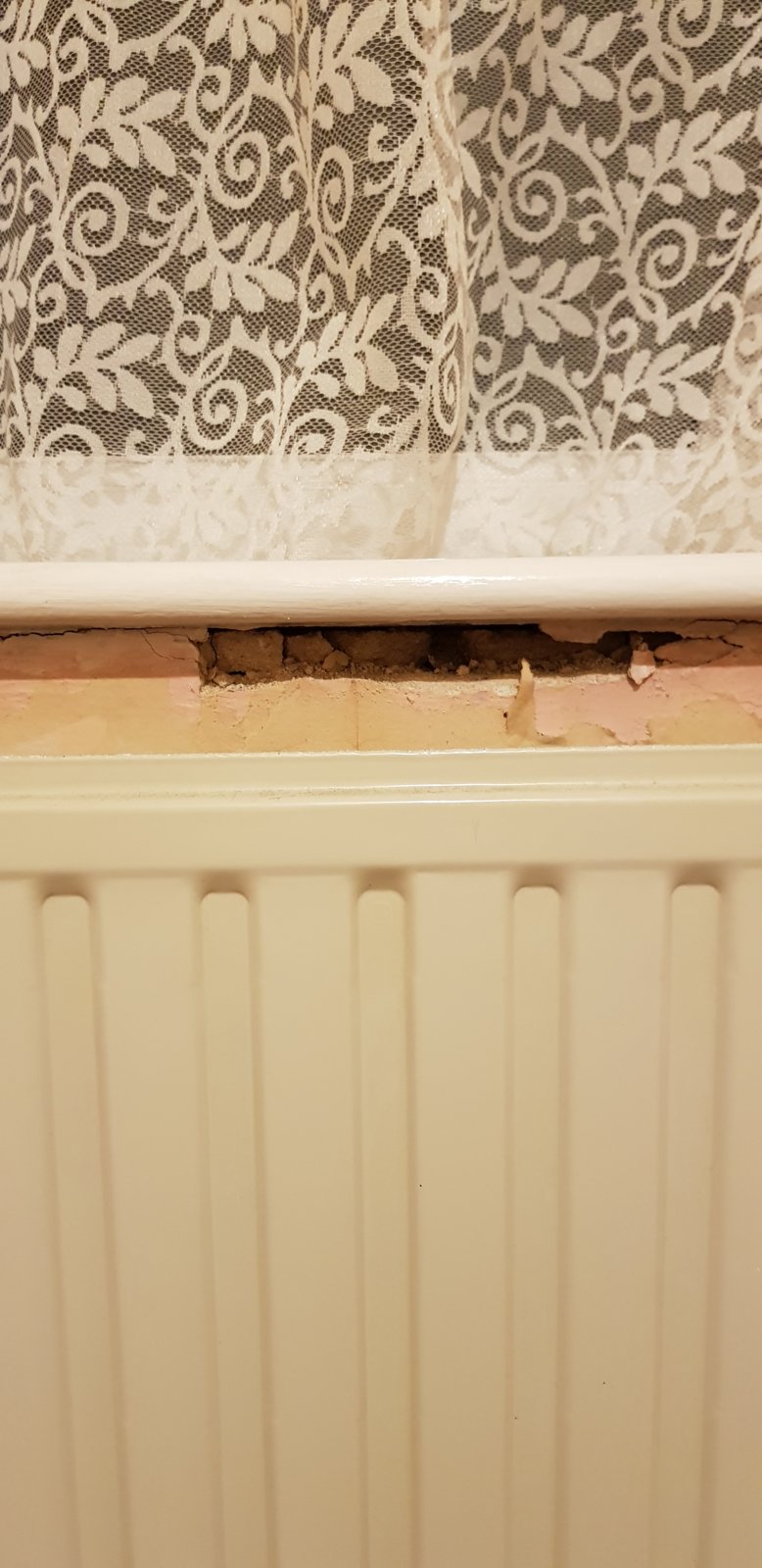

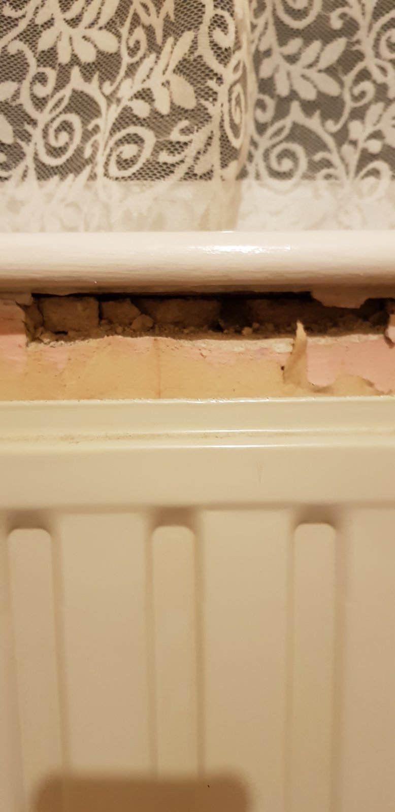

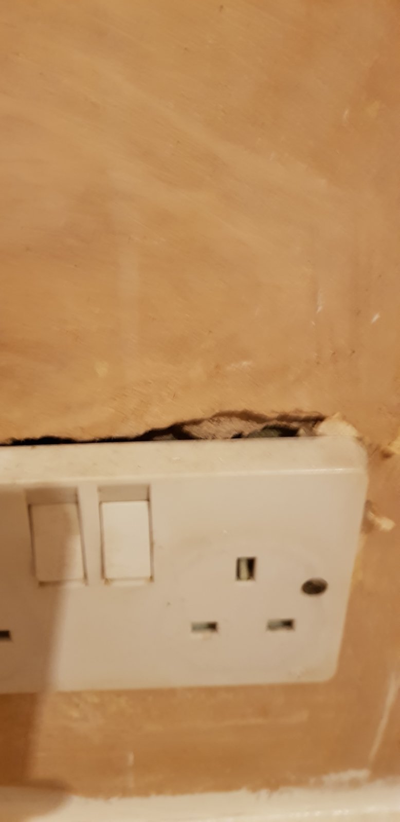

Hi all
Removed wallpaper in my bedroom and it's pulled lumps of plaster off in certain areas, pics attached
What's the best product/method to repair
Thanks in advance

Sprocker, good evening.
I would consider using expanding foam below the sill, this will possibly eliminate ant draughts, allow to set and cut flush with the plaster.
Also worth thinking about ? is to fix a vertical facing timber directly below, and in contact with the sills front protruding edge?
