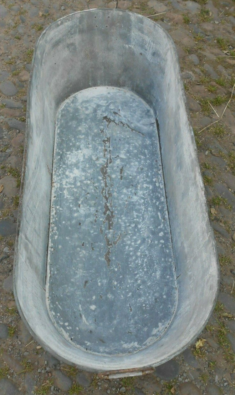

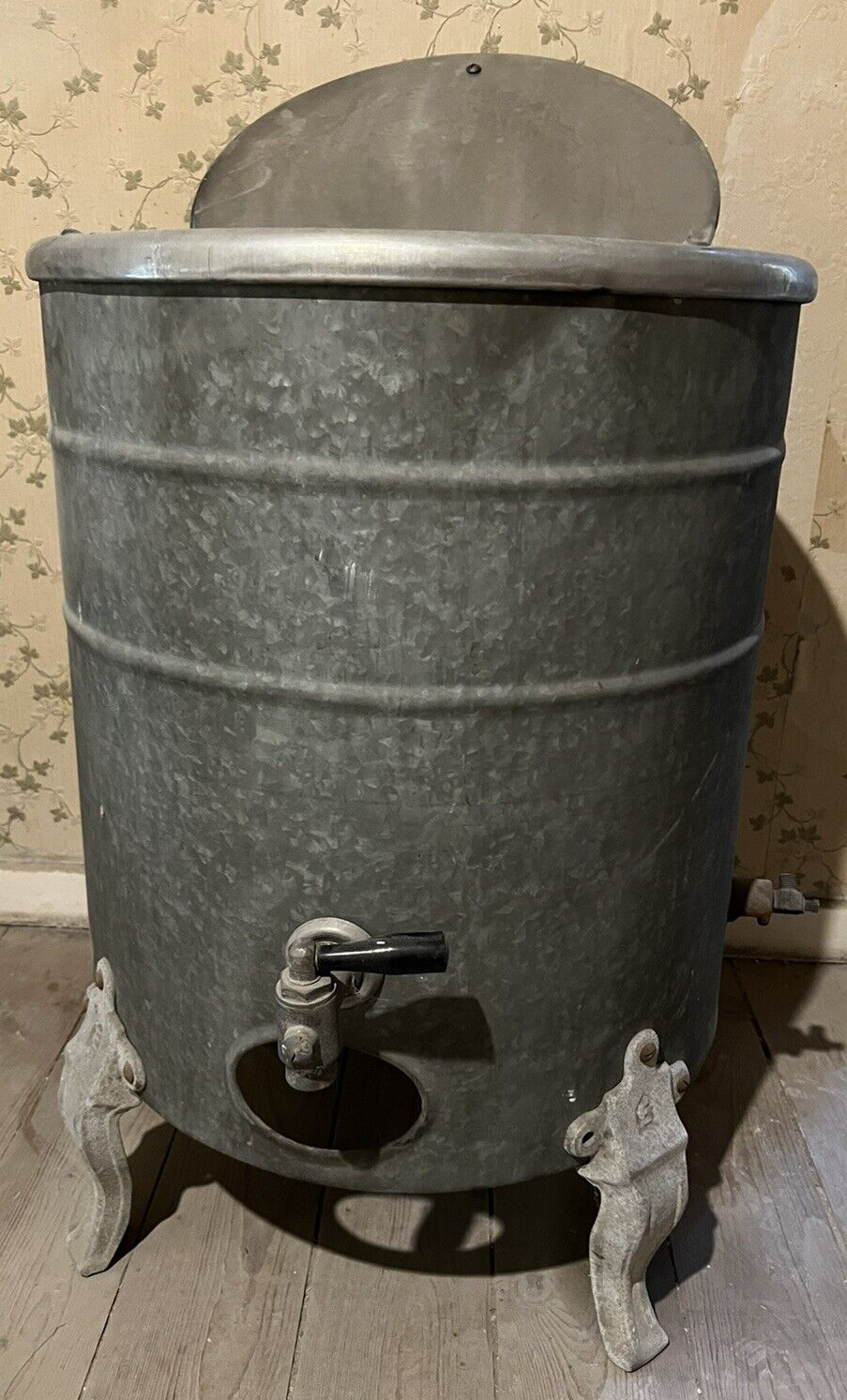

Personally I simply don't use a bath, only use showers, seems a lot of effort just to have a bath, the old bath 1681729364926.png we would fill with the wash tub boiler 1681729499734.png glad to say those days are gone.

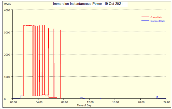

I've posted this before (so not up-to-date). In my case (with 'very good insulation' - see below) , since I have E7, the immersion circuit is only powered during the seven nocturnal 'cheap hours'. When first energised (about 00:30 GMT) the element is powered, usually for 1.5 - 2.5 hours, to get it 'up to temp' before the thermostat switches it off, after which there are just occasional very brief periods of 'top-up' (mediated by thee thermostat) during the rest of the night. By 00:30 GMT the next day, some 22 hours after the end of the last 'main burst' of heating, and some 17 hours after any immersion heating, thee water is still plenty hot enough.

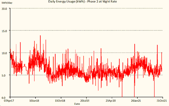

However, to achieve that sort of performance really does need "very good insulation". I've also posted this before ... My HW cylinder is in a relatively little heated part of the house, such that heat loss shows considerable seasonal variation. In May 2018, I upgraded the 'supplementary insulation' (in addition to that on the cylinder itself) from about 200 mm (top, bottom and sides of cylinder) to some 400 - 600 mm, and that resulted in something like a 2-3 kWh/day per day reduction in energy usage.
However, this does illustrate that, despite what some people believe, even an extremely well-insulated cylinder can loose significant heat if in a fairly cool environment. This graph illustrates the dependence on immersion energy usage (hence heat loss) on variation in (ambient outdoor) mean temperature during the year. The effect of thee increase in insulation in May 2018 is again very apparent. ...
