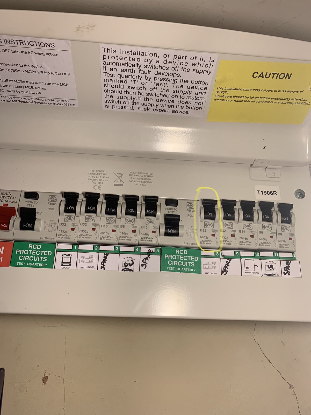

Hi, it’s on ring circuit 8 with 32 amp breaker. Not been able to open to see what cable size is connected to the MCB. Cable from the socket to FCU is 2.5mm2 with a 13amp fuse. Wiska box was to house the cables connections externally above the floodlight so they’re watertight…or alternatively I could house the connections inside the house in the below choc box?
Ok, that's good enough - assuming all is as it should be.
