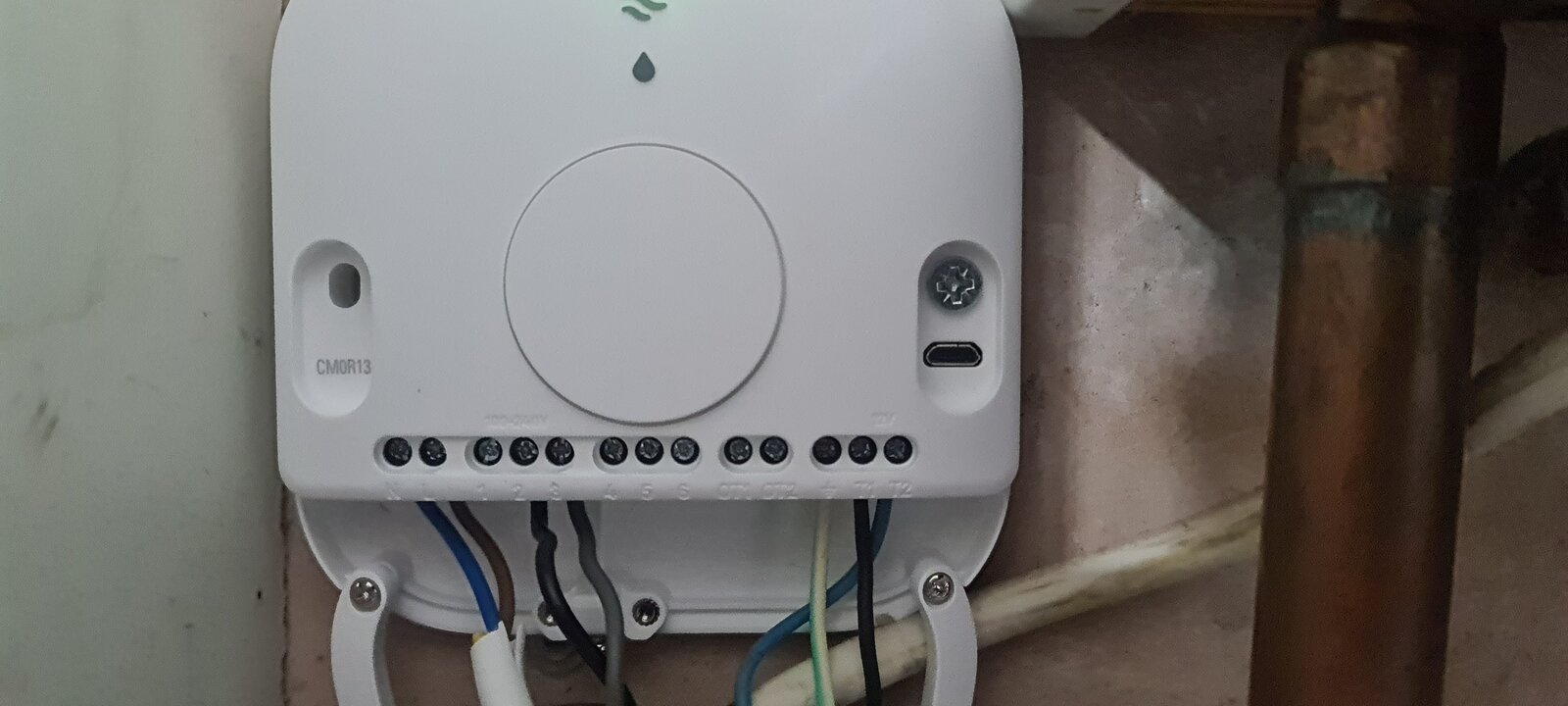

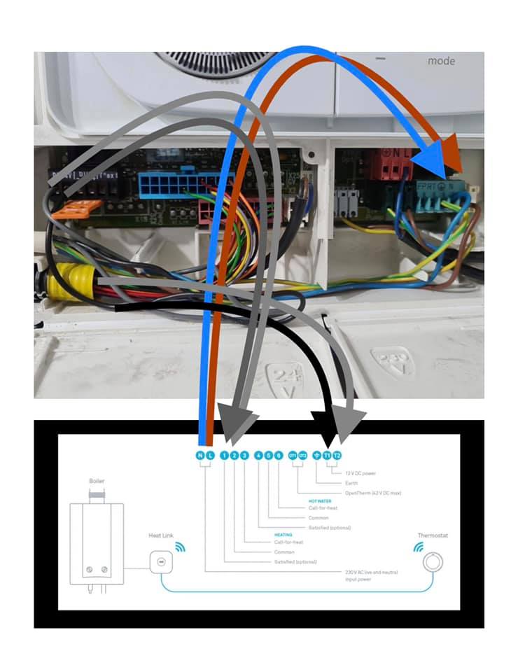

Hi guy's ... yes another newbie with A nest question :sleep:
Searched this but cant find the answer... Installed Nest to my Glow worn betacom 28A and it's all set up but the problem is I think the timer on the boiler, it's not handing over controls to the Nest o_O
Anyone had this issue before?
Edit to say the image attached - the 2x grey wires are going to 2/3

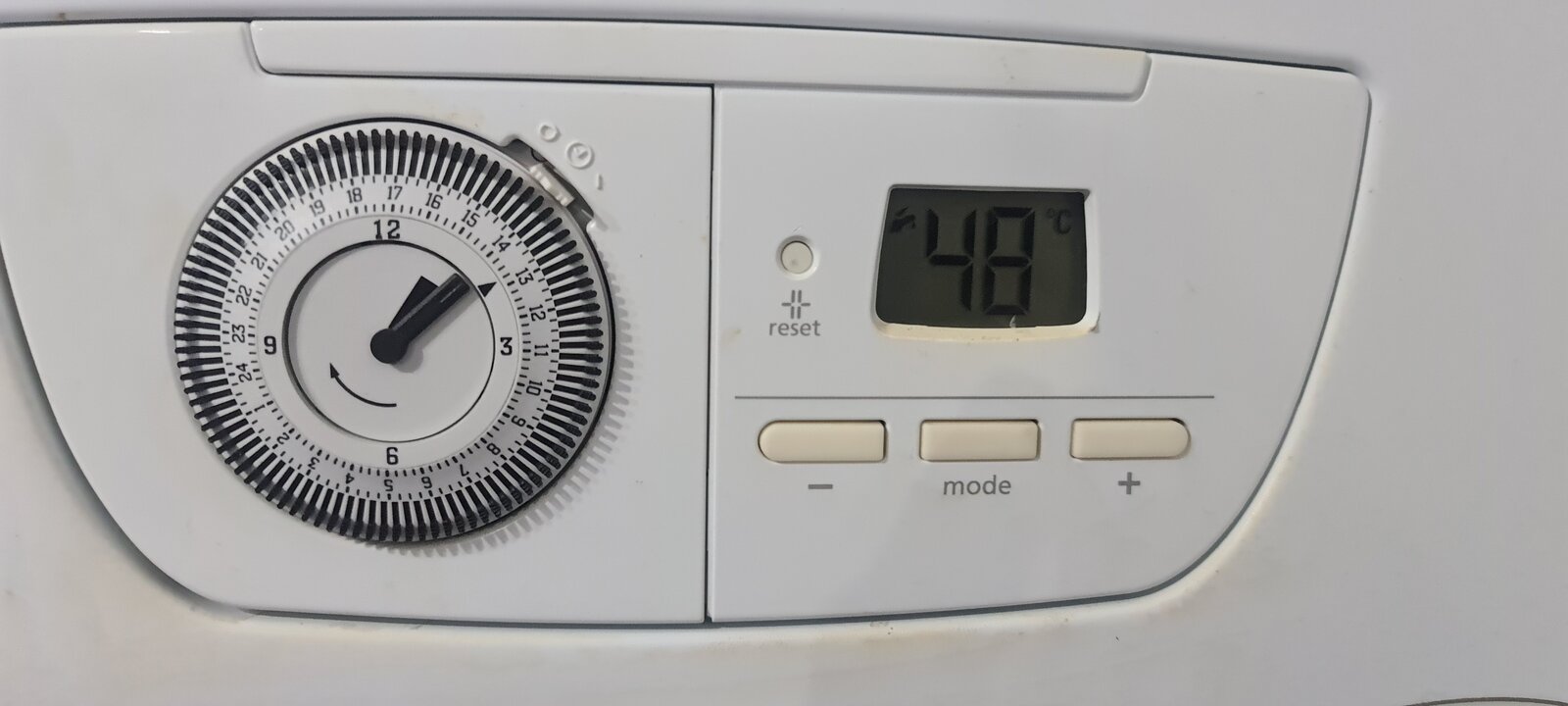

Removed the 24v link ? you should leave the timer on constant and opening/closing the 24v connection should turn the boiler on and off.
Have you removed any old wiring? Are you sure you haven’t crossed the black and grey wiring? Have you checked what status the nest is at? Is it connected via wi-fi?
The wires you have connected to terminals 1&2 on the heatlink have to be connected between 2&3, 1 is not used on your set up as you have a combi, Also as you are powering the thermostat using T1 &T2 your will have to connect an earth wire to the heat link
Yes, should have picked up on this, thank you Ian.
I did edit the 1st post, the image shows 1/2 but it is connected to 2/3... I don't have an earth on the heat link! I'll take one from the JB and add that now...

Put the timer on constant and turn off the heating on the nest , does the boiler stop ?
Your timer is set on timed not constant, you need to click the little switch to I with the little switch, have you removed the 24V link on the PCB ?
