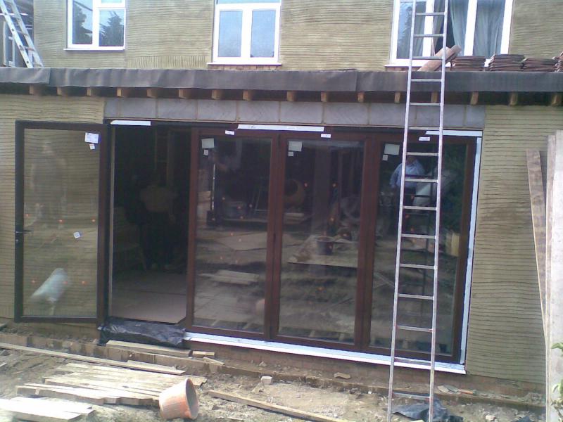

I have the same size opening but I opted for 5 panels in Graphite Grey which look superb.
In the end I chose Aluminium and I'm so glad that I made that decision.
Sunseeker fitted the doors and everthing went smoothly and all for £4000 inc the dreaded VAT.
I'll take some pics and post them on here too.

Unfortunately the prices are still silly at the moment and I had no option but to pay this price. I looked around at so many and was even quoted £8000+ by one company.
One thing tho despite the cost - opening up the back wall and putting these doors in has created the 'wow' factor. Everyone so far who has been into the new lounge has been extremely impressed and said they are worth every penny.
I will try to upload some pics soon.

Sunseeker quoted £5k+vat and that wasn't with the 'Celsius' solar glass which supposedly keeps things cooler when the sun shines directly on the glass.
Looking at it further it def looks like a 'warm roof' they are putting on there.

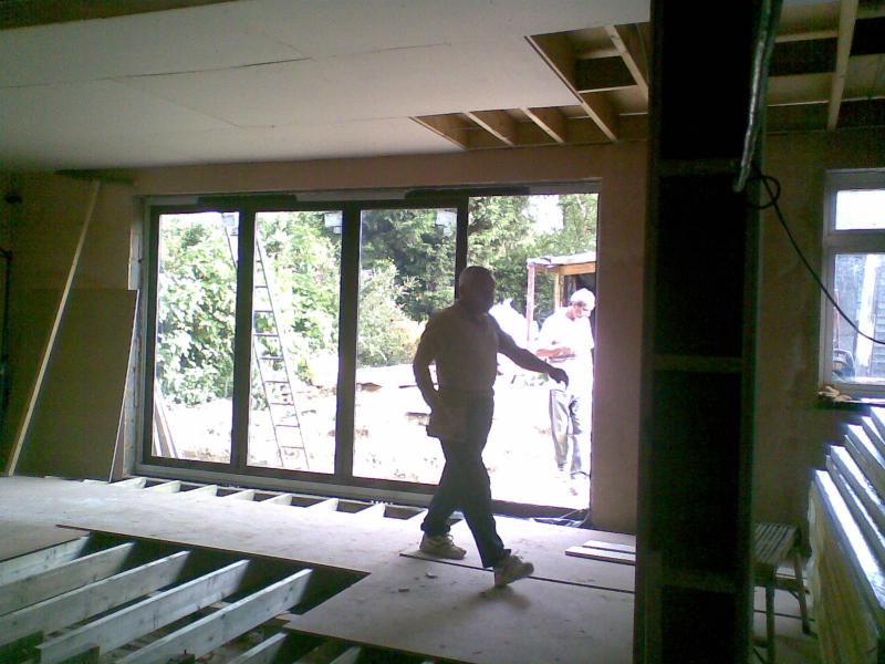

Sunseeker first quoted me around £5000+ so I told them I was looking elsewhere. They soon dropped the price to £3400+VAT fitted. The price also included Argon Filled Glass Units etc.
My Building Inspector also wanted Thermal Calculations because of the amount of Glass Openings now in the room. Luckily for me with a 39sq room the 8.1sq doors are within the 25% limit.
Hopefully I'll have my extention finished within the next couple of weeks then all the dust and mayhem would have been worth it!

Good pics you have there - it looks like you've have created that wow factor to your house.
