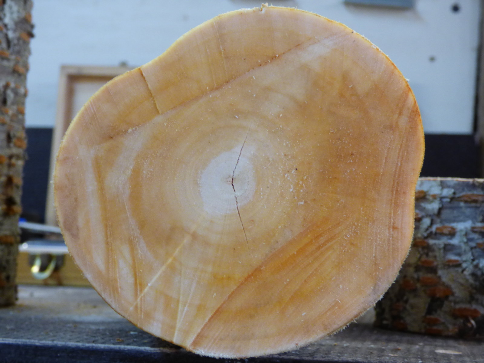

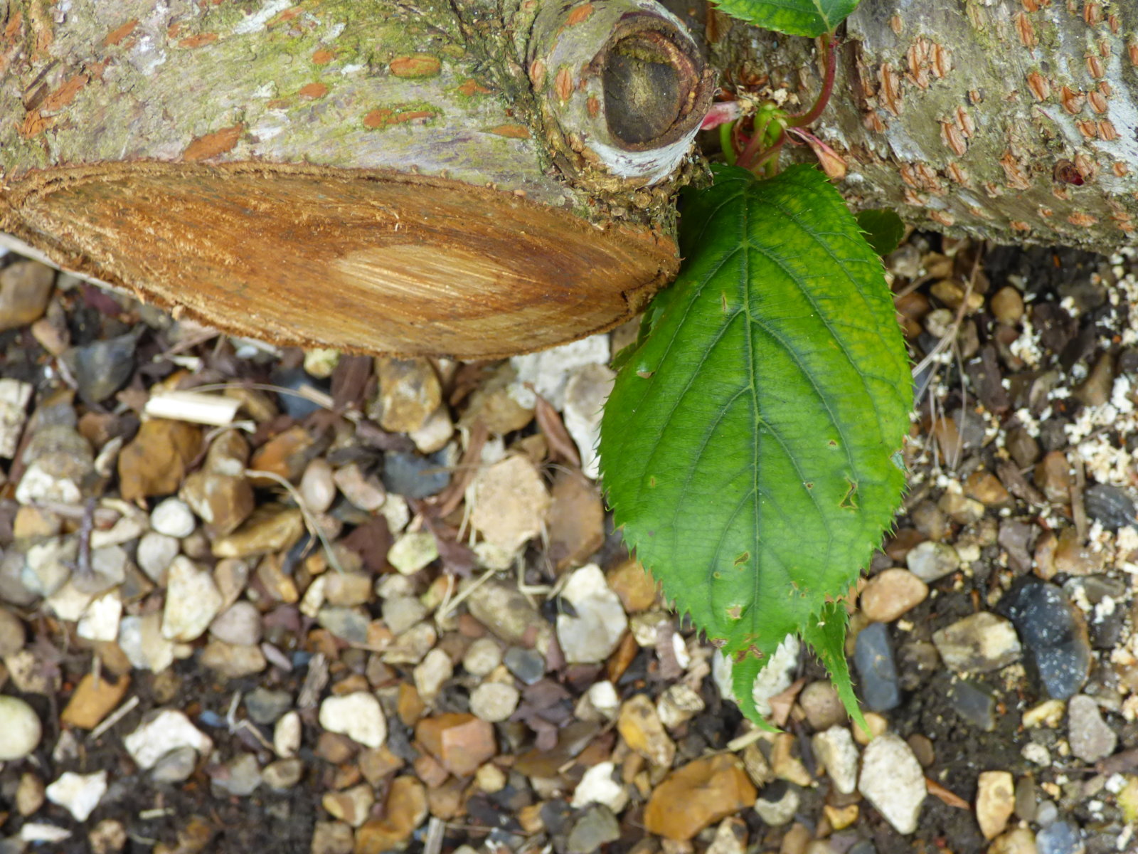

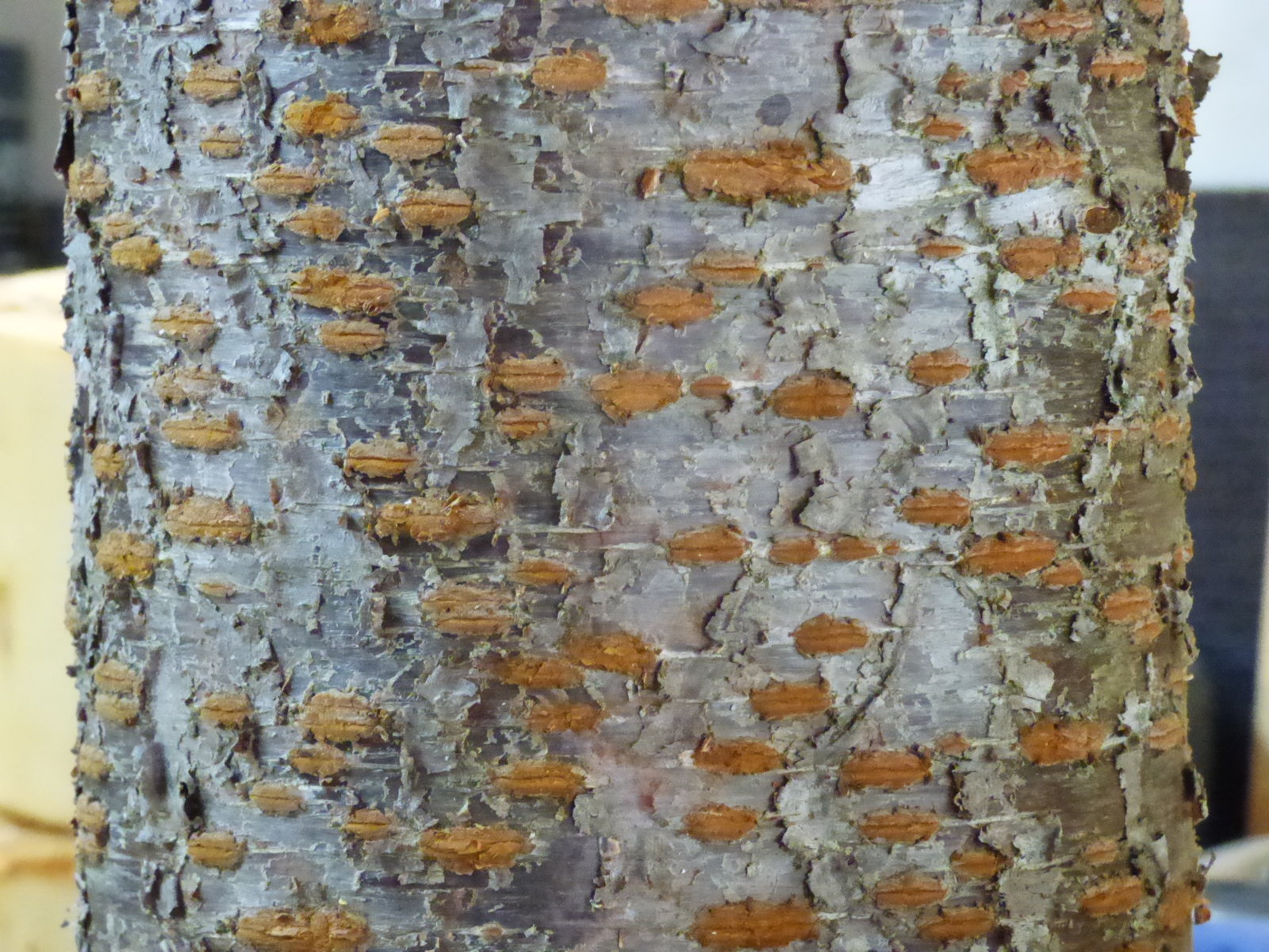

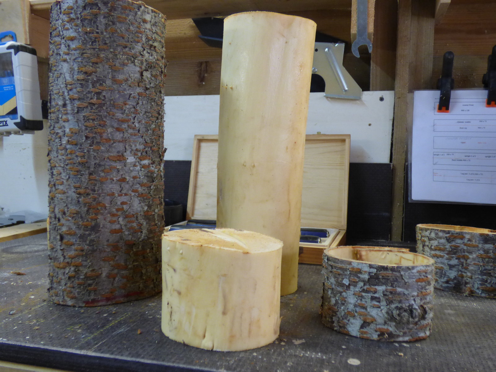

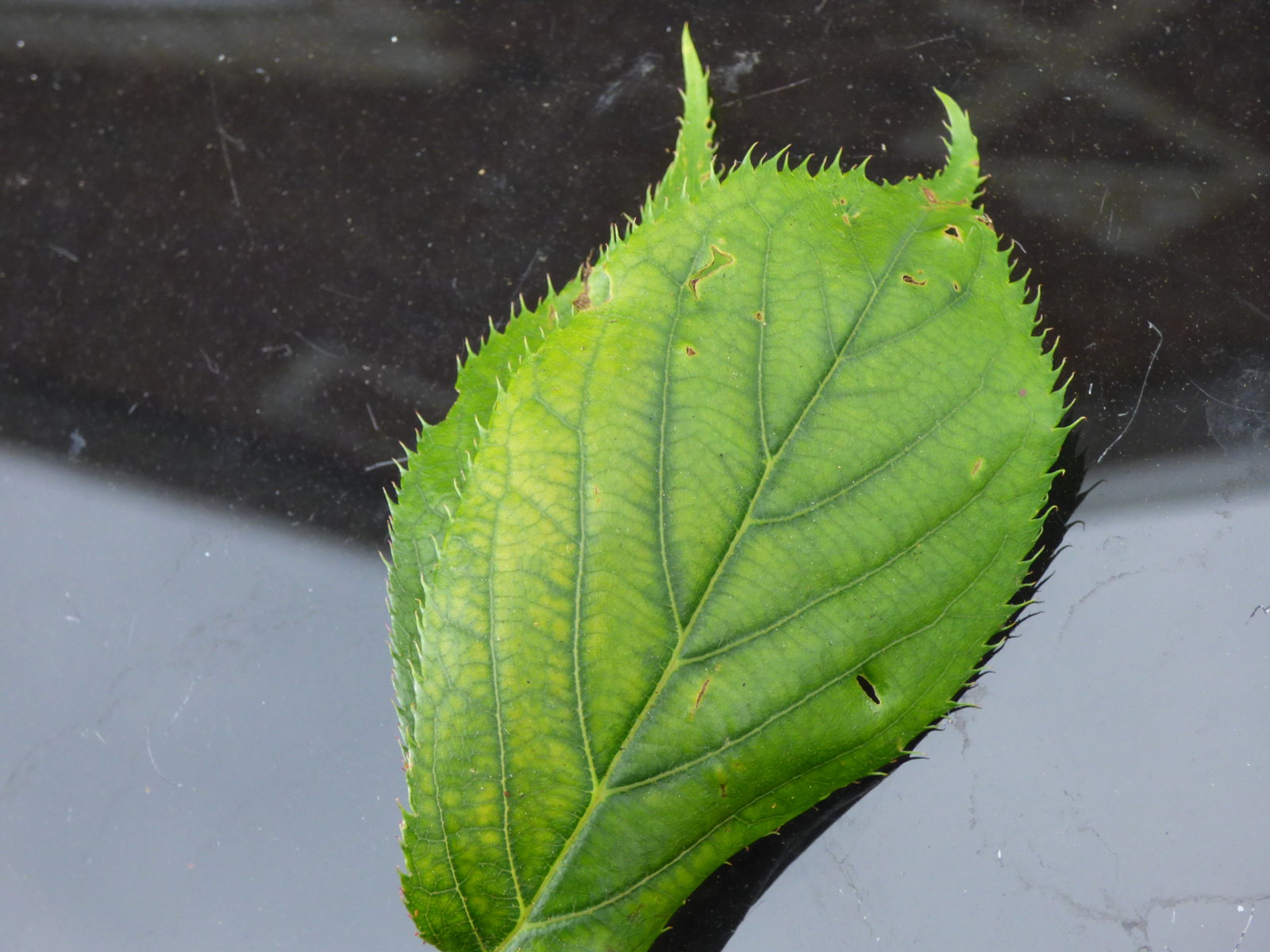

Dragging this back to the top because I want to know if anyone can clarify it is a Bird Cherry tree that I cut down.

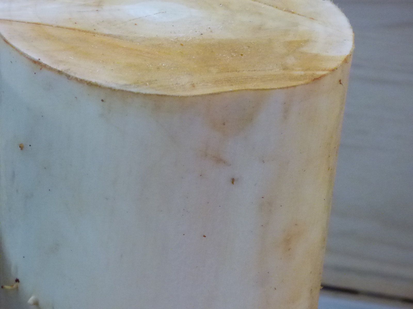

I've stripped the bark off a couple of sections so the photo's show the bark and the sapwood(?).
It's very wet even though it has been under cover since cutting it down so I don't think there is much chance of machining it at the moment.
Can anyone agree/disagree what it is please?
Ignore above. Just found bark pictures and leaf pictures to confirm it is a Wild Cherry tree, sometimes known as a bird cherry because the fruits are inedible to humans.
