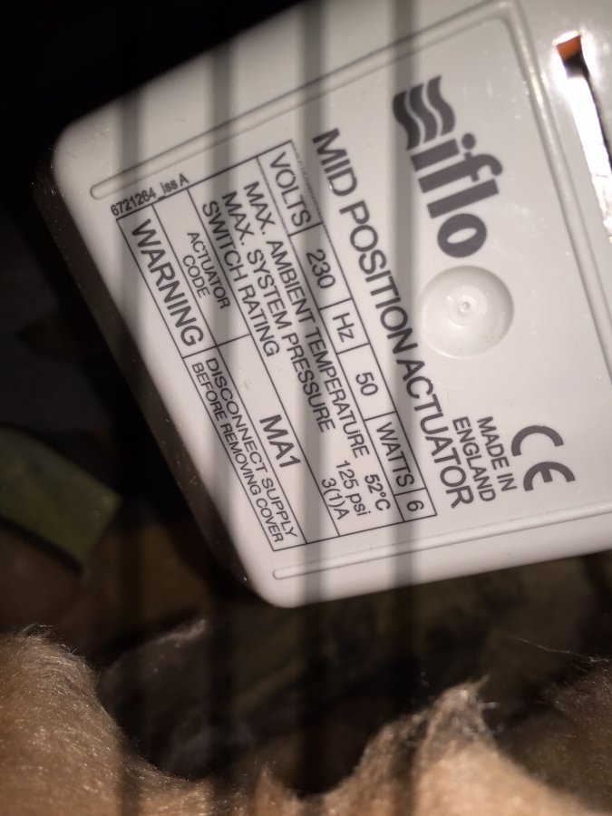

I managed to find the "iflo MA1 Mid Position Actuator" motorised valve in the loft, wiggled the levers sticking out of the side of it, and hey presto hot water is now passing to both the hot water tank and the central heating. Turned the stat down on the hot water tank to make sure that the CH works independently of HW.
If that's a Drayton MA1 valve , change the actuator. 5 wires to connect and the head just clips on to the valve
It's an MA1 for sure, it's looks very similar to the shape and size of the Drayton MA1. I'm guessing that Drayton merged with iFlo at some point. Because of where it's installed in the loft floor this is the best shot I could get..
