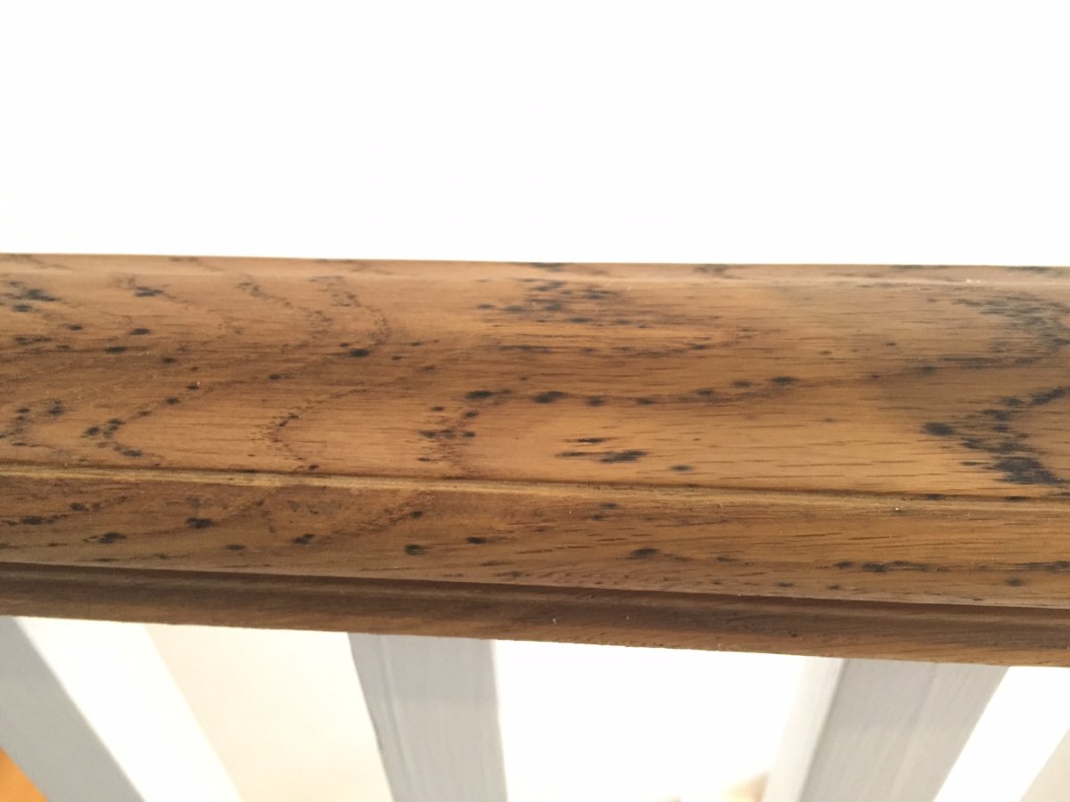

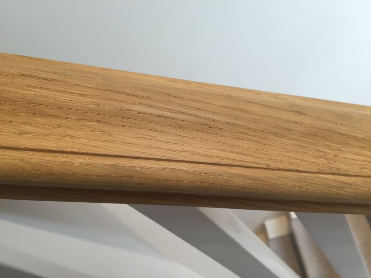

I applied Ronseal's exterior wood protection on an Oak wood surface because the builders left a small piece of the staircase untreated (and stupidly, I decided to fix it) and after a few days, some black spots formed (see pictures: first picture is after the application and second picture is what it should look like...). I gather I used the wrong treatment.
Is there any way I can get rid of the spots and what kind of oil would be best to apply? (Danish Oil?) I sanded down the surface a little but the spots seem to go deeper.

did you use wire wool/brush ??
tannin in oak causes black when reacting with steel
I think I used a regular brush (pictured). Any way I can rectify this? Or do I need to get the builders to replace the whole part??
be aware of the fact that bleaching may cause the surrounding unstained wood to lighten up as well, creating a donut halo effect. To prevent the halo, you might mask off the first 6 inches around the stained area or apply a bit of new finish there (that may be sanded off). Although you might try bleaching with peroxide, I would advise against using Clorox, because it damages the wood.

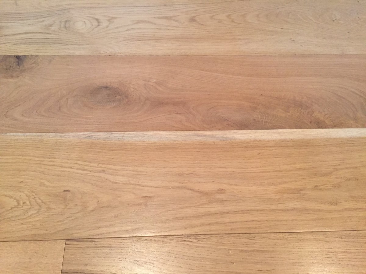

The builders used Bona products I think. We have lots of oak (including engineered hard wooden floors are also from oak) and it seems to be difficult to find the right products to treat/protect it without staining it. There are a few bits which show slight discolouration (see middle of photo, it's grey and looks as though the treatment has worn off or never been applied properly). It's been about 3 years since the floor has been installed/treated.
You could try oxalic acid which is specific for the black marks caused by iron stains in oak. It's also good for removing rust stains from most surfaces.

I see no reason why that would be organic growth appearing after a couple of days just because it has been varnished with ronseal.
As Big Al says that looks like iron reacting with tannins, are you sure that there hasn't been any iron involved, grinding nearby or anything like that or a rusty ferrule on the brush.
oxalic acid should remove it if that's what it is
