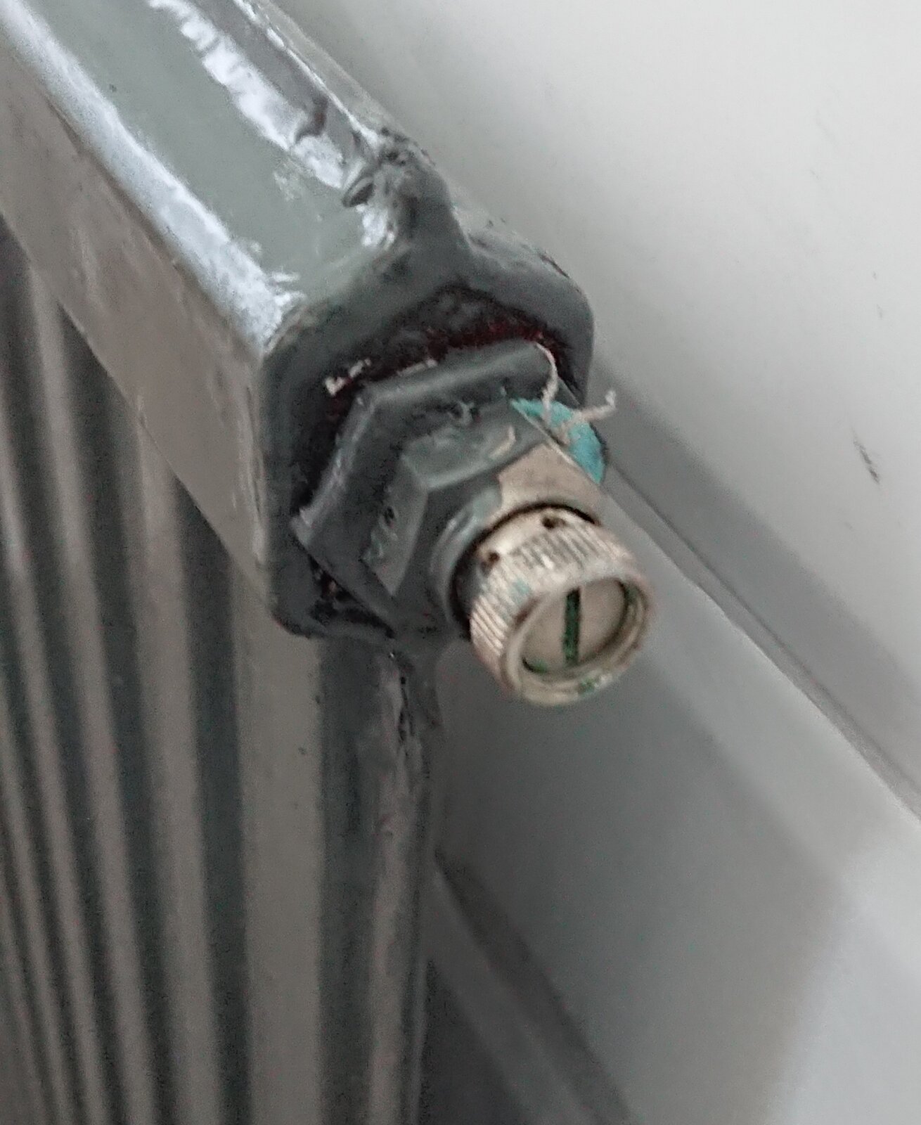

Can someone advise how to bleed this type of radiator please?

Use the slotted screw head ,wide bladed flat screwdriver on it ,whilst holding the knurled nut ( with grips if necessary ).
If the system is sealed / pressurised you may need to top up. If fed from an f&e tank it will top up on its own.
