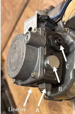

Hi Folks, I need to run a new oil flexi-hose into my Firebird oil boiler and will likely need to bleed the supply. I'm just not sure where to bleed air from - any views on whether it's A, B or C in the diagram please? When the unit is fitted back in, A is underneath (next to the line in), B & C are facing out. If I bleed using A or B, can someone also advise on what C is/does please?
Thanks in advance.
The one you tagged B
A is return port
C is pressure adjustment don't touch without a pressure gauge Connected to B and combustion analysis equipment to make sense of any adjustments.
