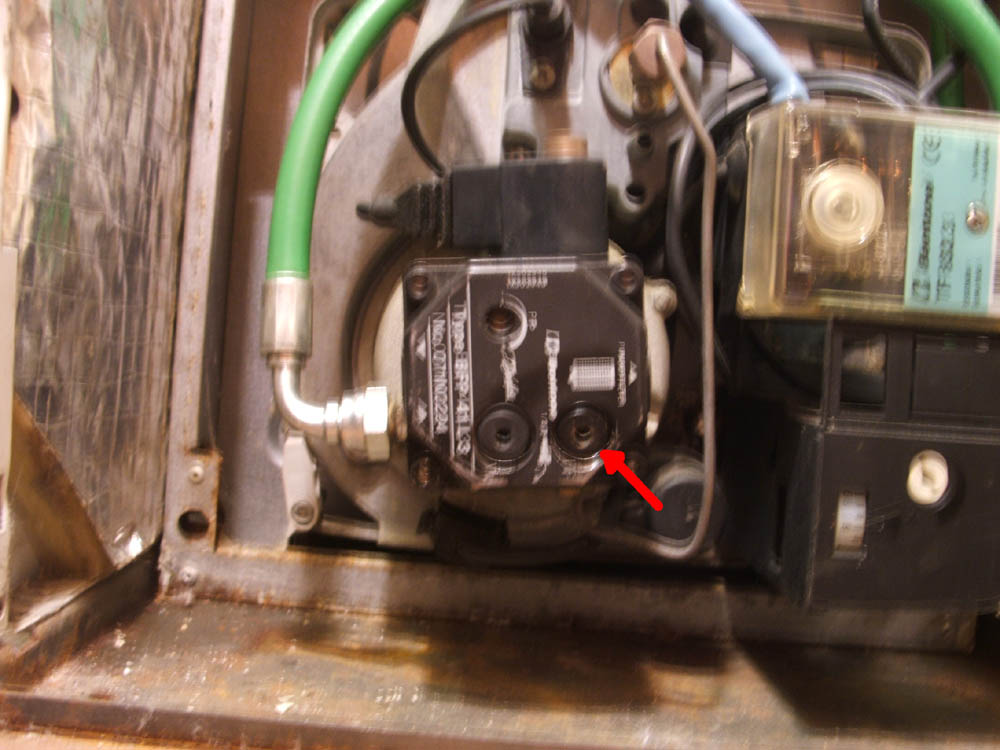

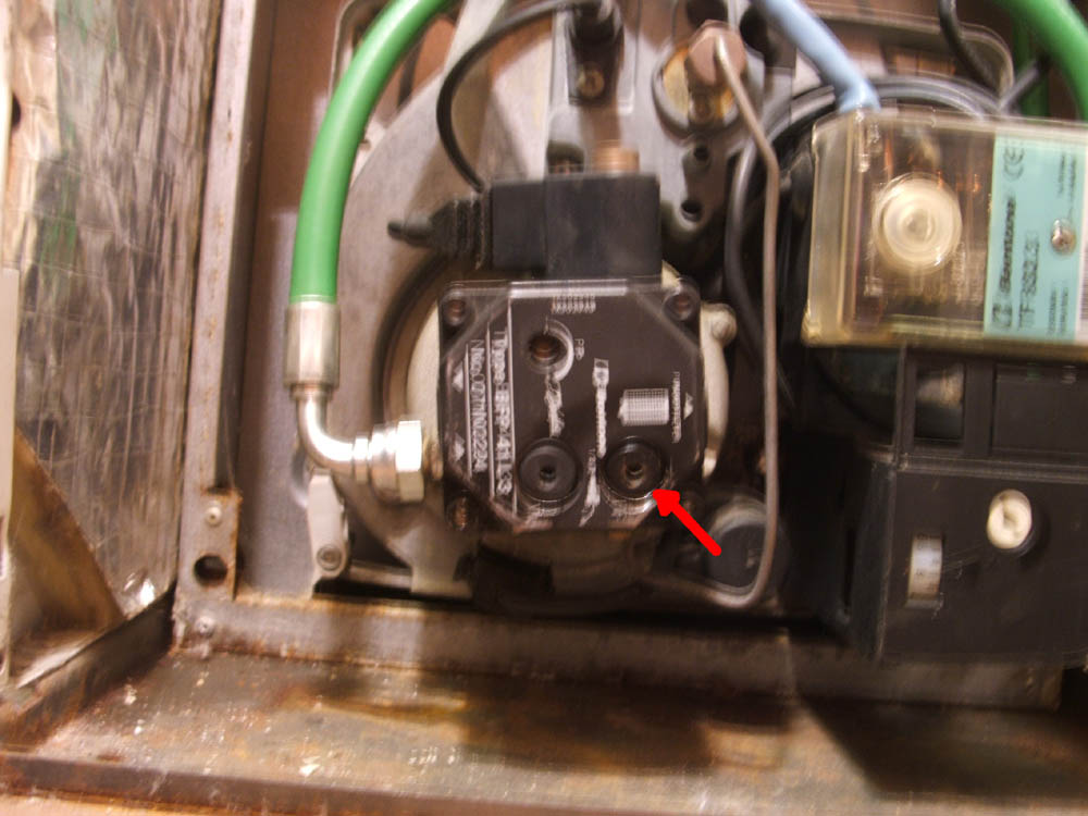

Hi m8,
Oilman is spot on, the are two P you want the 1 at the bottom right hand corner, the better way 2 do it is press them timeout button while everythink is switch ON... then graudally and only just a little undo the plug with a allen key and u will see some bubbles and oil come out, do it back out then undo slighty once more, and presto u have heating.
Can't thnak you all enough..saved me a call out charge..I know the thread started long ago but I soon found it when I let the oil run out and then it wouldn't start. FAt first I didn't even know what the oil pump even looked like...and was a bit worried about all the "P's" to choose from, It worked. It's single pipe feed and nothing would come out with everything off. So I tried chriseveo's method with the boiler "attempting to run. (lockout reset) It took three goes to stop bubbling..Then success..For other dumbos like me here is a photo of the plug that bubbles..Thanks again.
