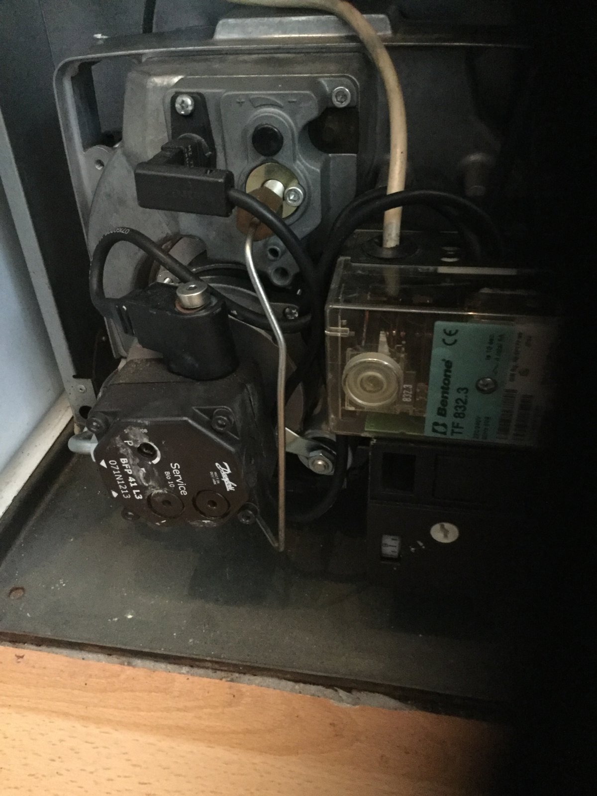

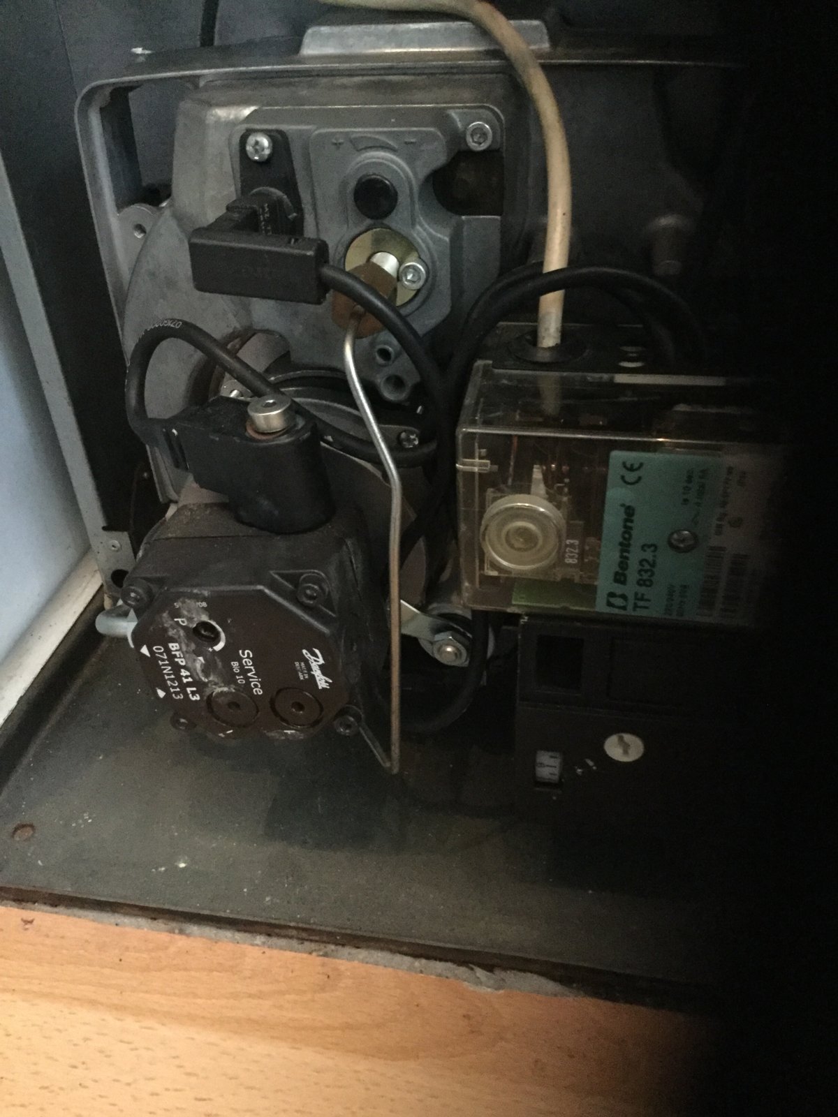

We stupidly ran out of oil in the cold weather on our oil fuelled boiler. We’ve now refilled but the boiler won’t start and googling would suggest the boiler needs bleeding. We have a danesmoor electro oil inter b9b burner and the instruction manual is no help, just says to call an engineer. Any suggestions on how to go about this grateful,y received, thanks.
Loosen the Plug P at the bottom RHS of your picture. DO NOT touch the screw marked P with the graded scale around it.
