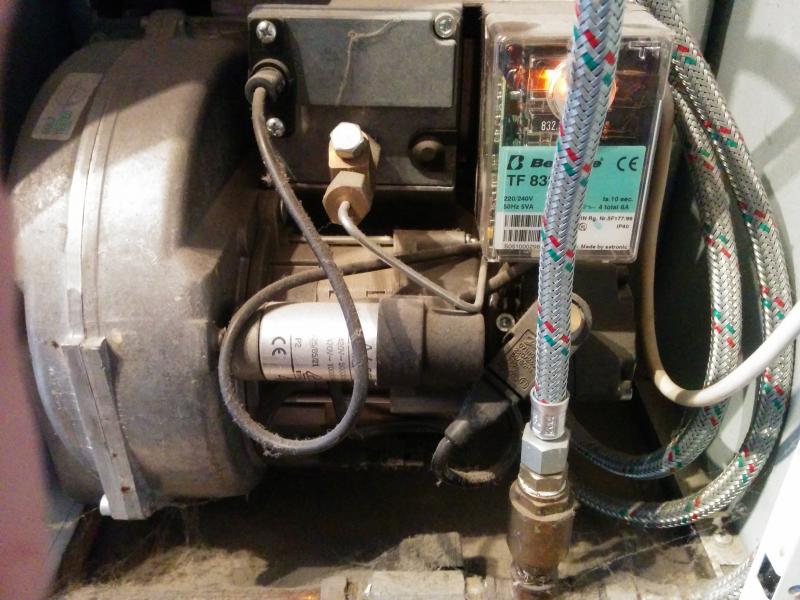

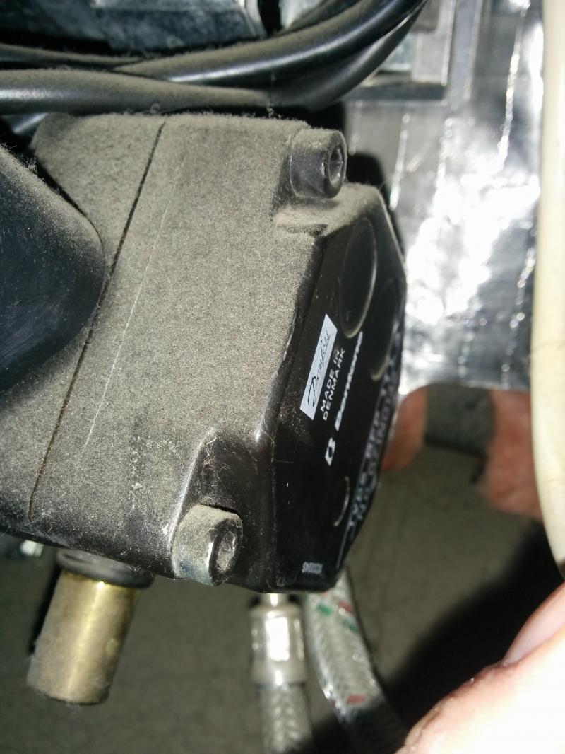

Is it possible for you to give us a couple of pics, Jim.....one of the pipe arrangements going into the pump, and another of the pump end face?

Here are the pics. The boiler enclosure prevents a full shot of the pump end face, but the three ports are definitely blanked off!
Looks like a BFP 11
The pressure Guage port should be above the brass pressure adjustment fitting. Use this to bleed the pump
Bled, and now working. Radiators are warm, family is happy.
