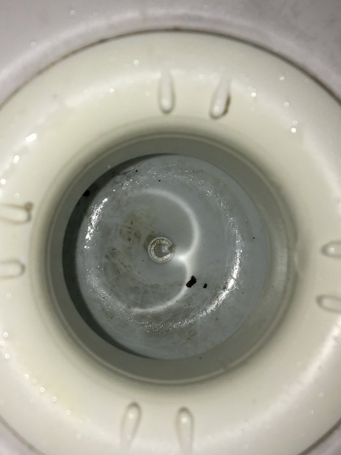

We recently moved house and the shower is blocked. I can't find the drain hole - please help. I've attached an image. Thanks

Thanks for your answer - can you explain how I can get to the drainage hole to unblock it - thanks in advance.
Does the shower waste come out of the exterior wall, with its own pipe? Is there a cleaning access eye on it? That's where you should look first and see if you can unblock it there. The other thing to try is a plunger - if you don't have a wet vac.
It's a top access shower trap & you may not feel the outlet from above. Blast it with the shower hose with the head off, then plunge it with a sink plunger.
That should do it.

Can you get the water out of the waste connection and post another photo.There may be a pull out part lower down.
photos of the run of that pipe could help.

Can you see with a torch into it and is everything you see clear?
Have you actually tried a plunger?

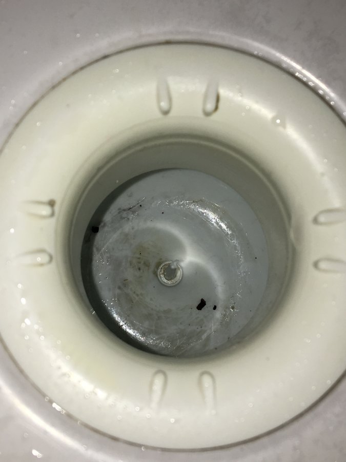

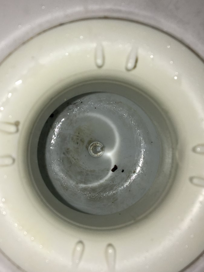

Thanks for all your advice. There isn't an external wall pipe - it sounds like the water goes into the the toilet waste pipe. The bathroom is fully tiled. We tried a plunger but don't want to chance soda. Have attached another image without water to see if anyone has seen one like this before. Thank again

As I said, it's a top access shower trap, like a bottle trap. You'll likely not see the outlet.
I hope the waste pipe is clipped & the correct gradient. Plenty water & a plunger. Easy does it.
Thanks, PullerGas. I've used bicarbonate of soda and vinegar, then hot water and plunger. This seems to have worked so will try it out later. Thanks again to all. Chris
