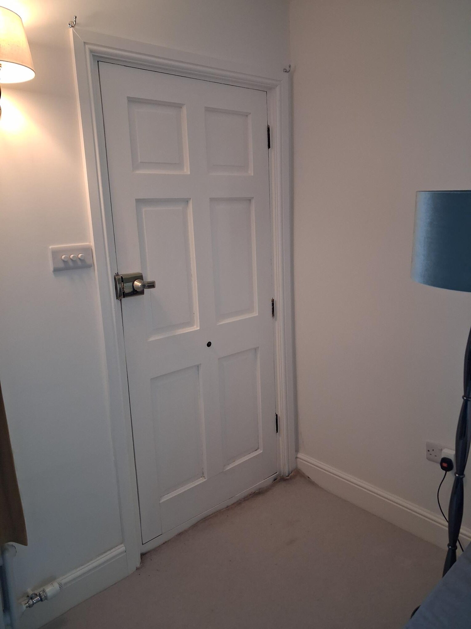

I have an unused external timber door set in a single-skin Bath stone wall. I’m in a conservation area, so I can’t change the external appearance.
The door is very draughty (significant gaps between the door and frame), and I get condensation forming on the inside and dripping onto the floor.
The rest of the house is also single-skin stone, and a couple of years ago it was internally dry-lined with plasterboard (dot and dab).
I’d like to block/insulate this door from the inside only.
Constraints:
  • External door must remain in place and operational (locked) for insurance purposes
  • Ideally a reversible solution (so future owners could reinstate the door easily)
  • Door is uneven/warped with a protruding latch
Proposed approach:
  • Fit PIR insulation board internally over the door (or within a simple timber frame)
  • Seal all edges with expanding foam / foil tape
  • Finish with plasterboard or OSB
Questions:
  • Is it better to fix insulation directly onto the door, or build a small stud frame?
  • Should I fully seal behind the insulation or allow any ventilation?
  • Do I need a vapour control layer, or is foil-backed PIR sufficient?
  • Any risks of trapping moisture/causing damp given the existing dot-and-dab walls?
  • Best way to deal with the latch and uneven surface?
Thanks in advance.
I'd be more focused on insulating the door rather than boxing it in. You risk the door rotting. Have you tried all the usuals like draught excluder or even a curtain over the door?
I wonder also if it would be possible to place a removable hood on the outside of the door, made to look like a door.
