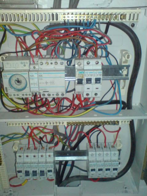

Once again, apologies for the awful focus. Sometimes my cameraphone is pinsharp, other times, it won't focus for love nor money. Still, that's for another forum...!
The enclosure is actually one piece, a Hager twin din rail enclosure. It's fed from a C32 3 phase MCB from an adjacent Square D DB.
It's a real mess, as you can see. There are SWA's just lying around in the board, not terminated correctly.
But as for the main reason I posted it, Col is quite warm!
Can you see through the poor focus to the problem?
its being used as a 3 phase board? top, bottom right and bottom left seperate phases?
Hard to tell, but are the two reds on the two bottom left MCBs part of the same cable (i.e. some twin red). Two circuits in one cable? Surely not?
It looks to me like a T&E with the CPC sleeved red. The line, neutral and CPC look to be connected to an MCB each :shock:
Crikey! I did consider that black being in the same cable too as RF pointed out, but thought my suggestion of twin red (with CPC cut or disappearing out of sight somewhere) was terrible enough and surely it can't be that bad! Thought it was too silly to even suggest. Can I get the prize anyway?
