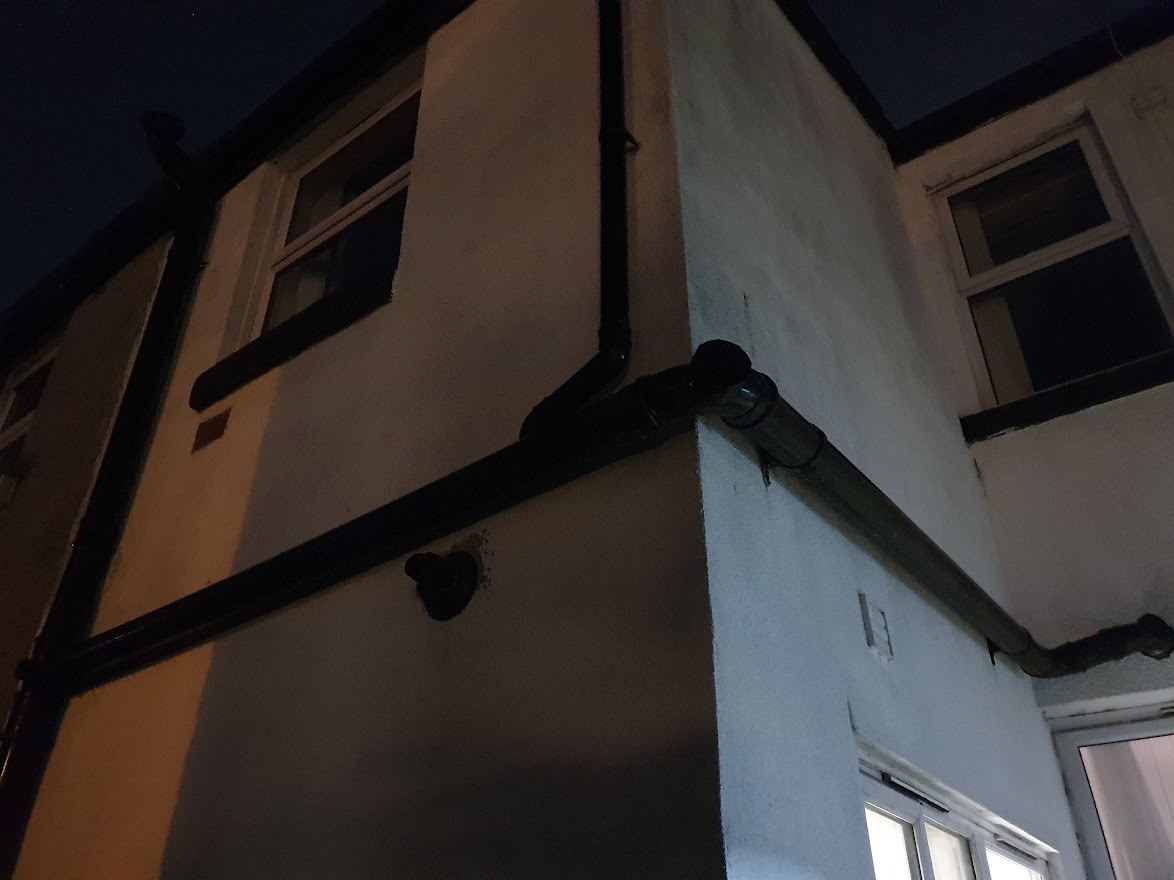

Out of interest (there doing other jobs), is this acceptable?
Looked online, it seems 75mm beneath pipework is ok.
I just wondered if the pipe will get damaged over time.

Less than ideal- you'll probably get condensation dripping off that gutter. Check the MIs again- 'pipework' isn't the term normally used for rainwater goods.
Might need a better photo, but regards clearance you need to check the boilers mi’s.

Wasn't really the rainwater goods I was thinking ... more the toilet waste, although I guess there'll be condensation off that also.
I agree, but the thought had entered my mind, is three (at least) 90deg bends with such little fall acceptable (there's another 3m out of sight under the floorboards before the bathroom) (?)
What fall andwhat length. There are recommended gradients and max lengths
I really couldn't say, only what you can see in the picture, and probably three metres under the floorboards that I suspect may not have any fall to speak of.
