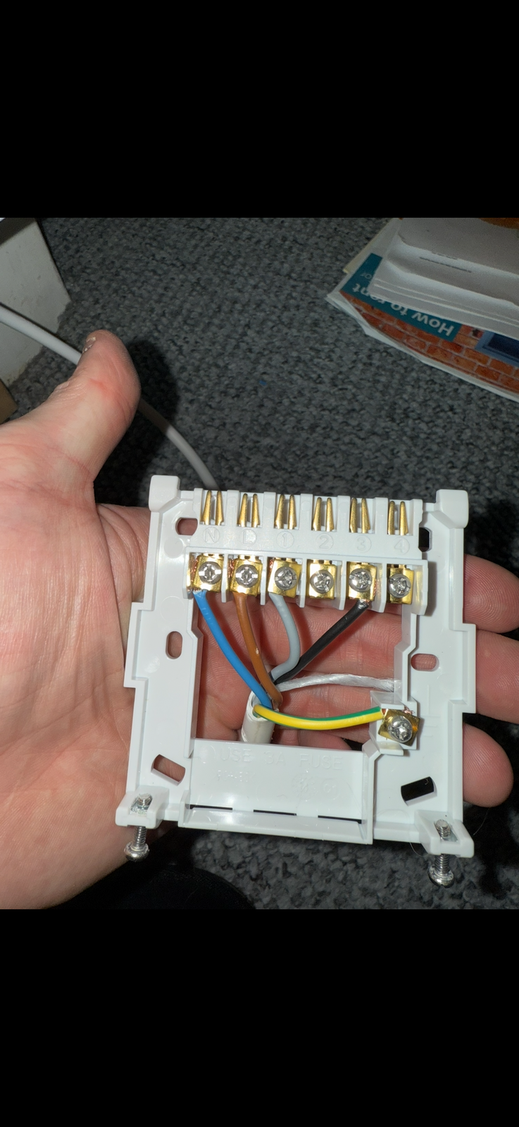

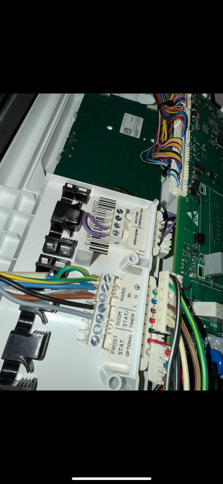

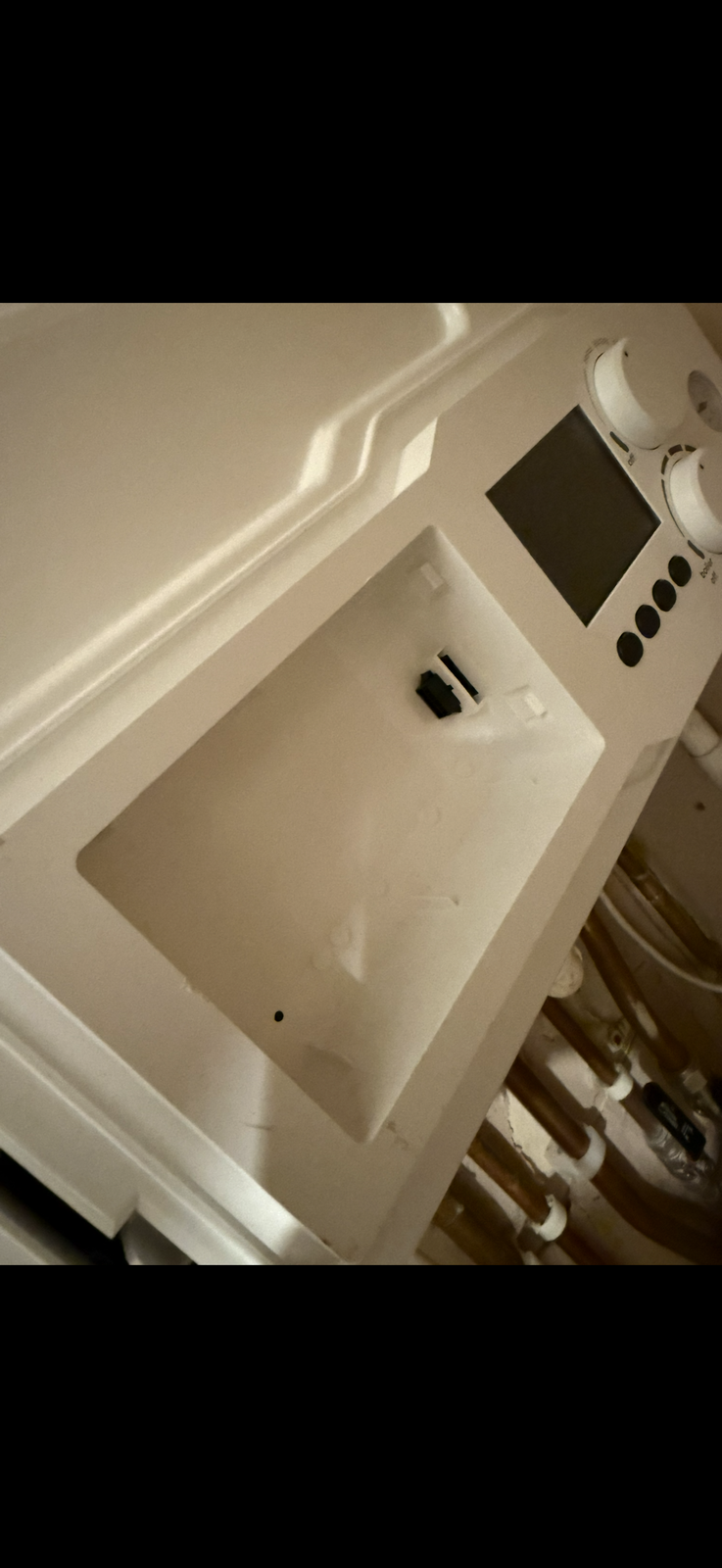

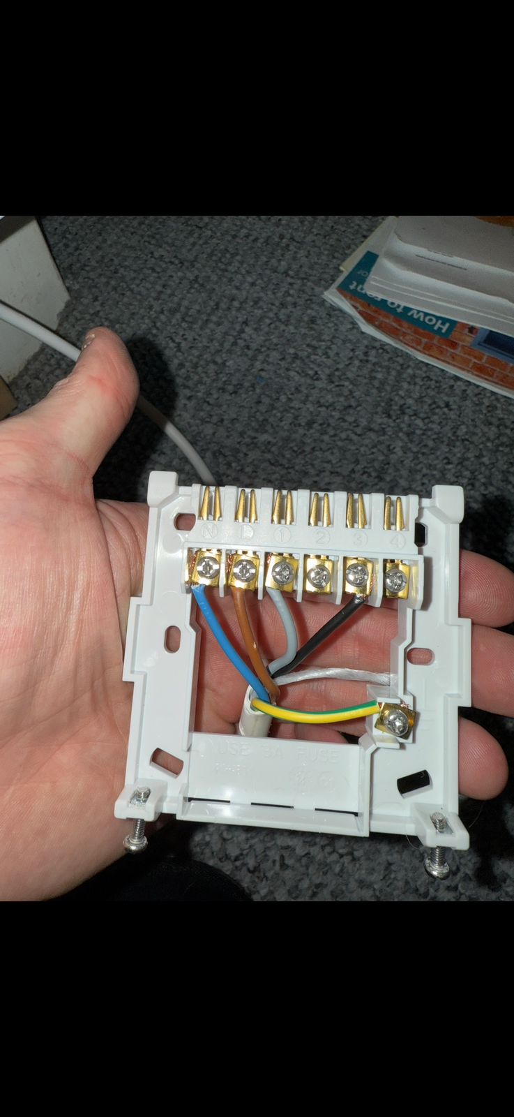

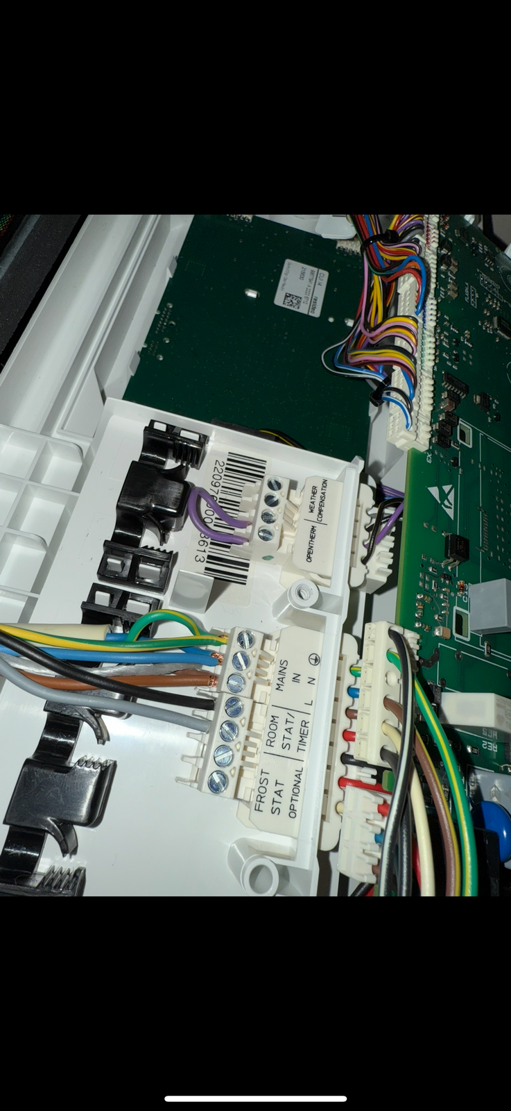

Hi all,
Nice to meet you.
I’ve just bought a hive thermostat. Followed along and wired it in, it connects and when I press heat it turns the receiver green… the bad part is it doesn’t actually switch the boiler on?
It’s a vogue max combi 26.
It used to have a salus open therm which I have unplugged….
The copper showing has been sorted, rewired it after.
I have wired it up (attached some pics)
Wondering why it’s making the receiver and app act like it’s heating when the boiler is still just off?
Thanks,
James

The receiver is a RXBC5V
And thermostat is RT510TX

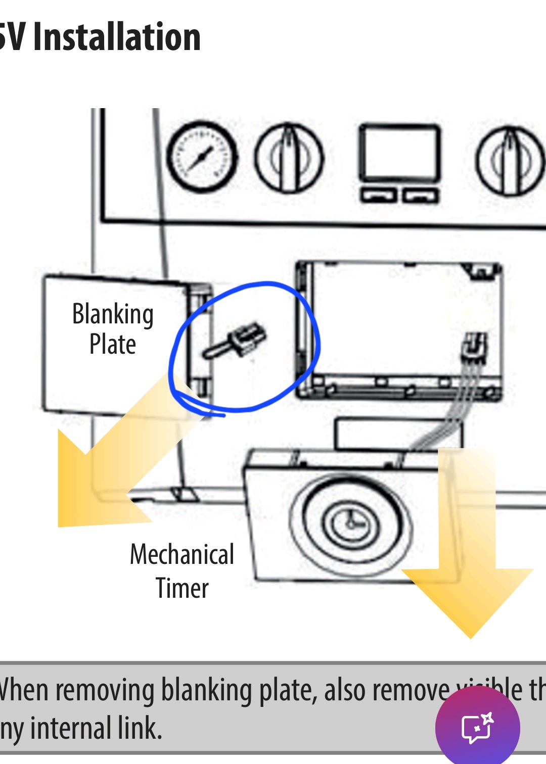

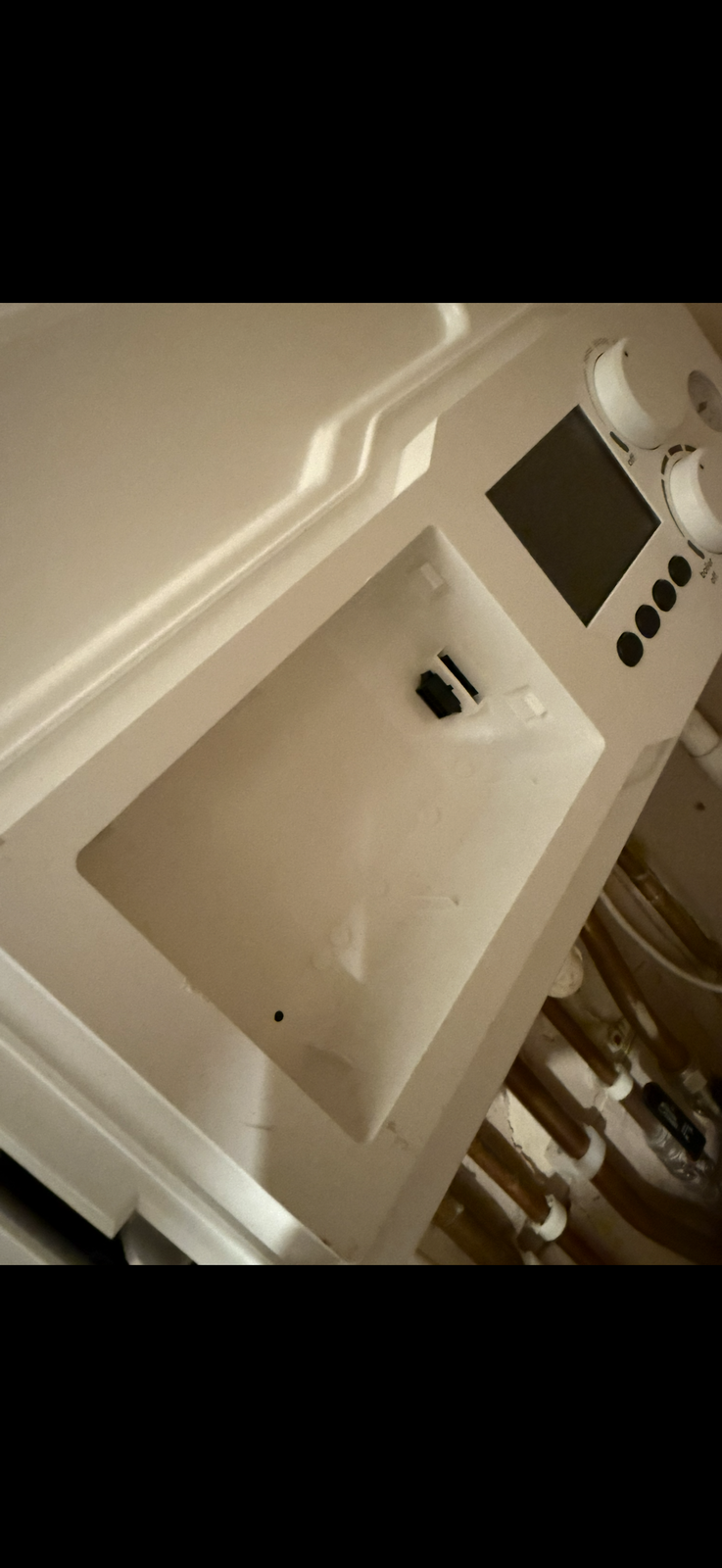

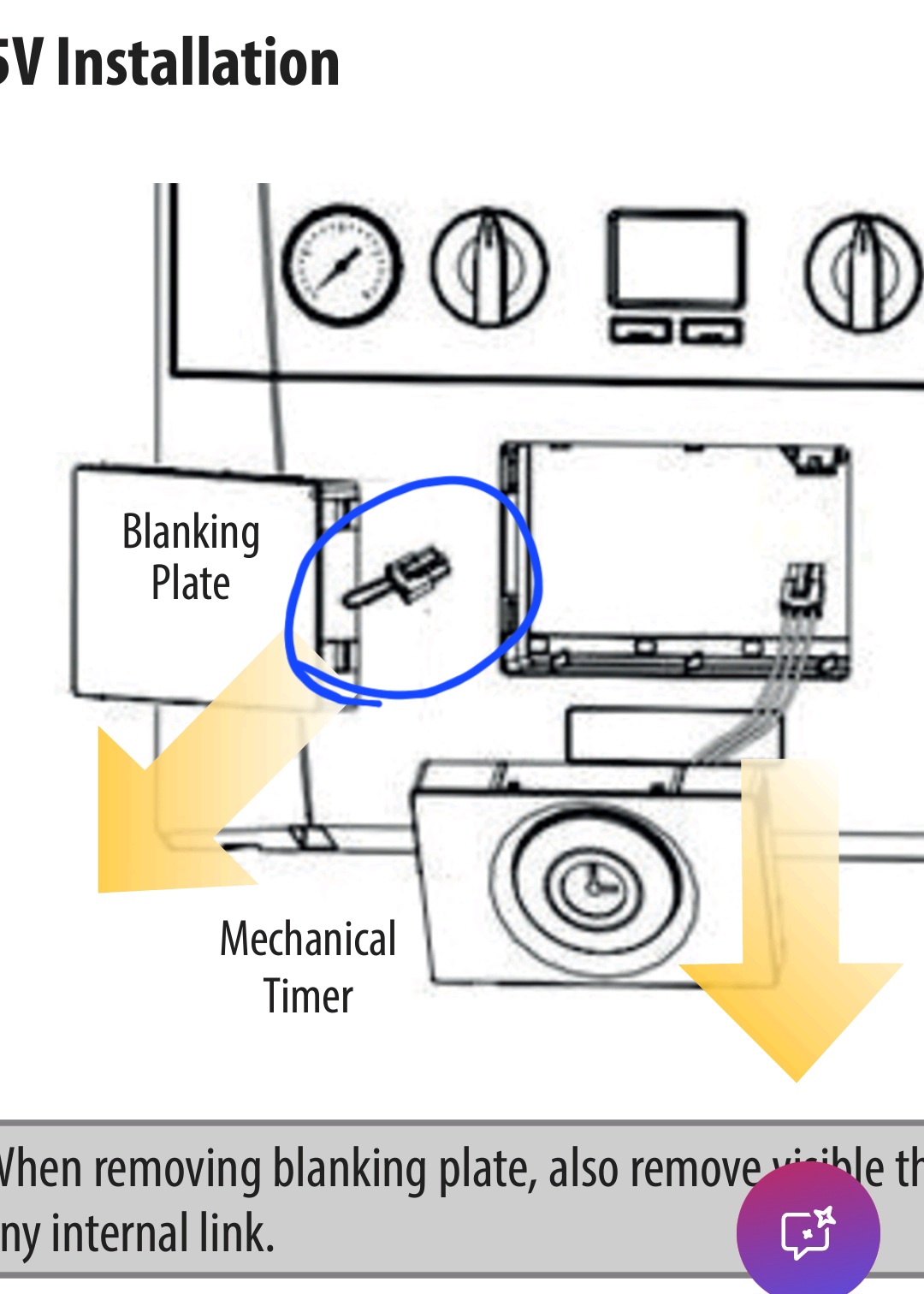

As I thought.
When the Salus receiver was installed, a link plug was removed.
If this is missing, the internal opentherm circuitry isn't completed and without that, a mains thermostat can't operate.

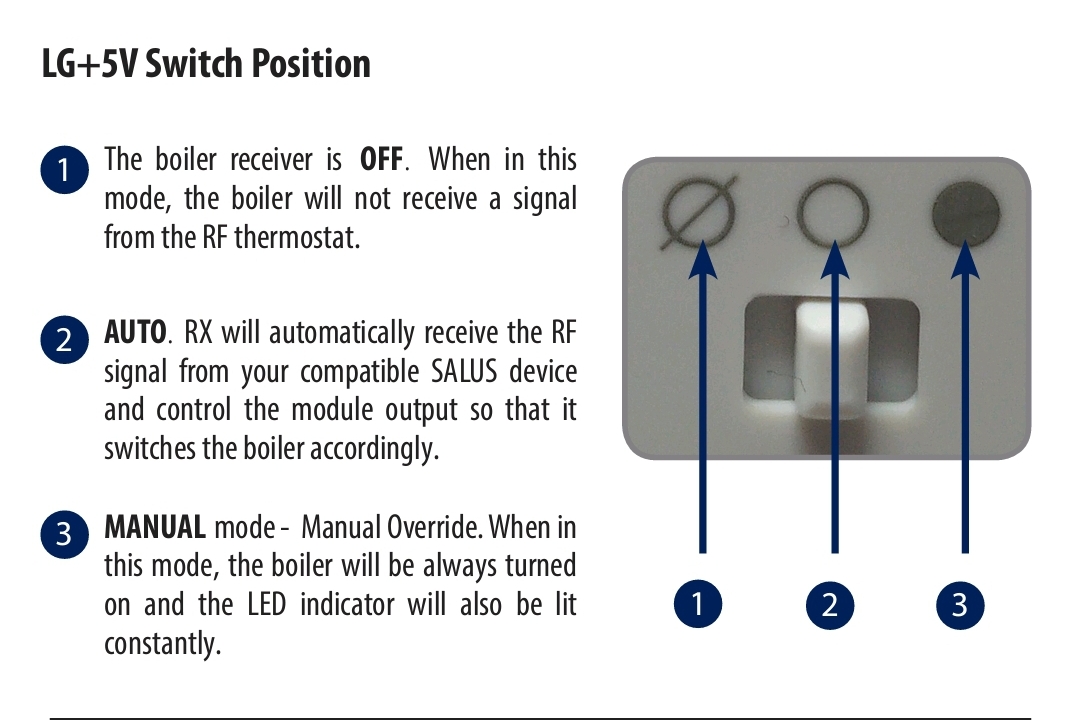

Try plugging the Salus receiver back in and turning the switch to manual...

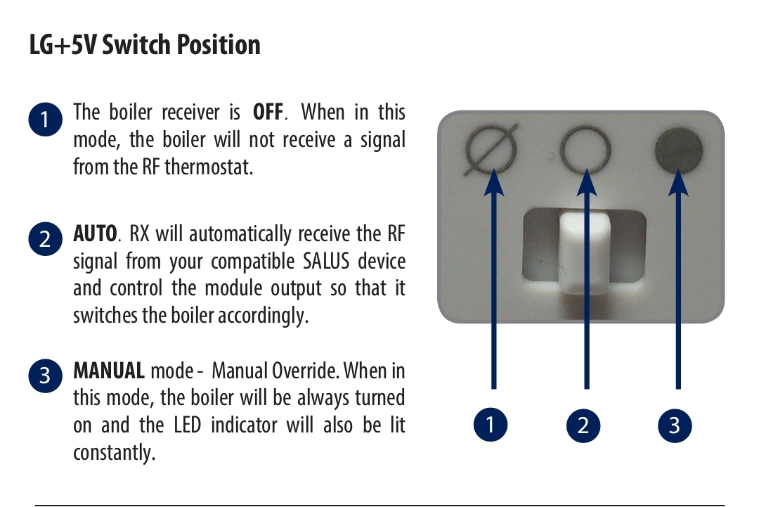

As I thought.
You my friend are correct!
In manual mode it works. Can’t believe I’ve wasted hours and it was that simple.
