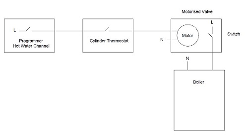

If it is just a microswitch failure then whilst that would start the boiler running, the hot water wouldn't heat up because the valve would still be shut. For the water to heat up the valve would need to be powered such that its motor it winds it to the open position and keeps it there allowing hot water from the boiler to enter the hot water cylinder.
So, I would be looking to see where the motorised valve is getting the power from that's operating the motor and winding the valve open. This is how it should be connected:
I came across an installation with the same fault. It had a frost thermostat that had been connected to the wrong motorised valve by mistake. Instead of switching the heating on it switched the hot water on; usually in the middle of the night when the temperature had dropped to the lowest point.
However, I see @oldbutnotdead mentioned a frost thermostat and you've not commented on this. So, if you don't have a frost thermostat you can ignore this last bit.
Another possibility is that the hot water channel of the programmer is faulty and permanently 'on', often caused if someone has created a short circuit at some point. Then in the night when the hot water cylinder cools, the cylinder thermostat operates and opens the motorised valve.
