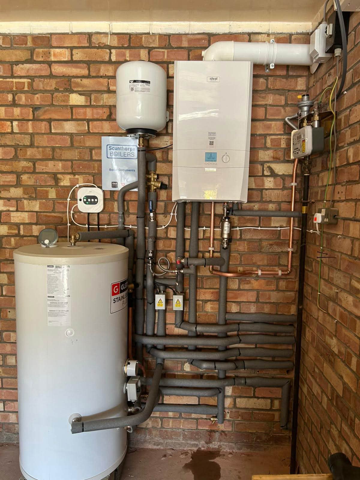

Facebook advert looking for work comments on install?
Cable touching gas pipe instead of 25mm away, drain off appears to be leaking and hard to tell but flue looks like it’s running down slightly. Probably seen worse.
