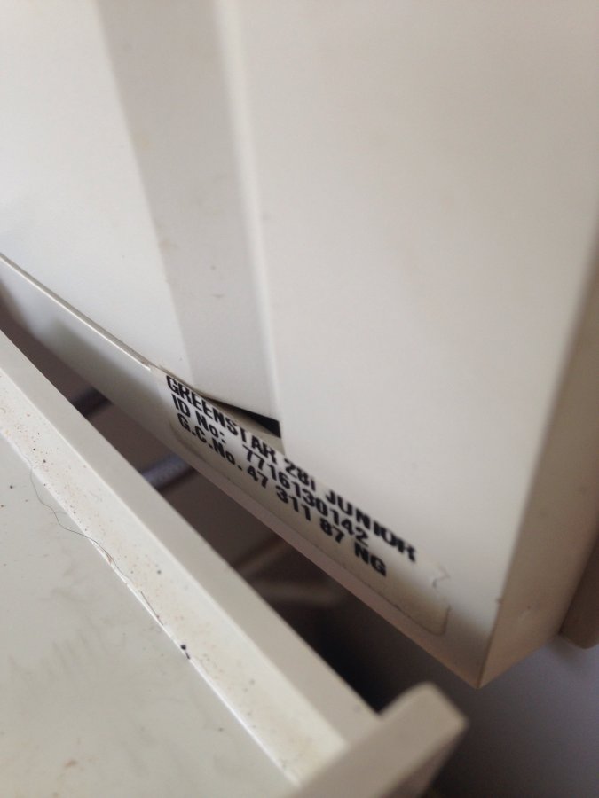

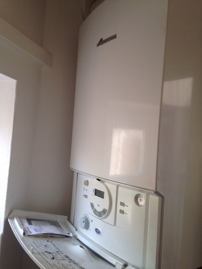

I think maybe you need to clarify exactly which boiler you have, as people here are getting their knickers in a twist over whether you have a condensing or non-condensing version. A picture will help
Here we go
You caused feckin mayhem on this thread stormer. :LOL:;)
just kidding "greenstar" was the magic word.
op, everything after the second post is irrelevant.

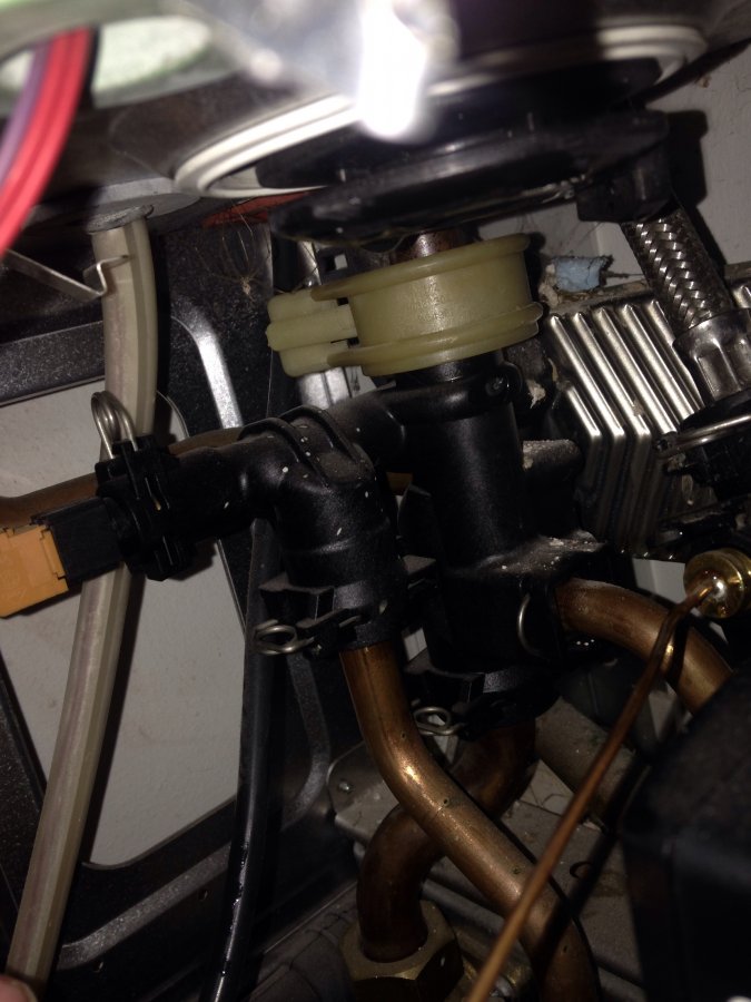

decided to turn it up a bit first of all it didnt fire at all even though the wireless stat (digistat) said it did. so i reset it again, it fired and run whilst luke warm only again, when it starts the boiler fires up fine and its red hot through the flow for a second or 2 then the boiler slows to this luke warm bit (does this rule out the diverter)
i messed with the radiator temp a few times and finally got it to run hot
any ideas. its not such an issue this time of year im dreading any cold weather already
The boiler runs on low rate for a little while when it first fires but then should ramp up to full pretty soon. If it's staying on low then there's likely a blockage somewhere so the temperature rise is too fast.
Here is where it connects to the items on eBay show the diverted valve as something else even though this is where all the hot water and central heating pipes join
its amazing how much info they want to give then drop a bomb shell , op , its not a diy job you have broken the room seal on boiler we can not advise on repair.
