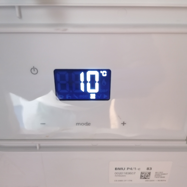

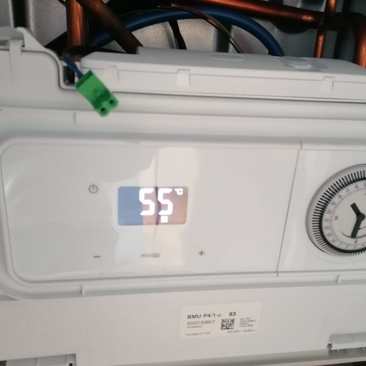

ok so in the first picture boiler output temperature was set ant 55 but over shooting to just over 70. ands in the second picture i have disconnected the receiver for the thermostat to reduce it down to 10. it would not let me reduce temperature while receiver was connected. i have a feeling i will have to increase it again but at least this is a starting point.
ok so after posting this i seen in the user guide that boiler output temp should be set to 30 so i have adjusted.
