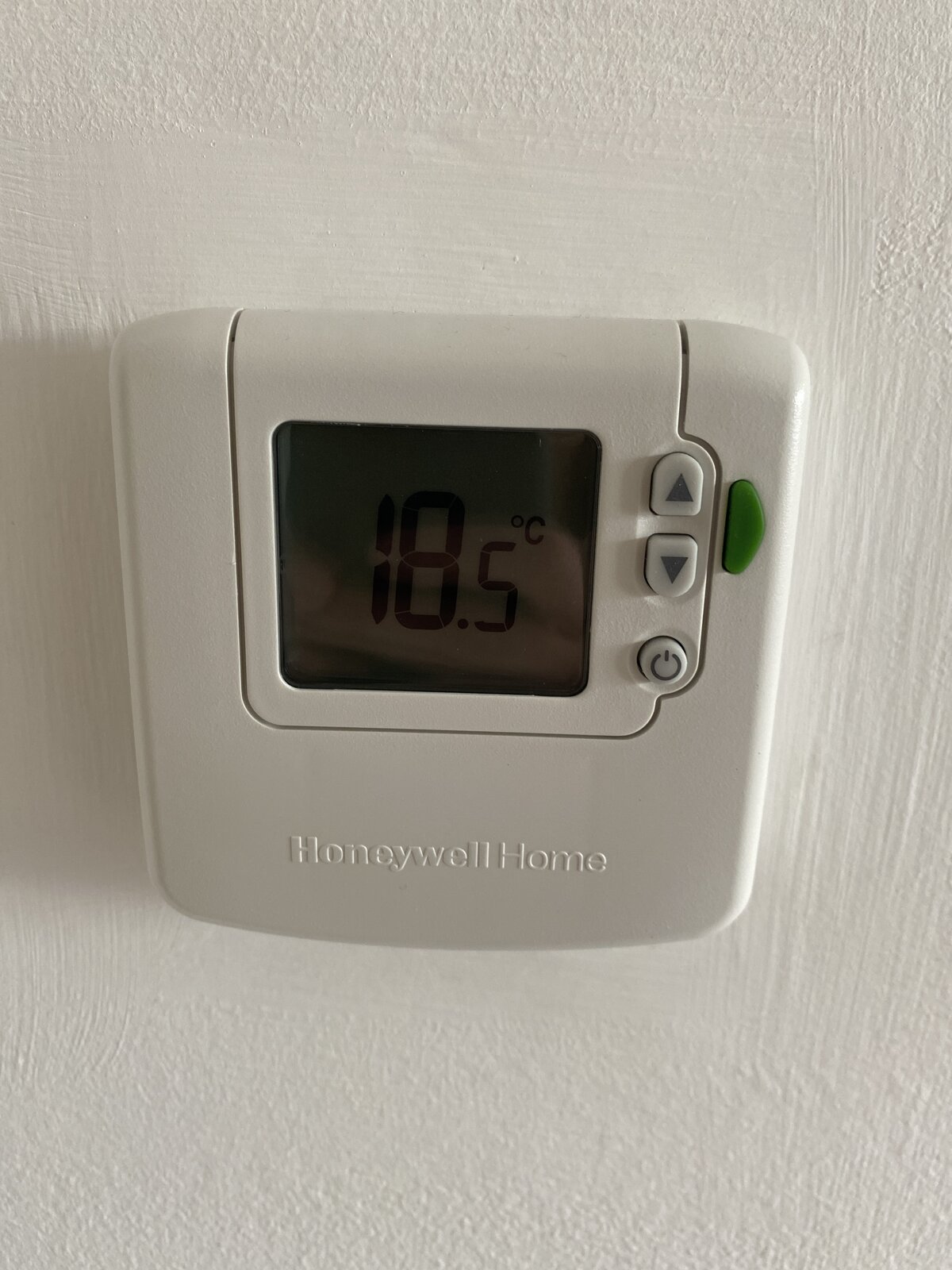

I run the CH via a thermostat. It’s set for 18.5 degrees and in the day it runs absolutely fine, if it drops below, the flame symbol comes on on the thermostat and the boiler fires up etc.
However at night I’ve noticed when ever I go downstairs between 12am-6am that the thermostat will be on say 16-17 degrees, and the flame symbol will be on the thermostat, however the boiler hasn’t kicked in and the Rads haven’t come on.

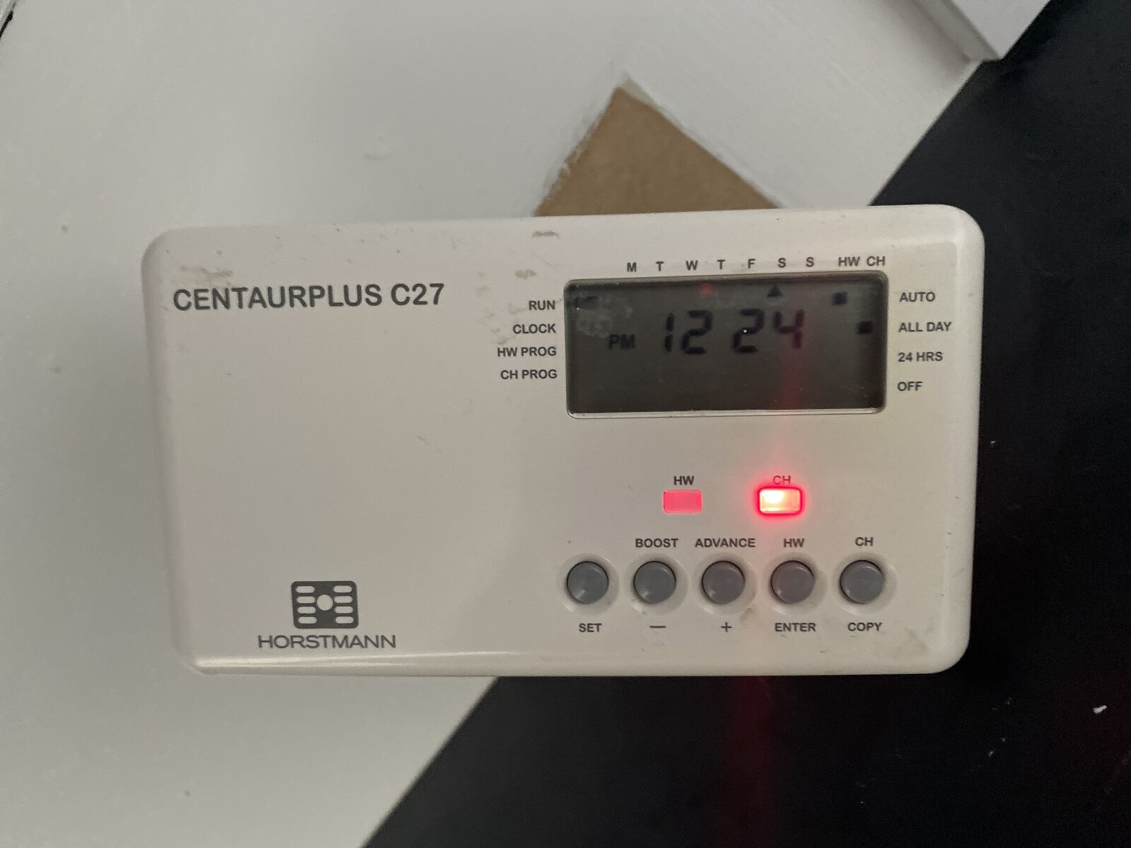

So my boiler programmer has 4 settings
ON - goes off the thermostat
Auto - Set Times and temperature
24 Hour - Stays On at set temp
OFF
I’m using ON, which connects to the wired thermostat. As mentioned, in the day it’s absolute fine, it’s just at night it won’t kick in, despite the thermostat having the flame symbol meaning it’s calling for heat.
they should all be controlled by the themostate
24hours will be on all the time with the thermostat controlling
can you post a picture of the controller
not sure what the difference between on and 24 is - do you set a temperature on the 24hr
So 24 hours keeps the hearing on at all times going off the temperature that the boiler is set to. It will literally just stay on the whole time.
ON will fire the boiler up going off the temperature of the thermostat. So if it drops below the thermostat temp it will fire up the heating

What model of thermostat do you have?

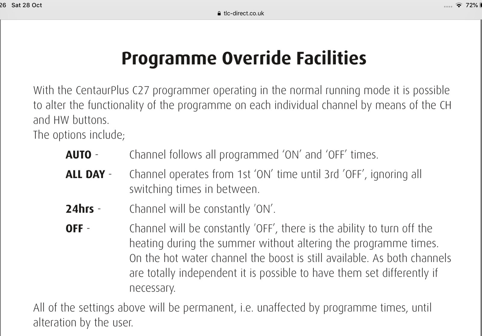

You don’t have it set to “on”, as there isn’t one. You have it on all day, which as per instructions operates from 1st on until 3rd off. Info you want it on constantly and use the thermostat you need to set to 24 hours. The thermostat doesn’t override the programmer, it operates when the programmer requests heating.
Thanks for the reply, appreciate you trying to help. I believe auto operates from 1st on until 3rd off. All day, is done of the thermostat depending on when the temp drops, which is what is happening during the day I.e. if it drops below 18 it automatically kicks in, apart from at night. 24 Hours comes on all day to the temperature set on the boiler, not thermostat
That is incorrect, if you have a room thermostat, the boiler thermostat doesn’t control anything. 24 hours means it is set to constantly on, have a look at the attached screenshot
