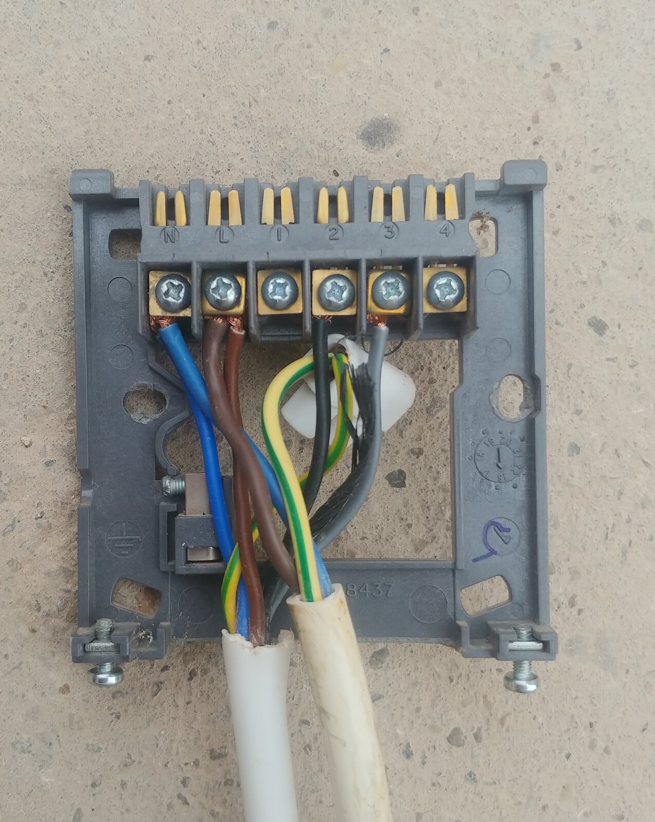

It used to work.
But the wire got tugged and pulled all the connectors out (except the grey one, that's still in the correct place).
I tried to wire it up again in the below pic but the hot water isn't coming on. How should I wire this thing up so it works?
The clean wire is the boiler, the dirty wire is from the wire with the fuse. Thanks.

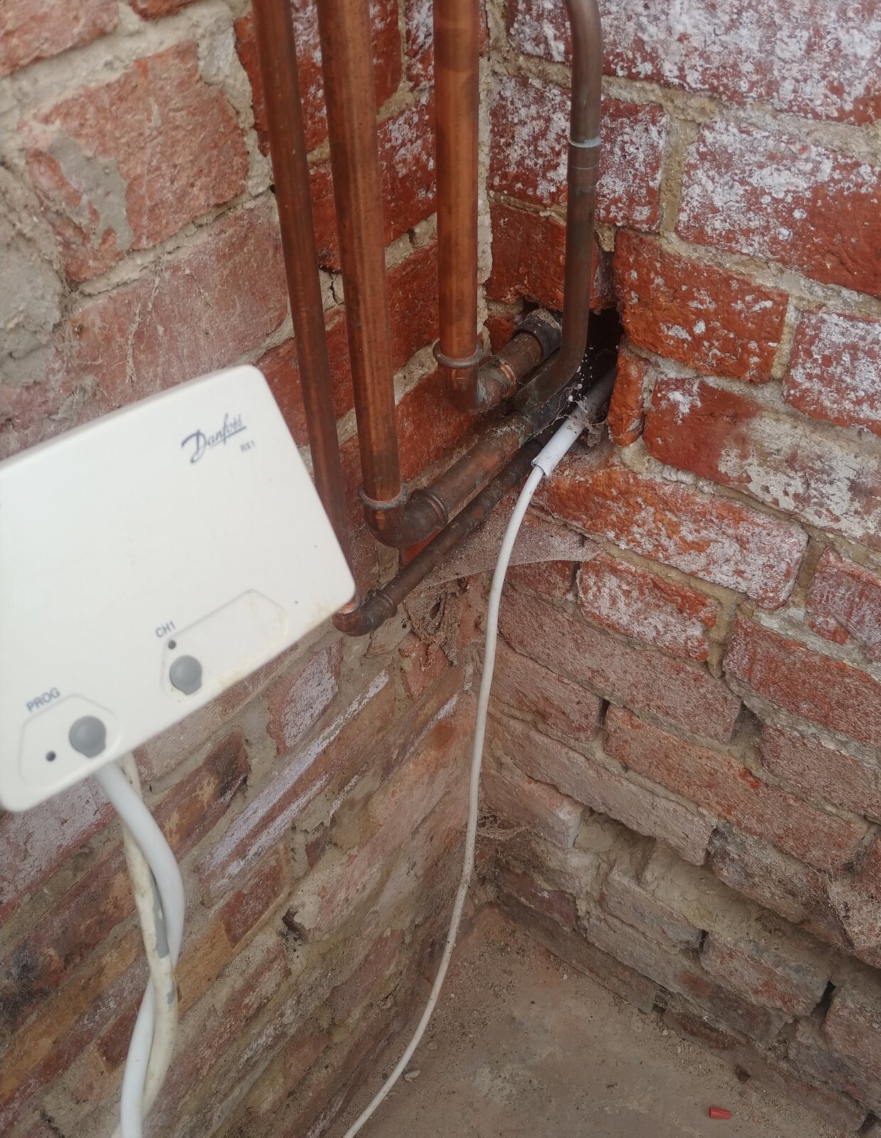

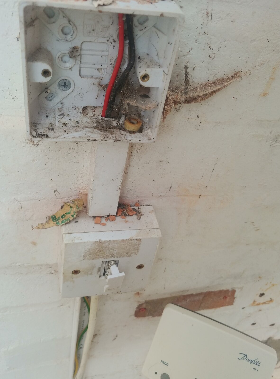

As already said post pics so we can see what is going on
wiring from house with fuse:
wiring from receiver going through the external wall into boiler
wiring on the receiver (still think this is wrong)

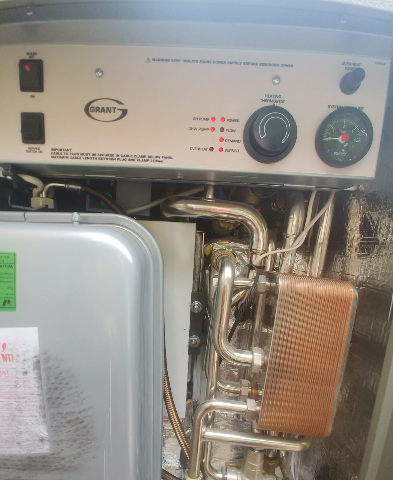

the boiler lights up

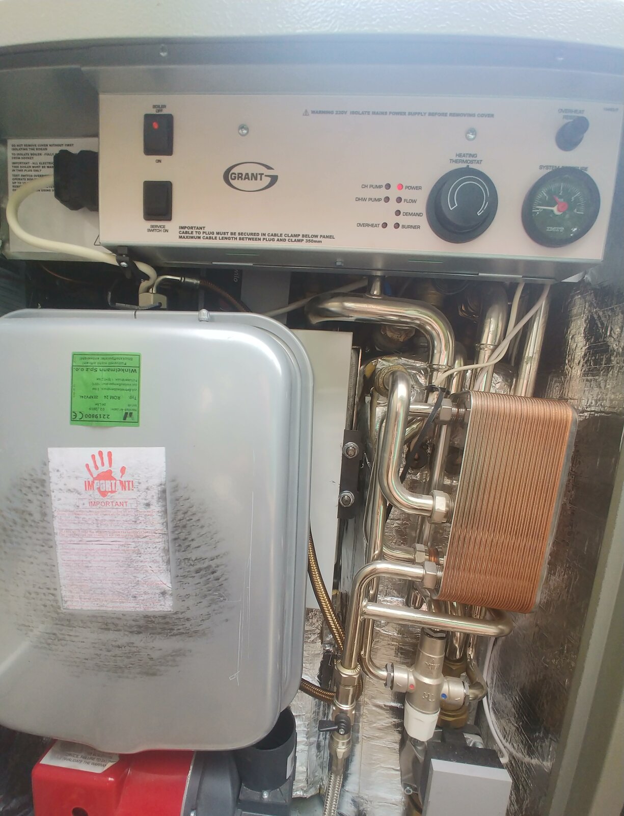

when I hit the test switch on the boiler it lights up like this and the boiler fires up, but still no hot water.
