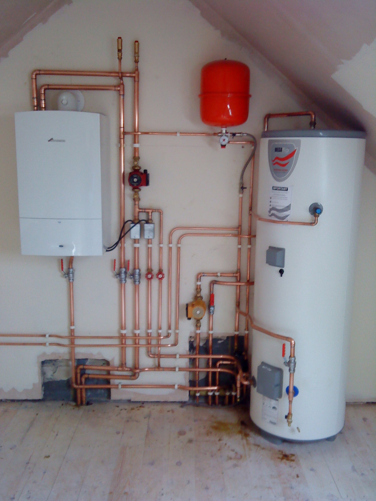

Thanks all, I hadn't considered the UC in the loft until she mentioned it. I was all for sticking it in the existing airing cupboard.
Then I saw this, which I thought looks neat.
I'm a fan of putting things out of the way, but equally, the loft is usually my server room with a fair bit of electrical goodness. So maybe a full UV being up there is not wise.
As an illustration it looks neat,consider that space could be habitable as an extra bedroom,etc.
The idea of putting a boiler/cylinder in a utility room with other utility machines (and add a wc) really appeals to house buyers. Create a small extension and keep the loft bare.
anyone wanting to convert a loft space which already a has boiler/cylinder has an added expense,yep w do the wet work for London loft converters and existing goods end up in the skip or gumtree :mrgreen:
