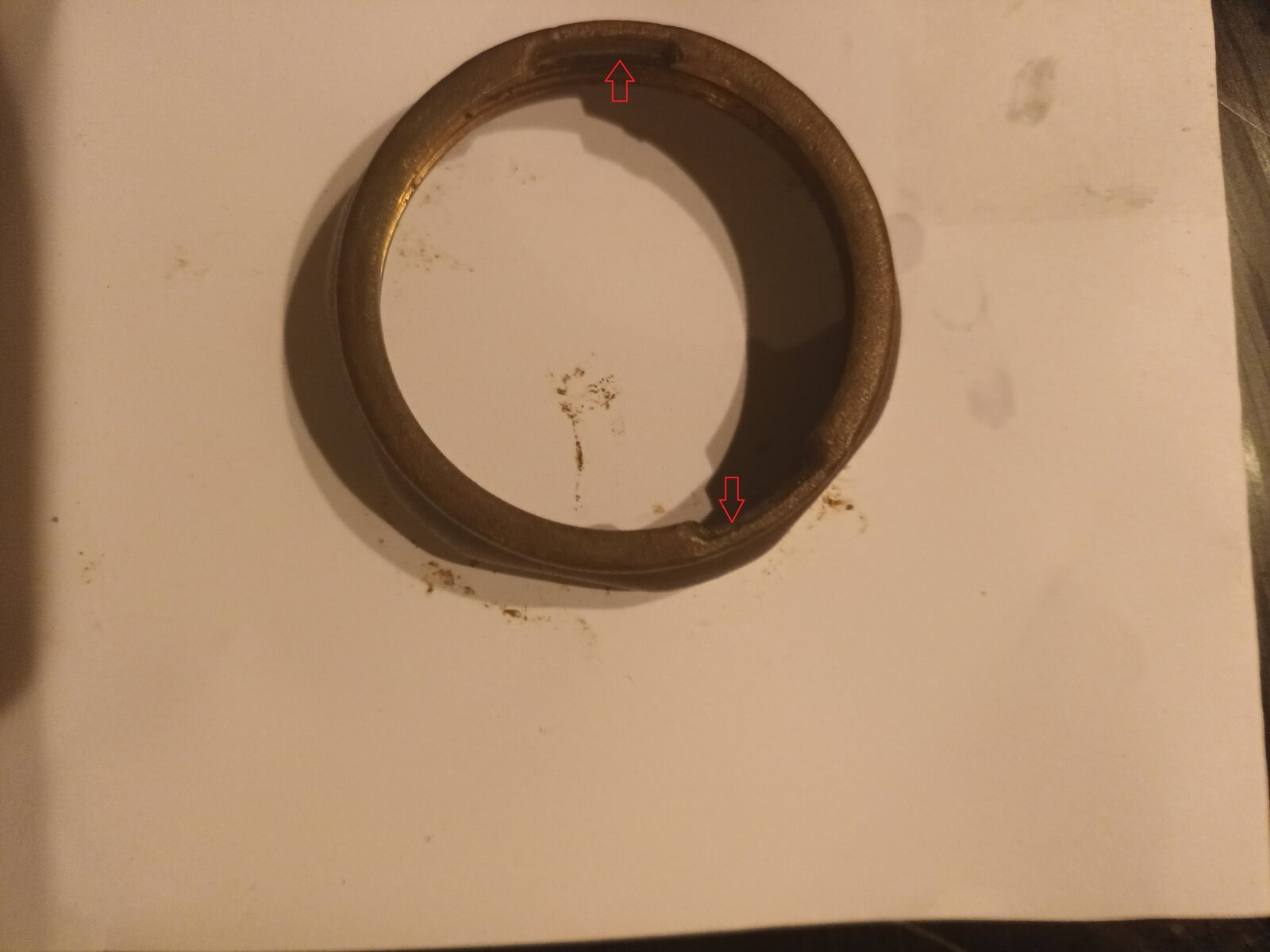

Re Pump selection, the third one on the right, in your link, the 25/1-6 at £113.28 is the one BUT I would bring the old pump with me as I'm not, but almost are, 100% sure that the threaded ends are the same, I measure 51mm across the nut flats on mine and 47/48MM across the pump threaded ends, its more than likely that your old pump is the same but safer to remove the old pump, it should be 130mm between the flanges.
When/if you do remove the pump cable from the wiring centre, ensure you note which terminals its connected to.
You can buy two nuts and cut off the old ones (see attachment) and slip on the new nuts without draining down the system and dont really need a special spanner, just ensure you have the new nuts before doing any cutting.
Also note the old pump setting, it will probably be on setting 2 or 3 and very important to note the direction the pump is pumping in, yhere is a arrow on the (all) pump casing.
