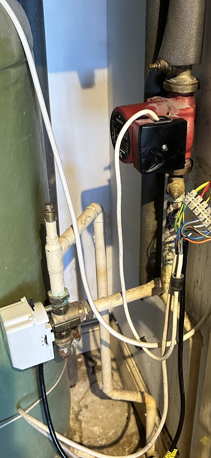

Show us pictures of the pipework,pump,valve/s around the hot water cylinder.
Photo here. (i am aware of the open wires its work in progress).

There should be a brass screw in the center of the pump (looks like a Grundfos Selectric) hold a cloth under the pump and remove the screw, you should then see if the pump shaft is turning.
There is a screw in the centre i used that to bleed it, it's not Brass. Is there a different one? There is also a speed switch on it and if i slow it down it makes a different noice, Hence why i think its working
The screw that you used to bleed the pump is silver coloured,as said above removing it will expose the shaft ,so you can see if it is rotating.
Above the motorised valve is a short stub of pipe with a venting screw ,release the screw to bleed air from the coil .
