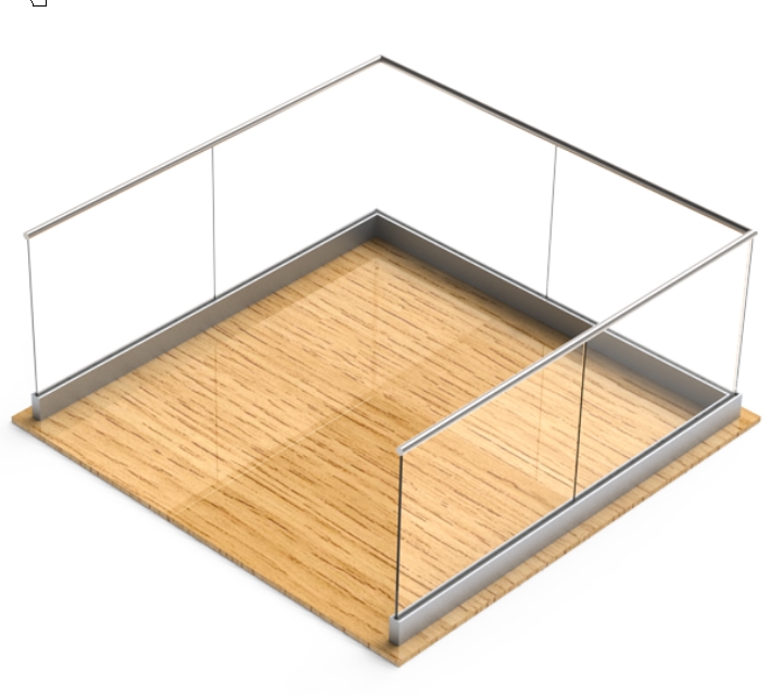

I would like to bolt down a railing base over a steel beam, and it requires 12mm bolts. Ideally I would drill a 12mm hole into the steel flange, then fix it with a 12mm bolt from the top and a nut from below. However I do not have easy (or any) access to the space inside the beam and so I cannot place the nut.

It is for a balustrade very similar to this picture. The bolts go into the base channel before you slot the glass in. Need to be super strong about 380kg horizontal force at 1m height and at every one metre.

Not clear from that image, why don't you have access to the underside of the flange (if that's what you're saying)? Screws are no good, otherwise there'd be no point fitting the ring beam.

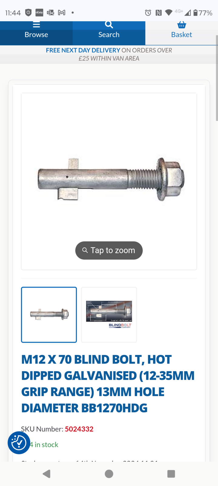

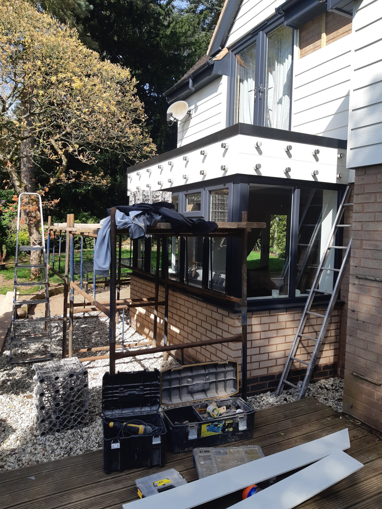

We had to prep our steel beams, prior to cladding or plaster boarding etc with steel studs, ready to accept the glass balcony....
Rivet nuts are used for blind fixing in situations such as this. However you need to be mindful of possible galvanic corrosion, and as mentioned, the fixing method needs to be designed not made up.
