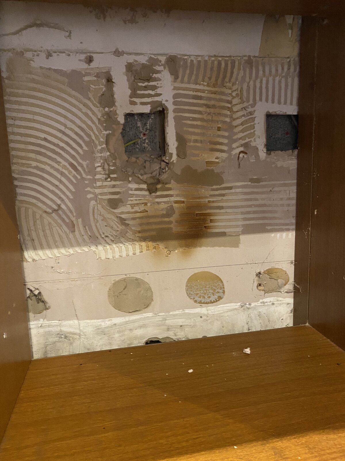

I’ve got a 25mm gap between the block work and the plasterboard.
For the oven can I use a pattress box with a cooker outlet? Pattress will be fixed to the block work but is there any problem with it sitting proud? I’m not going to go with an integrated socket outlet so it’ll just be the oven.

Don't see any problems with it sitting proud. Most of the old style cooker switches are fully proud.
Regulation wise there is nothing stopping you from sinking it part way in and part way out.
Why do you want to use a pattress box?
You said it was for the cooker outlet, but anyway -
25mm. gap plus plasterboard will be 35mm. Won't it?
And there is no regulation that states you need a "cooker" switch anyway so you could do away with it. But if you are keeping it why the concern about making a hole in the blockwork to accept a metal back box?? I would use a 47mm box anyway. Bear in mind there are millions of houses with many millions of holes in brick and blockwork just with backboxes in them.
Yeah I’m still undecided on wether I’m going to put a switch/outlet in or just go with an outlet.
Sorry not been very clear, the gap between plasterboard face and block work total is 25mm. IMG_6606.jpeg
Don’t wanna have to chop the block about for 2 reasons really. First one I’m lazy, second one I’ve never managed to successfully chop a flat surface into this kind of block due to its material construction.

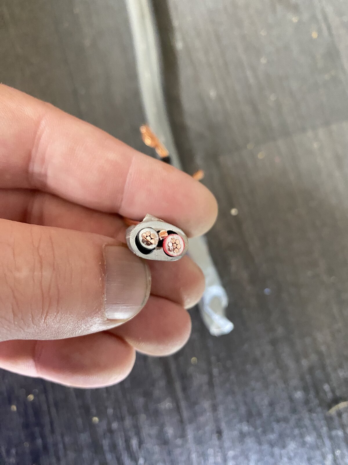

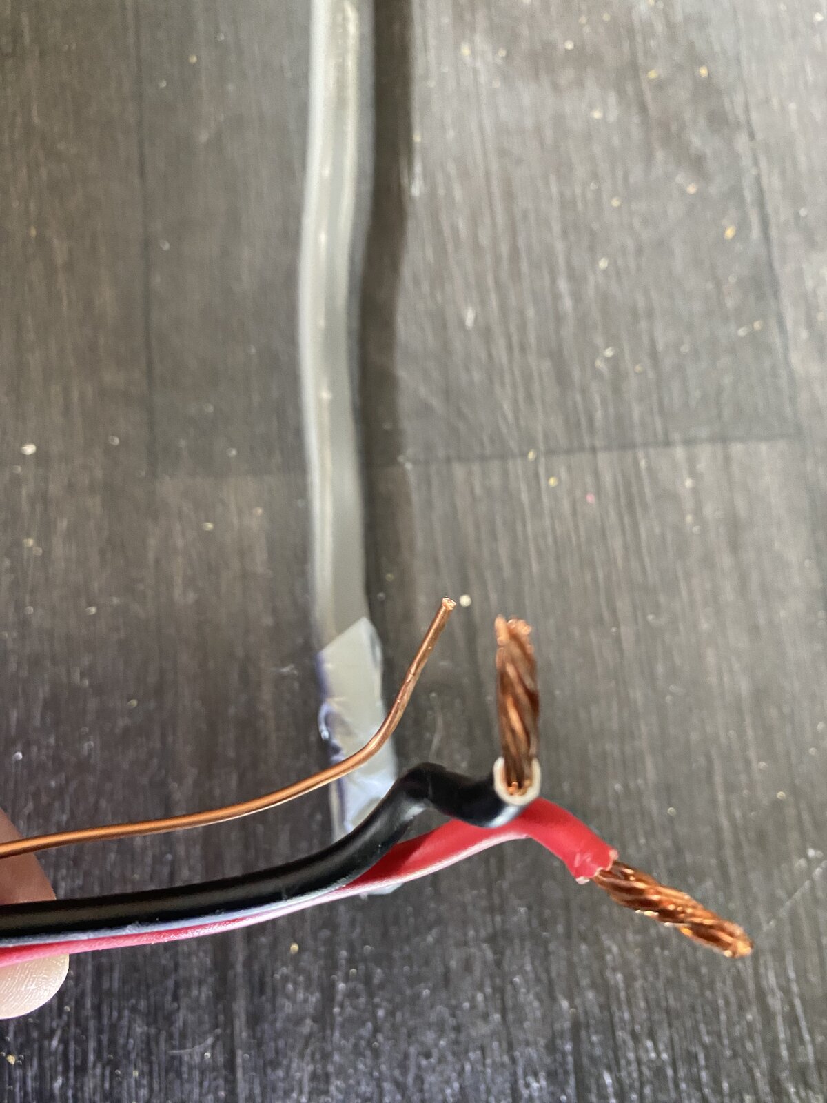

Another question. Do we think this is 4 or 6mm?
I’ve examined the cable and all I can find is delta crompton basec.
Cheers
Lee
I am not sure what the problem is, but -
There is no such thing as a switch/outlet. Cooker outlet plates do not have switches; they are just connectors.
Ok, so don't install something which needs a 35mm. back box.
Jjust have a 25mm. back box and a cooker outlet.
Not much point asking for correct advice, then.
Good grief. Then chop it unevenly and use some filler.

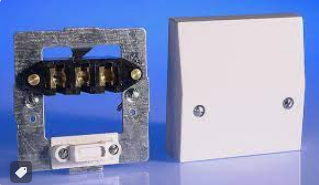

I’m not a fan of the plates you suggest as ramming and crushing the crap out of a pair of 4 or 6mm feeds into a single screw terminal doesn’t fit my ALARP expectations, same reason I won’t use junction boxes.
You do not have to ram and crush; terminate correctly.
Apart from that, there are dual outlet plates:
