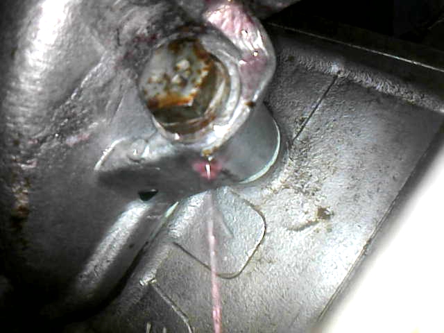

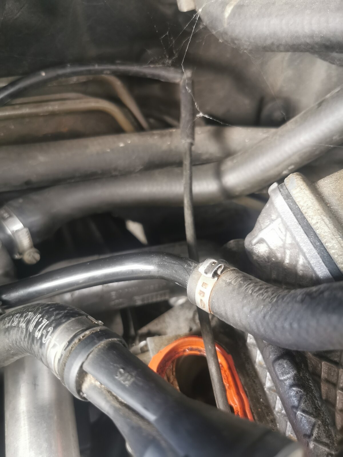

Further to the above, I used the scope today to look at a leak on my x5 that's between the bulk head and the cylinder head.
I poked the scope under the 2 hoses running left to right in the centre of the picture with it pointing towards the cylinder head on the right.
Those 2 pictures were taken with the app for the scope, as you can see it's a decent clear picture from the scope and I can clearly see the coolant is leaking from the bolts and not the gasket.
Camera diameter is 9mm, id have to check the focus another day but I'd of certainly been within 20mm for those pictures
