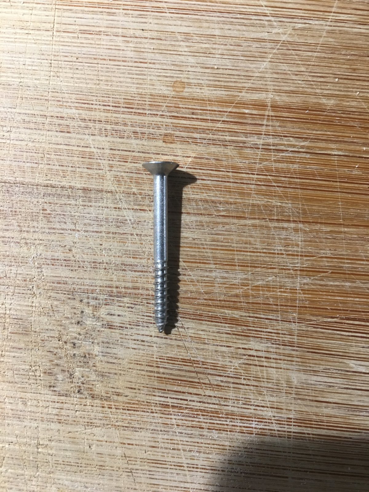

I recently had some repair work carried out on my oven under warrenty. The work involved removing the oven from the kitchen unit carcass in order to carry out the repair however when the engineer went to refit the oven one of the screws to secure the oven within the kitchen unit would not tighten.
In order to rectify the issue he replaced the screws with some with a thicker diameter and slightly longer however they looked nothing like the original ones supplied with the oven. I'm certainly not going to fiddle with it in anyway however I'm just a little concerned he has used the wrong type of screw.
The screws he used look very similar to the image attached. Do these even look like screws for wood?
Thanks in advance for any help or advice.

Yes they are traditional wood screws, if the unit is chipboard they are not ideal but they should work fine to just hold it back.
He should have stuck a few slivers of wood in the hole (or match sticks), and then used the original screw. As footprints has said, that's a wood screw, and should be a chipboard screw that has a thread all the way down the shank, but as the first part of the hole won't have any grip, it should be alright.

Do you think I should request they return to rectify with the correct screws or is it best to leave as it is now?
I dount if they'll return, but you could try asking them. But it's a simple diy job, and as there should be three other screws in the oven, it's not a major issue.

It's only secured with two screws in the top of the oven, both are with these replacement screws.
I was more worried about the screws being too thick for the diameter of the kitchen unit and coming through the sides of the unit but I presume that is extremely unlikely.
See if you can pick up some 50mm (or at least longer than the ones in there now) drywall screws from the range or somewhere similar, you should be able to pick up a pack of 10 for £1.

It's okay, I realised that. Drywall screws are black, and often used to hold ovens in. The one's they've used should be fine, so it's up to you if you want to replace them or not, but it's an easy things to do if you want to.
