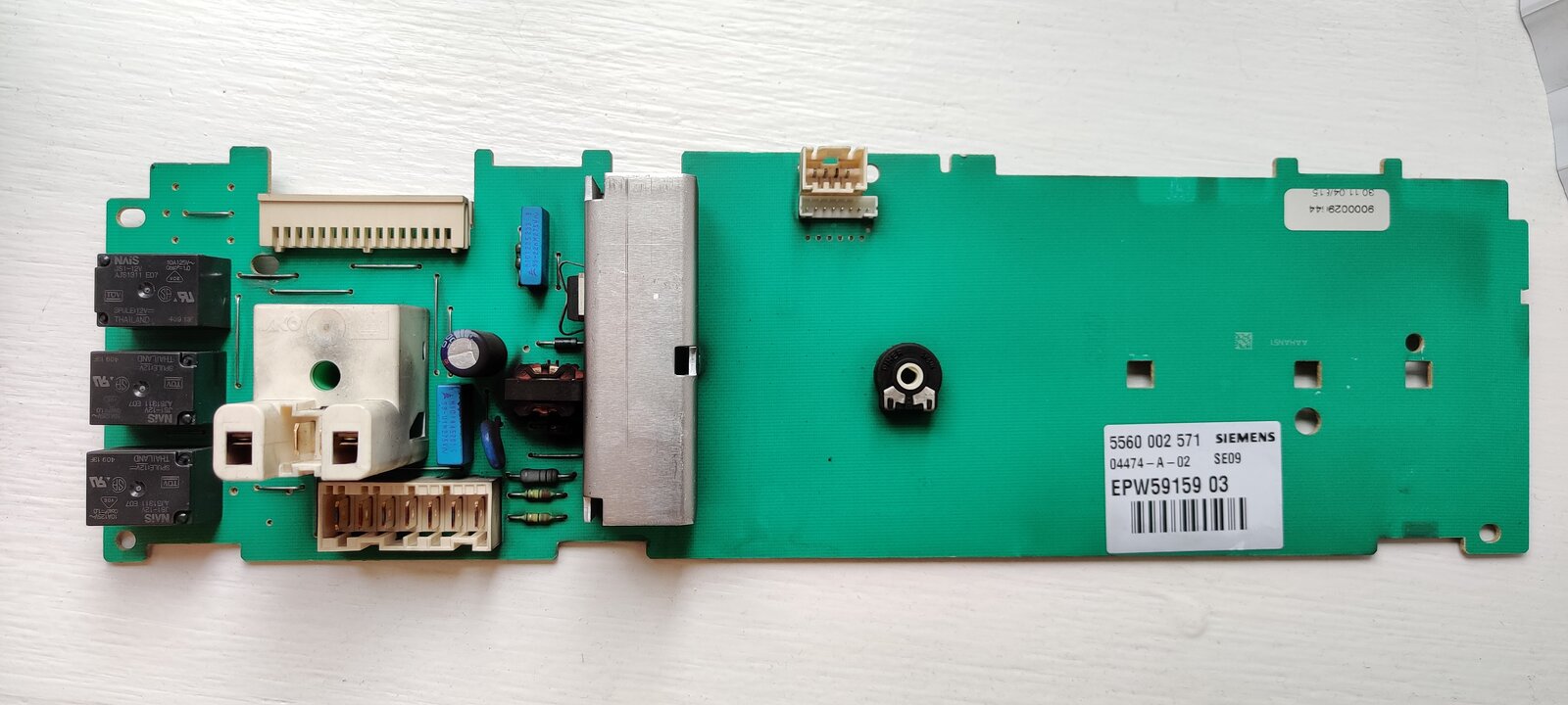

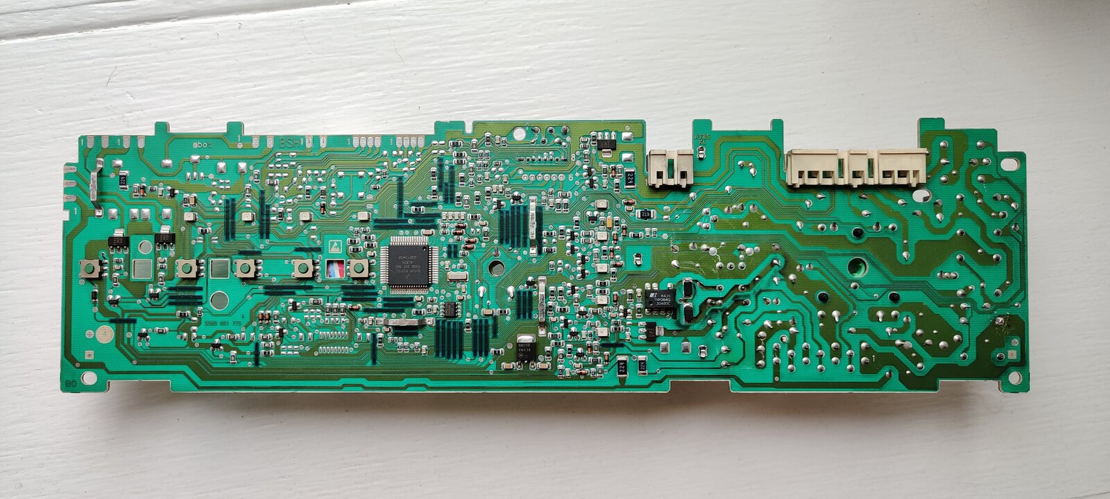

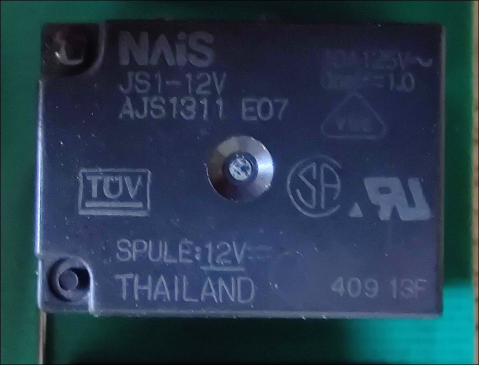

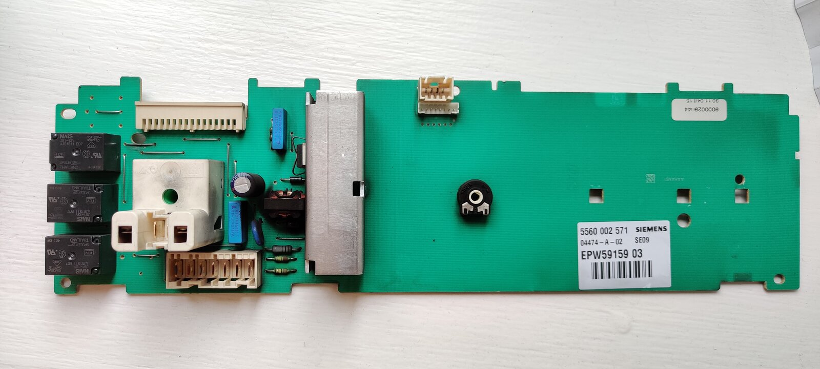

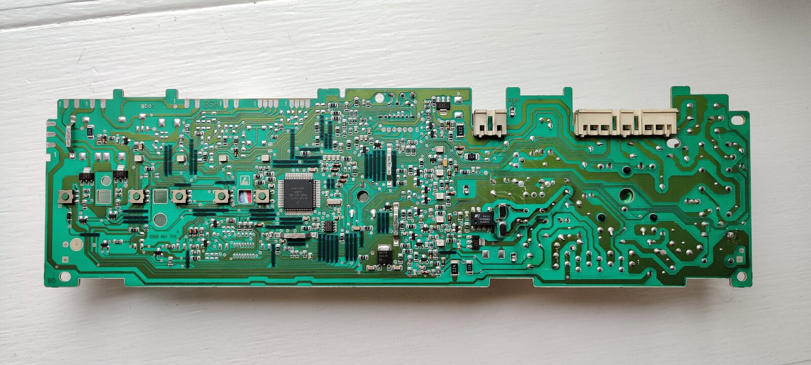

Hi all - thanks for the replies - the time has come to give this a go! Starting to cause problems again. Photos attached.

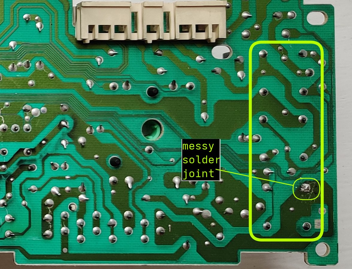

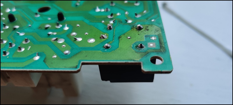

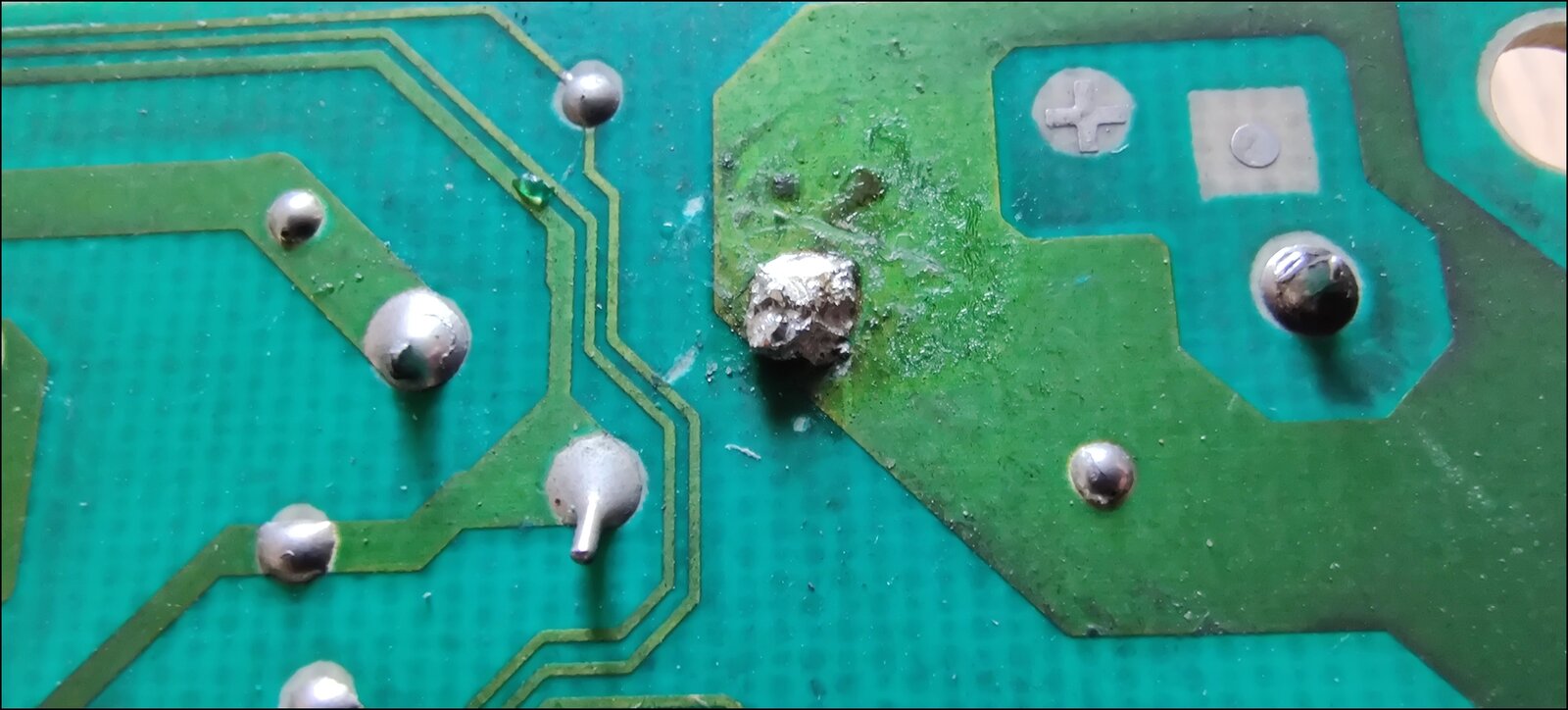

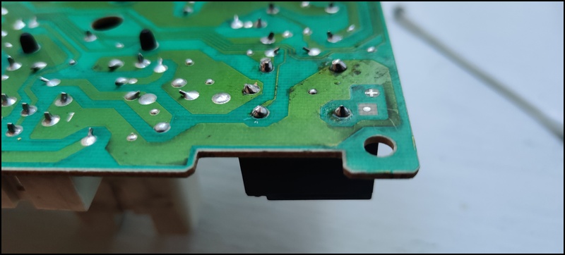

On the front side, there is a little black carbon-looking buildup (front.jpg). There's also a smudgy looking solder which might've been the repairman from a few years ago (front-solder-joint.jpg).

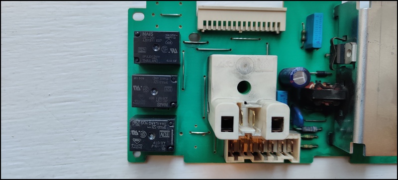

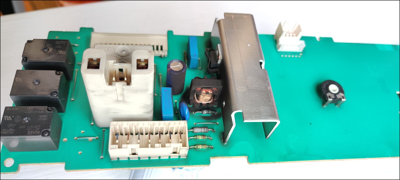

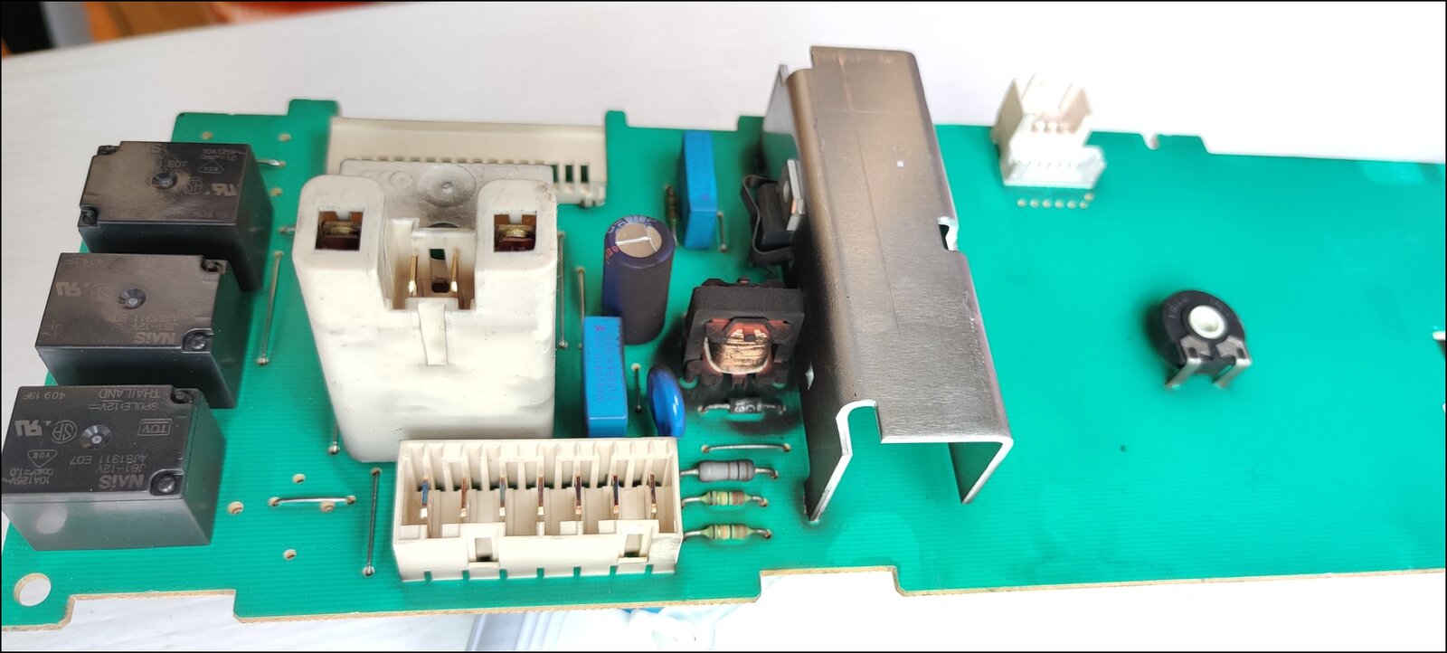

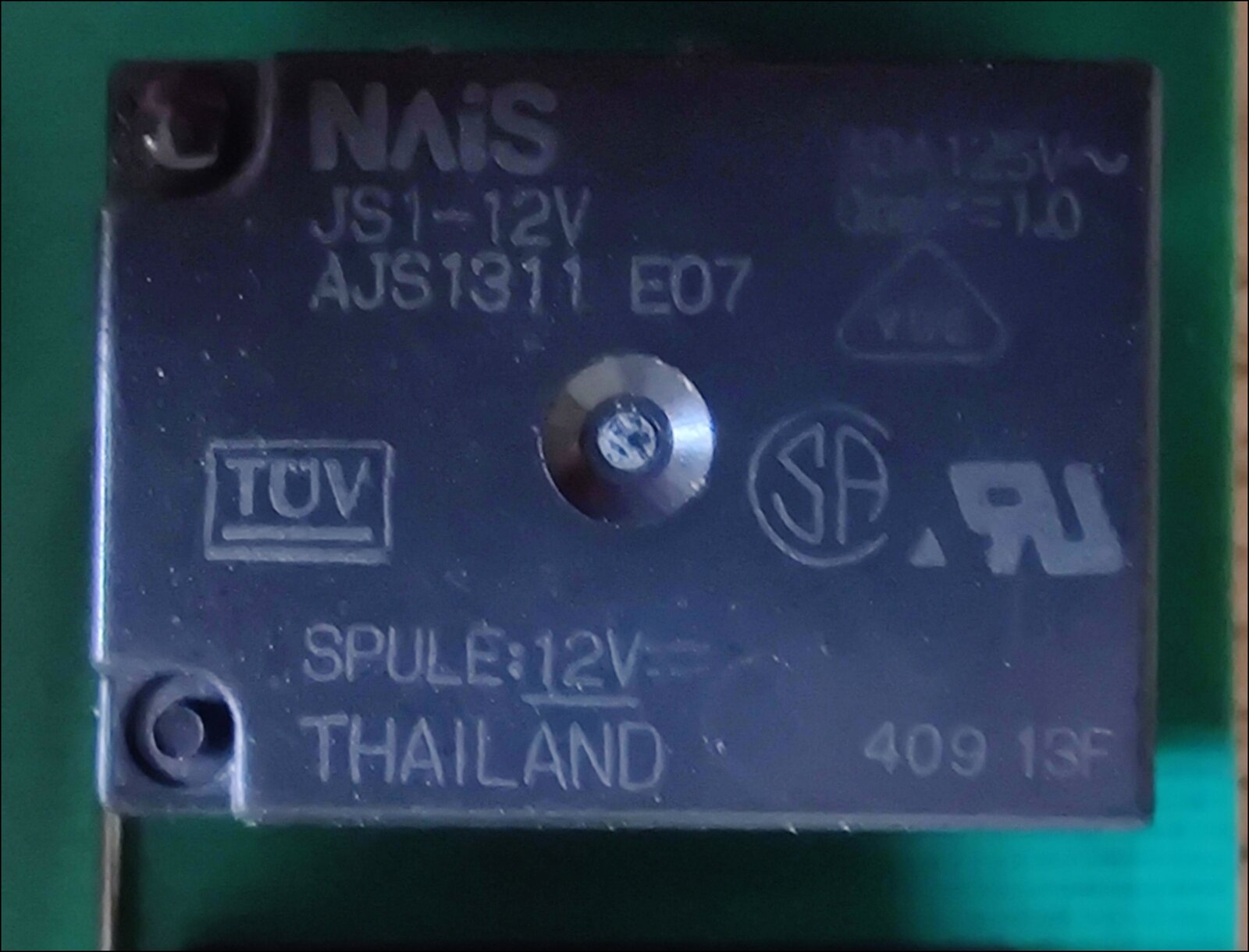

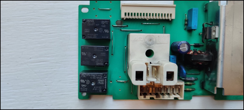

On the rear side (with the bigger components) you'll see 3 relays (back.jpg / relay-closeup.jpg) - I'm assuming one or more of these is for the water heater. There's also quite a lot of carbon-like build up a coil of some sort (see back-black.jpg)
The repairman said it was the heater relay which was failing. Not sure exactly how he diagnosed it - maybe the longer cycle times gave a clue.

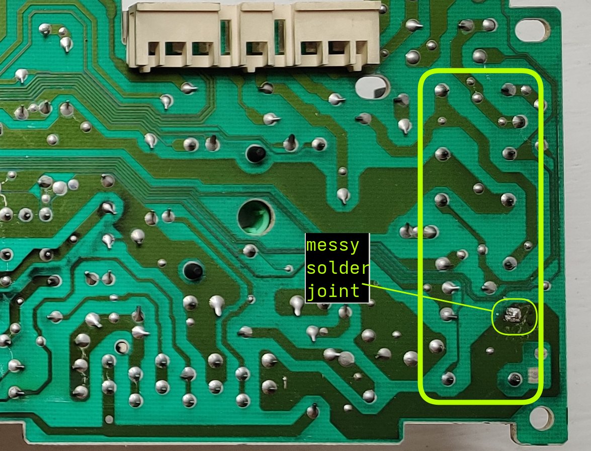

EDIT - added an annotated front image where the relays connect - front-relay-points.jpg.
EDIT 2 - Grok tells me JS1-12V and JS1-12V-F are very similar but the -F might be better/more resilient.

The F version just means that it has a slightly different coating on the contacts, while it may last slightly longer for what they cost I'd just replace it with whichever you can get.
Most of the distributers sell them however it's easier for a end user to buy the one from Ebay.
Although you could try redoing the solder on that bad joint first.
Also use a clean paintbrush to clean away all that black material on it else it could cause tracking between pins.
Then if it's still not working right you might look at replacing relays if that's the issue.
The one with the bad joint, given the width of the tracks is more than likely for the heater element.
Thanks for your help. The new relay (bottom relay in the second photo) is in! The machine is back together. Here's my soldering displayed for all to criticise:
And the good thing about my house is that if it doesn't work, I'll hear about it very soon ;-)
