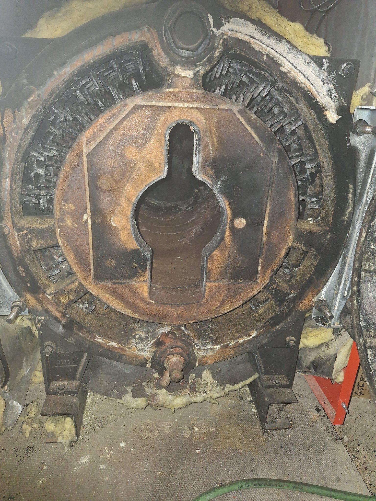

Hi. Servicing an old Boulters C2 /9or 8 pathfinder. The plate on the side suggest original set up for gas oil . The sticker on the burner suggest the same but has since been written over on pen 28sec.. Burner is an old Riello R40 G10. Written on the burner sticker is 170 psi . nozzle 1.5/60. Comb Head 3. Air 3.8 ..So not sure if that is settings for gas oil or kerosene. If the above settings are Kero would suggest about 1.95 usgallons/h

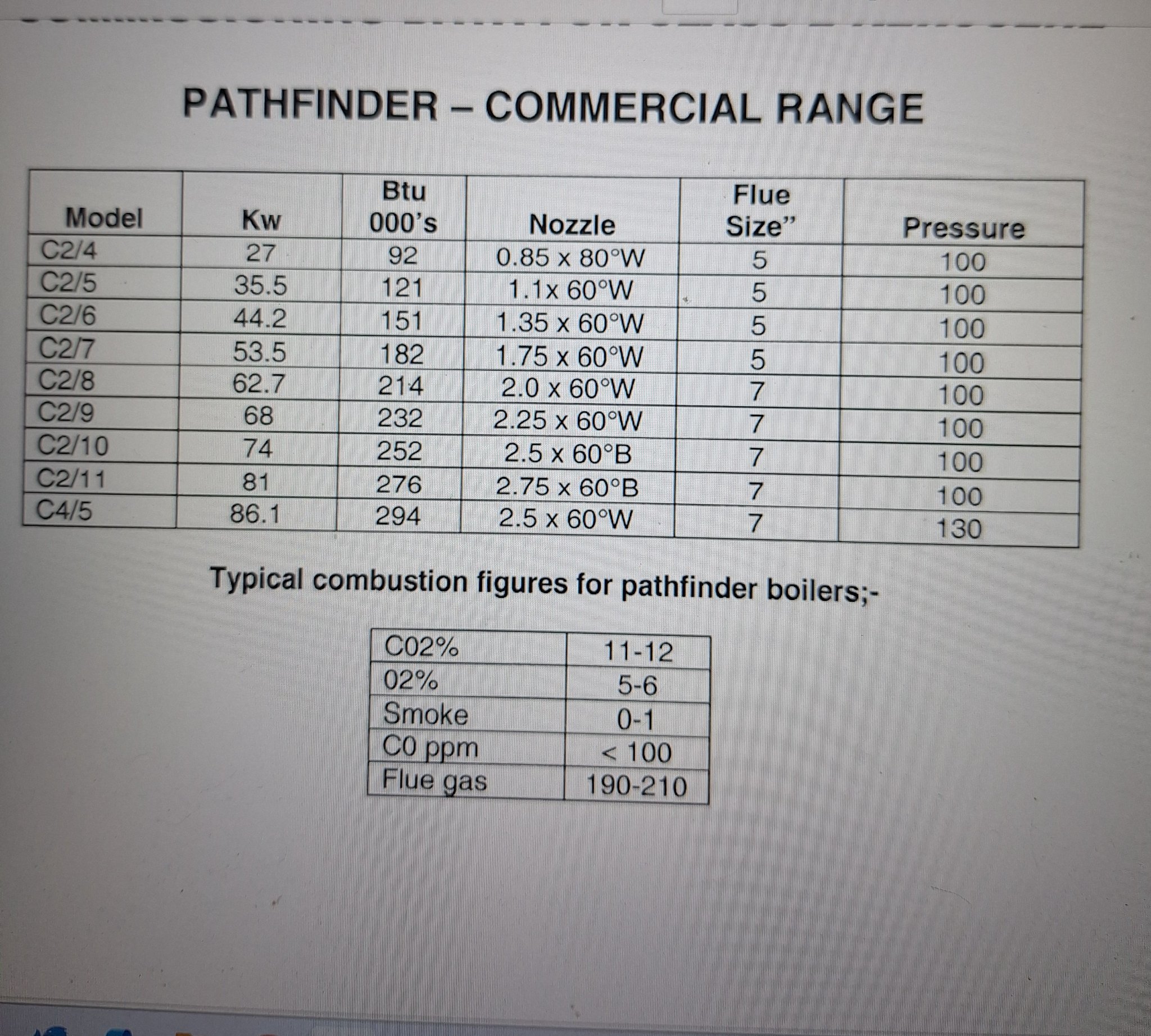

I have an old Boulters commissioning data sheet so I decided to take it back to that. Boiler has a 7inch flue . I fitted a 2.00 /60deg/ W at 100psi. data sheet does not give any head settings. Data from the Riello R40 G10 online manual suggest 2.5 head setting although @ 8 bar (116psi) . Left it at MI of 100psi . First test not great so adjusted air to 3.3 to get 0-1 smoke and then used analyser but the best I could get was 10.3% C02 and C0 @68ppm if I tried less air to bring Co2 up the Co. ppm would start to climb up to 80'.s..
I then tried to set it up at Riello burner MI for that nozzle which was 8 bar (116psi) combustion head set at 2.5 air about 3.3 but even more smoke..
I then settled back at Boulters settings of 100psi , head setting 2. air about 3.2 which gave me the 10.3Co2 and co 67ppm 02 -6.9 flue temp 265deg.
I feel I am missing something . Seems like Im over airing to keep co2 down...? or am I missing something. ?
I am going back any anyway to finish cleaning . Took a 1/2 bucket and 2 hover bags soot / carbon out the chamber. There is a bit of hard carbon stuck at the back Im wanting to get out.. Thought I might try Expell C to loosen off ..Any experience of this ? Ive used Duel X carbon breaker liquid in the past.

I used to service one of these, on 28 sec oil. From memory CO2 was always 11%-12% and CO approx 50-70ppm.
the M.I.'s specified <100.
I used to set pump at 140 but can't remember head setting. If you set to about 2-3 and adjust air to eliminate smoke, using the analyser you can alter the diffuser whilst it is running to optimise setting.

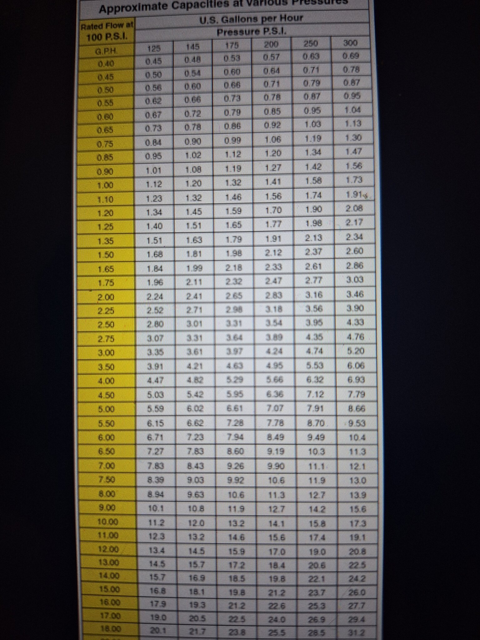

Do you know what output you are setting to? If so if you settle on 140 psi, you can calculate your nozzle size to suit.
Ive estimated the previous output was about about 61Kw using 1.95 usg/hr.
If Adjusting the diffuser to fine tune the settings what should I be expecting if I adjust it up and down.
With the diffuser in a mid position and the air setting with 0-1 smoke you should have CO2 at somewhere round 11%. , a small adjustment to increase will probably increase CO anda reduction will decrease it, but if CO2 rises too far, you need to increase the air setting. It is a patience testing exercise, but imagine how it woud have been with a 'wet' testing kit rather than an FGA.
So if I used the charts attached .. If the 62.7kw (214000btu) Im trying to get to would equal approx 2.00usg at 100psi would be the same as using a 1.65 nozzle at 145psi?

In terms of volume yes, but i'm unsure of the full effect of higher fuel pressure of almost 50% .
Your first tests were not so far away from the M.I's and suggest that the head setting is a little too open to reduce the CO, but even then your results are within the "less than 100 PPM". i've always thought that these big commercials fly in the face of the good results we see from domestic/light commercial , but if that is how they are designed, that is how they need to be set.
Maybe the flueways are not as clear as you think and the passes are a little obstructed.
